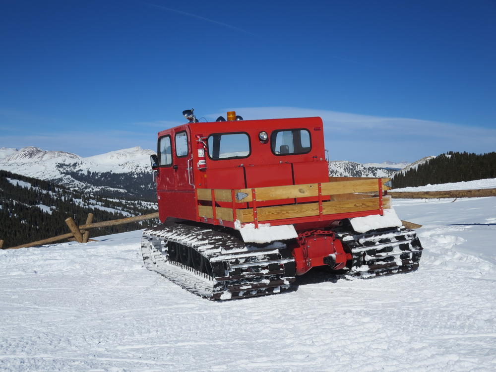

Thiokol paint code
ford 1965 poppy red ('69 calypso coral) seems pretty close to the original color. I used TCP global single stage urethane on top of self etching primer after stripping the old paint off. Next time I will upgrade to PPG over their restoration shop paint because I think it will hold it's shine longer.
