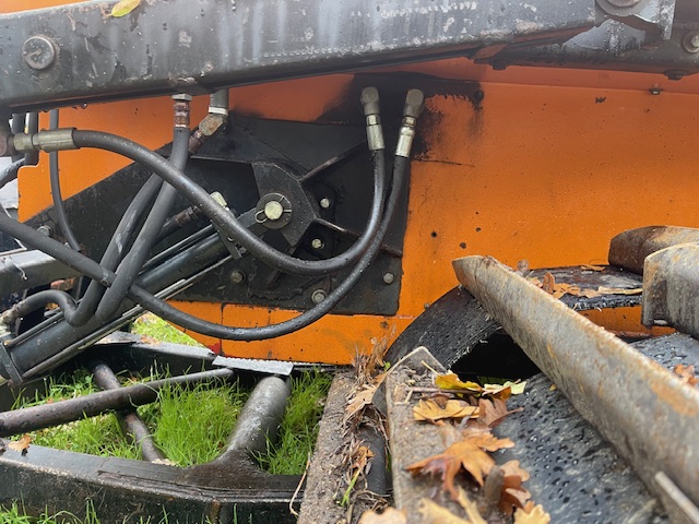

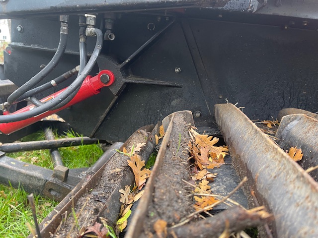

Wow, great information. I noticed one of the units has a smaller bracket that bolts to the side of the front for mounting the hydraulic ram to lift the blade (photos attached). One may have been made for a larger heavier blade system. Two have a 6-way blade (up/down, front tilt, side tilt). One without a blade has a blade mounting frame that had an angle function. I may look at the valve boxes and adapt something that will make it an 8-way blade. The 3700C has a 12-way blade. I just found out that a 3700D has a Detroit engine. So I think the A and B had AC engines, the C had a Cat 3208, and the D had an 8 cylinder Detroit engine of some kind. Also, one is orange and one is red and black. Did they change their color scheme?

The ones we had at the ski area were red and black mid 70's early 80's machines. we had valley engineering blades made in Maine 6 way and 8 way, never had any with thiokol blades attached. My 2100 has a thiokol 6 way blade on it.Don
I have two, and I don't know where they came from, but they would be 6 way. Up and down, tilt (corners up and down), then one that changes the angle of the blade cut to the ground. However, I have another one that has an angle option for spoiling snow off to the side like a road grader. I may try to figure out how to convert it into an 8 way blade, by adding a pivot and an additional ram. Then just need to figure out which valve will operate it. Could be a fun project. Both of the running cats have hydraulic valve handles behind the main handle control. Actually one has three handles there. I assume they ran something off of the back. I will need to see where the hydraulic hoses go. Right now I am replacing wheels/tires/bearing for a few of the bad tire wheels. Cutting off the old foam filled tires is a pain. So far I am trying a saws-all and a boxcutter to remove them. A place in Reno will mount and fill new tires for me. Just enough of a project to keep me busy for awhile.

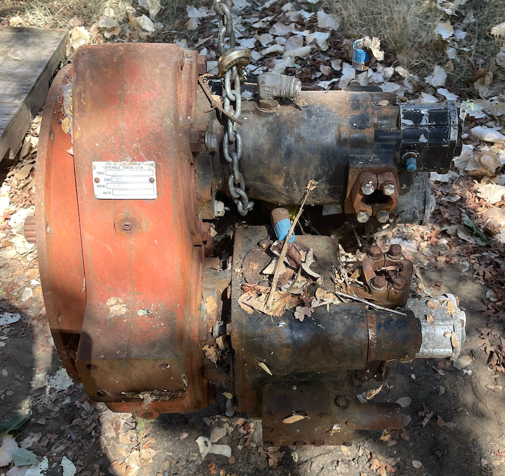

I just noticed my spare Funk gear box. It has two motors attached, but it does have a space for a third motor. One of the other Thiokols only has a Funk with two motors and doesn't have a third motor option. Also, one has some electric over hydraulic stuff in the back, which must have been for a tiller. Thanks for the info.

Your Funk Gear Box has spots for 3 pumps, 1 pump for each of your left and right drive motors the spare spot is for your tiller pump. That way you don't loose hydraulic capability when your tiller is running.

Yep, and with a diverter valve, I could use it for other hydraulic related equipment. Just need to know the flow rates and pressure requirements, etc., of the pumps and equipment I might want to hook up. Also, might need to know how much horsepower gets pulled away from the drive motors if I need to operate them at the same time. Who knows, maybe I'll hook up a wood splitter and split wood in the snow. Lol. I was watching some Canada or Alaska survival channel and they do their wood gathering in the winter. They can skid logs in over the snow and avoid getting dirt in the bark.
