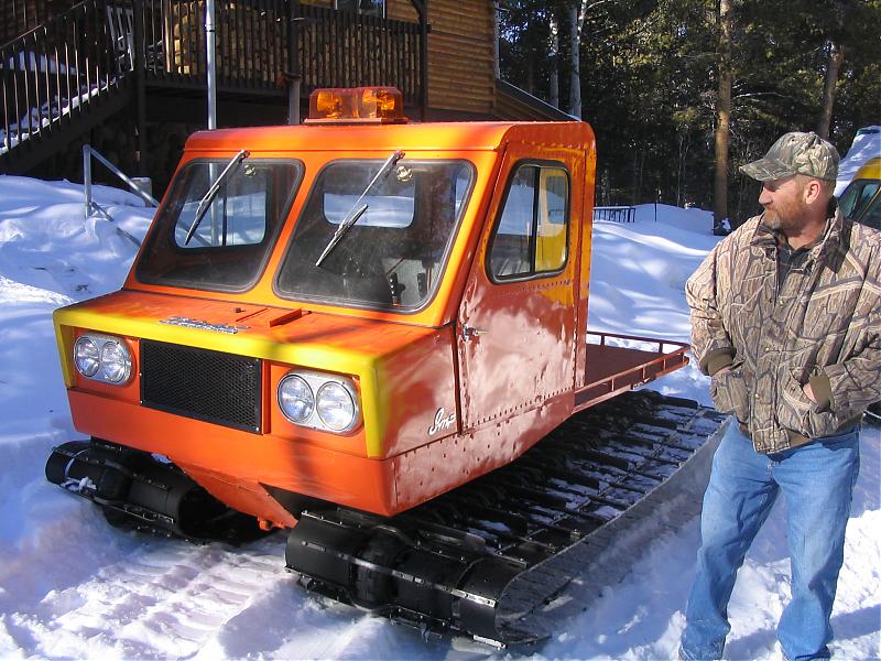

I need a little help here. I purchased a Super Imp and want to modify the tracks. I want to add 6" onto each side outer edge. I will make up some new grousers to span the diffrence (every other one). My question is can this be done without adverse effects? I will keep the suspension stock. Thanks for any help. And yes I got smoken deal on it as usual.
Pics
1980 Thiokol Super Imp
240 original hours!
tracks and grousers are in new like condition.
cab has been insulated but I will redo that.
Paint is faded but I will make it look all nice and shiney again!

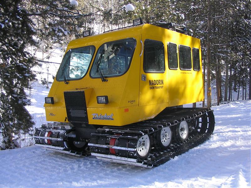

When I first got my Imp 1402 it had the 24" tracks. I talked to Peterson's about widening it and they said that they had done it to a few of them with good success. I used their drawings and added 6" to each track, taking them to 30" wide. It worked fine for me, then I noticed that the axles had been widened a little prior to my ownership. So I decided to add 3" to the inside belt too. This took it to 33" overall. It performed great in very deep snow with only a 3" asymmetrical. (These tracks are now on my friend's 1404 Imp and work very well.)
I really wanted to try the torsion axles to improve the ride and change the geometry that had been changed from the original design. The plan was to also make a strait grouser track to fit the slightly longer setup that I was planning to install. When I made the tracks for the torsion axle conversion, I went to an asymmetrical design that was about 37" wide. Feeling bigger is always better! :boobies: However, the new grouser was far more aggressive than the original drop center type and worked the rearend quit hard on hardpacked snow. :4_11_9: If it had the OC12 in it, I would have stayed with it. With the additional 8" of length, I could cut down the extra 6" to 31" and still have more area then the standard 32" wide track. I now have a 31" symmetrical track on my 1402 that performs very well in deep powder and on hard pack. :thumb:
This is the history of the several tracks that have been run on my 1404. I would talk to Steve at Peterson's to see what he tried on the Super Imp when he was on the design and test team. I think a Super Imp with 36" tracks would be sweet. I also would like to run torsion axles under it just like the LMC 1500. Really sweet!:thumb:
