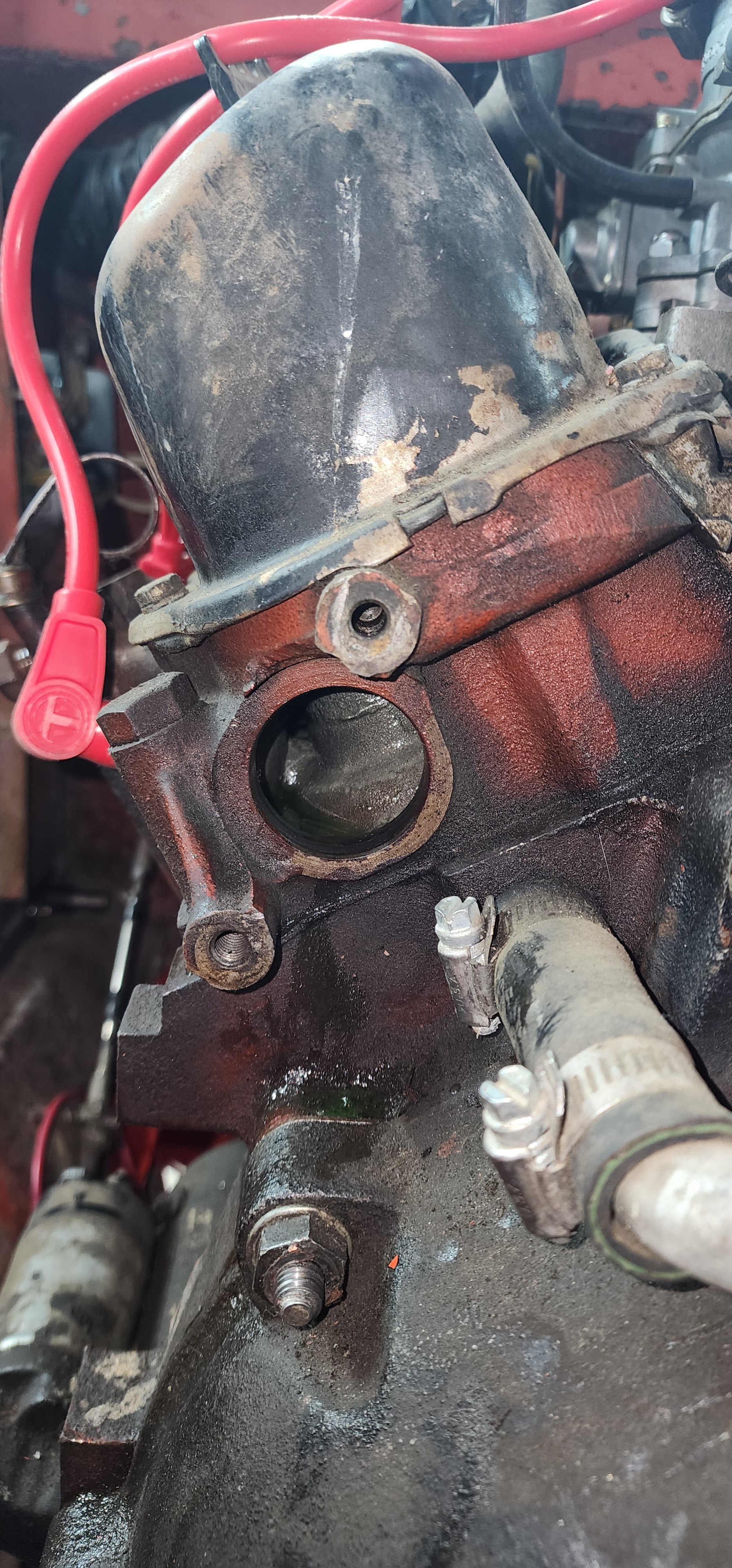

I’ve been stuck in the same rabbit hole as well, I’d love to find one for my 1404 v-4. I’ll reach out to Dan Gates, Snowcat Service in Salt Lake. He may know. I do know they run a 1.5” or 38mm freeze plug. I may roll the dice and purchase/install a 38mm with hook end on it. Maybe it will fit? I dunno. Someone out there has the answer.

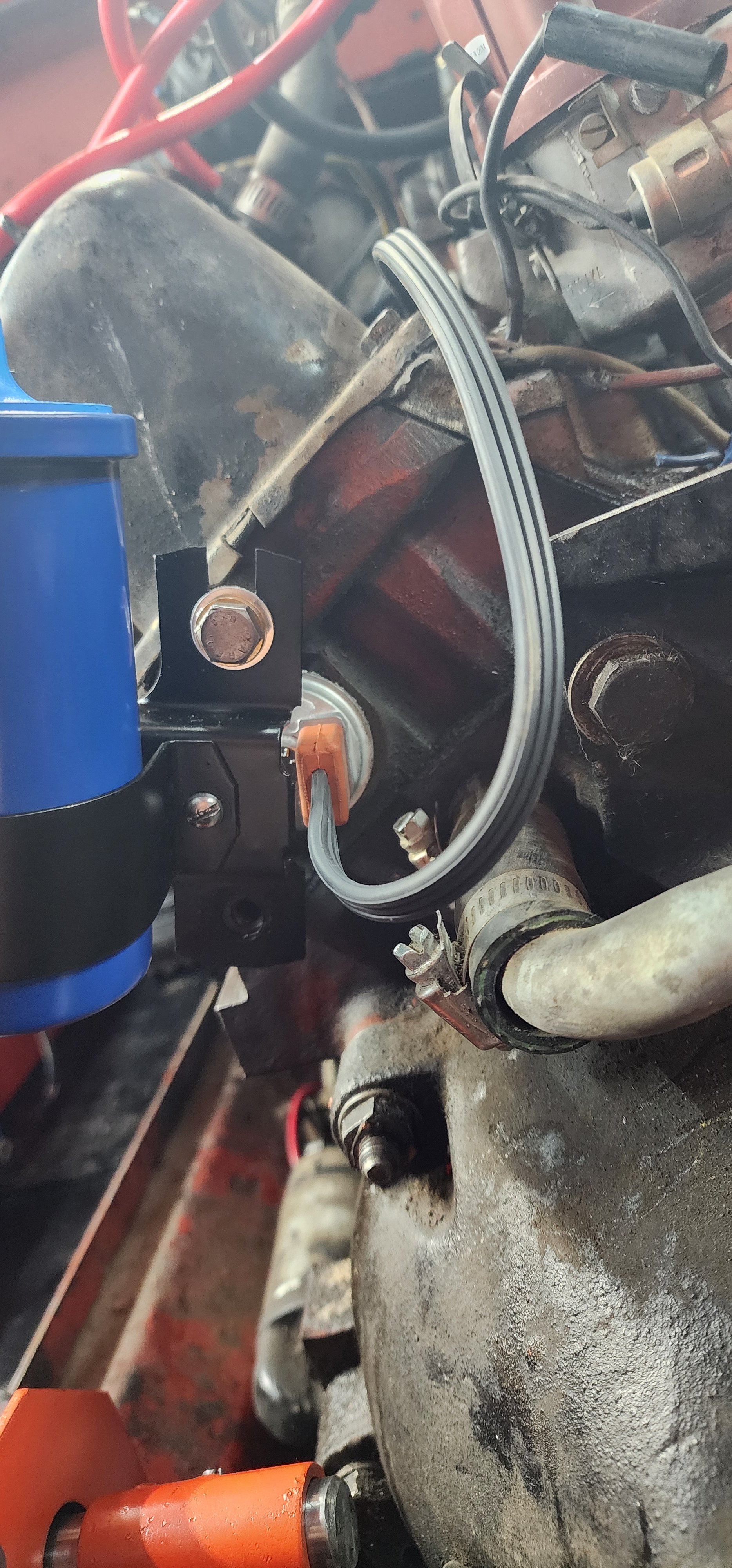

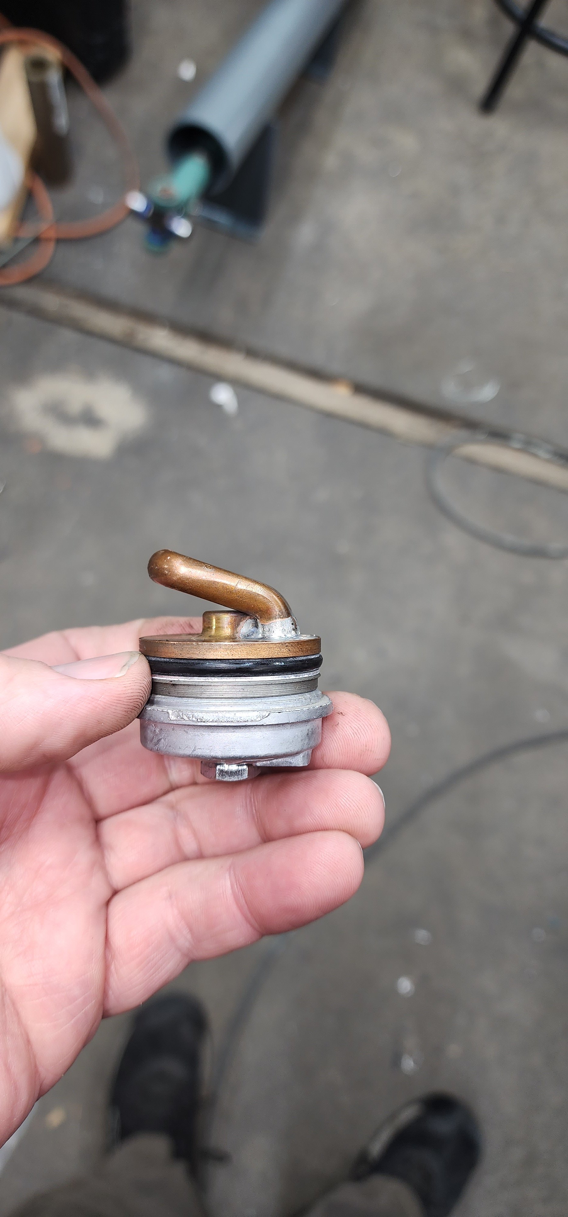

Hi All, thanks for looking into it. I was finally able to find one. Brand is Zerostart #310-0036
Once it gets here I will update with fitment.

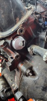

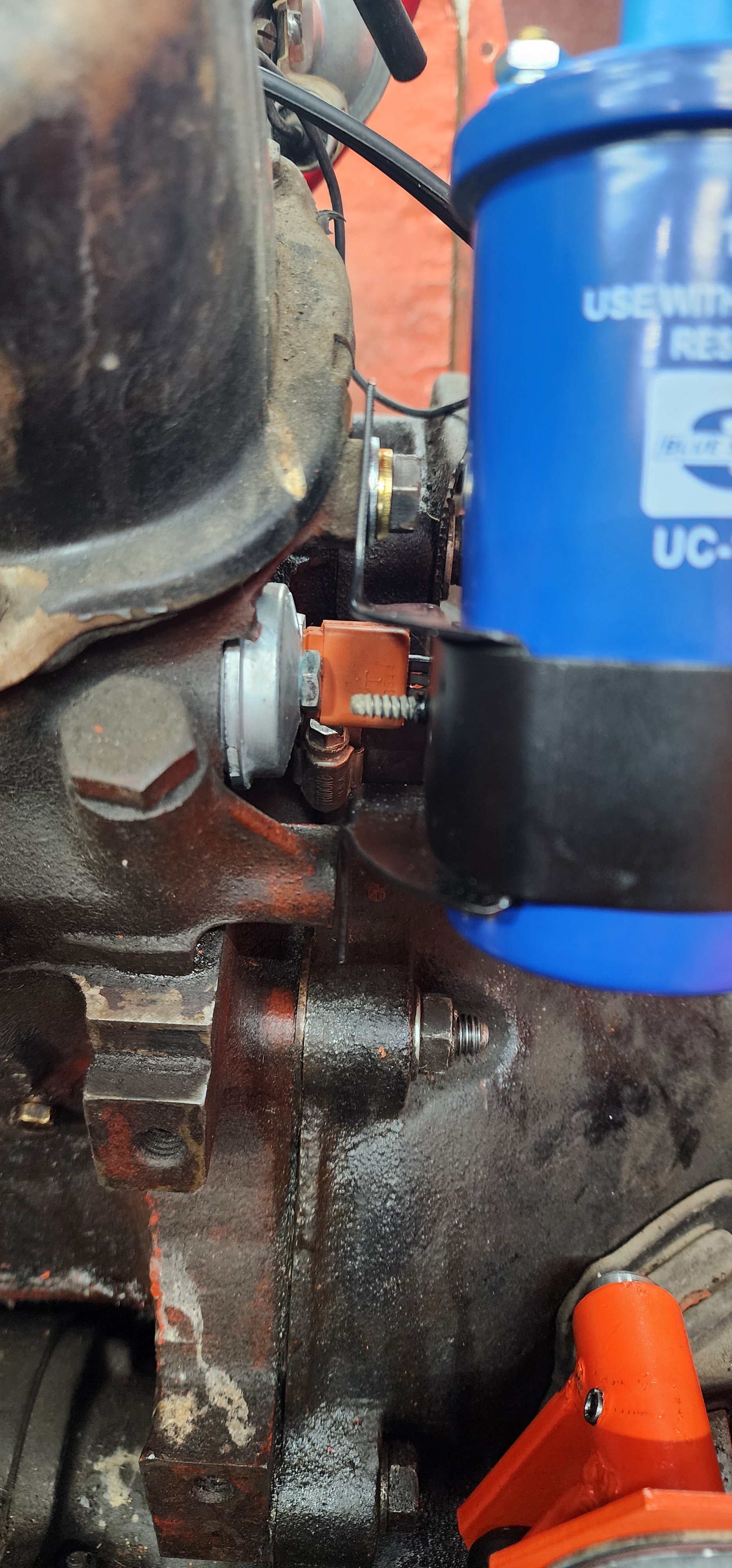

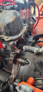

Hi All. I had a chance today to install the block heater. It went in the rear of the drivers side head, with the electrode pointed roughly in the 9 o'clock position. The bracket for the coil just barley clears it. Once I get some coolant back in it, I will plug it in and see how it does.
