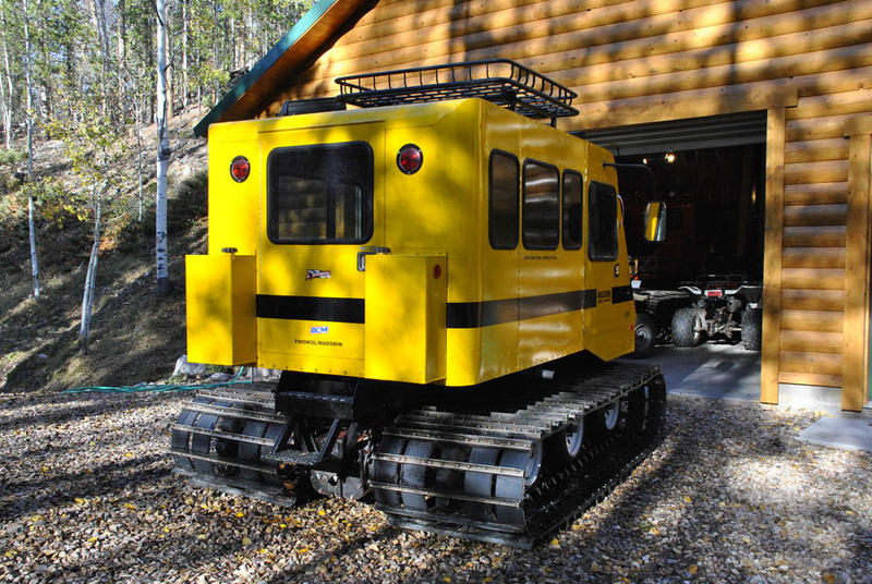

It has a Ford 2.0 liter (Pinto) engine with a C-3 Automatic transmission. The differential is an OC-4, which was relocated aft and down about 6" for the new track geometry. Torsion axles replaced the leaf springs with new custom four belt 33" tracks. Drive sprocket and wheels lengthened to reduce pitching over bumps. Car seats and exterior mirrors added this last year.
Here is the rear of the snowcat. I placed the fuel tanks outside the cab and added a step for the door. As you can see, the rear differential is located about 6" aft and down from normal.
