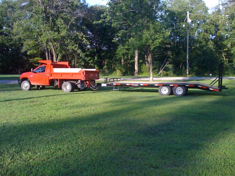

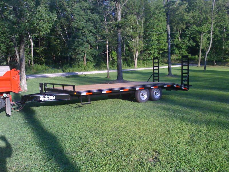

Picked up a trailer today, Red pulled it like a dream. Contractor grade 14K deckover w/dovetail, 22 foot (18+4). The draft team is complete, I'll follow with some pics when the Yote-n-Hoe is on it ............. :biggrin:

Now you just need a tractor to go on that trailer. :hide: :whistle: :poke: Ok had to get that in. We just got a trailer just like that at work a couple of months ago. They really pull nice.
Awesome trailer. Are you going to use that setup to make a little extra money or is it strictly for you personal uses?

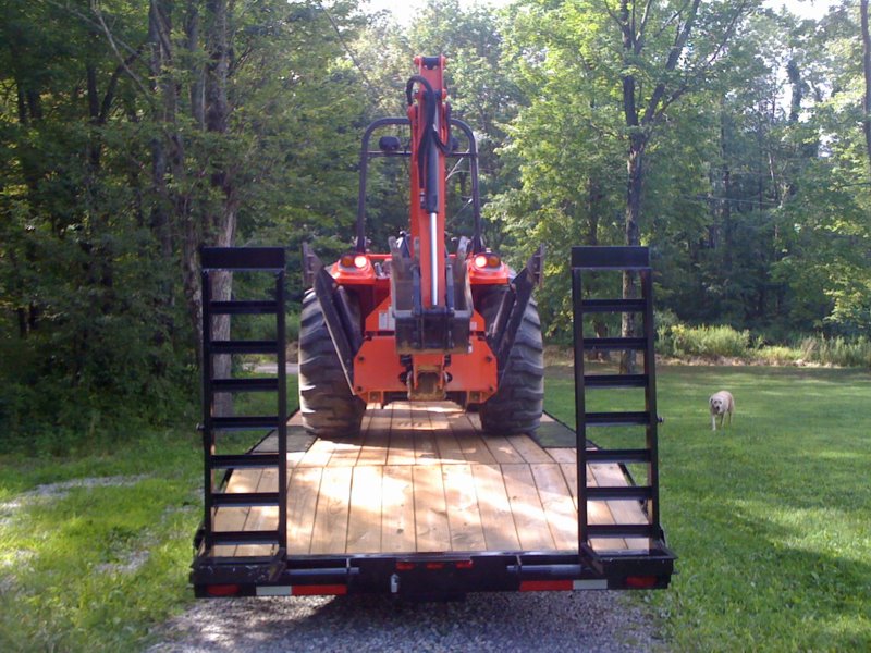

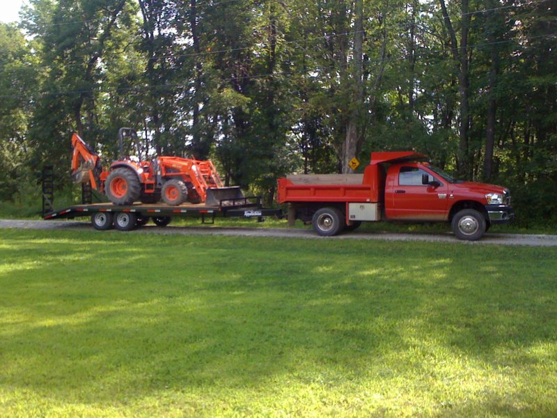

I've been getting more and more request for work and I'll be using it to make a little more on the side. Now I can go more on the outside of my local network. I put the tractor on this morning, no surprises. I'm still waiting on my binders. I was a little worried about lifting the truck on the load but it was uneventful. Soon as the binders get here I'll make a run to the public scales and see what she tops out at, I'm guessing at around 21.5K. Besides loading it by backing it on, any suggestions binding the hoe? If I rest the hoe bucket on the dovetail the boom extends beyond the trailer length. Any one have similar setups they can post to give me some ideas?

Even though the hoe and the loader are part of the tractor, D.O.T. doesn't consider it so.
They'd want you to use two chains on the tractor, another over the loader bucket.
You could set the backhoe bucket flat on the dove tail and run a chain across that as well.
Should make 'em happy....sort of.

On setups like that, of which there are many, your weight distribution is accomplished by changing the position of the machine on the trailer. You may find that loading it back or forward a few inches will move enough weight so as to make it a really nice ride and handle well.
You may even find yourself backing the TLB onto the trailer, who knows? :whistling:
Just be sure you're observing state regs as to GAW (Gross Axle Weight) to avoid buying more potholes in highways. :glare:
Also, read carefully the print on your trailer and truck tires and see if you're overloading them. Add air pressure to achieve the max pressure. Might take a few trips across that scale to get 'er done.
Some guys will nail a block of wood down to the trailer bed to run a tire against so they get the machine parked in that sweet spot every time, or paint a mark somewhere.
Oh, as for chaining down; Run your chains down along side the stake pockets, then, up through it and hang the hook on the side of the pocket. It doubles what the pocket will endure as to stresses of tightening the chain.
In a sudden stop, it may prevent the pocket from tearing loose from the trailer bed and allowing your pretty t'ackter from moving on the trailer deck and really making the situation crazier!
That's one :wow: factor you want to minimize as much as possible. Save the scary rides for the carnival, my friend.

Weld a chain hook on the back of the hoe bucket, (you will eventually want one there anyway to lift stuff). Lower the hoe just a little, run a chain from one side of the trailer, up to the hook on the bucket and back down to the other side of the trailer, then raise the hoe to tension the chain. This will help with side to side movement of the hoe arm, but I wouldn't use it as the means to secure the back of the tractor. What I use for that, is a chain run through a heavy clevis attached to the drawbar if it has one, (cant really tell from the pics).
