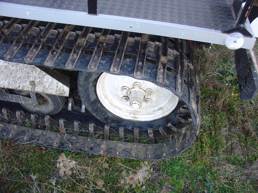

In the way to the main garage, for some special repairs ( not only to change the oil filter, plugs, oil, but especially for the seals - both of the valves, and to change the exhaust manifold and the clamp with the new one), i didn't used a trailer for this purpose, and i choose a way inside the fields.
The distance is about 5 km. I didn't notice and realize from the beginning that the rear left tire it wasn't in the right pressure, and 1 km before i turn to the garage, the tire was out of the rim and looks like that.
A flat tire is always a problem. The Snow trac after two nights staying in the field, early in the next morning arrived in the garage.
I didn't use the normal way to chance the tire. (With the track jack on the rubber trac).

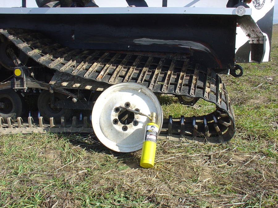

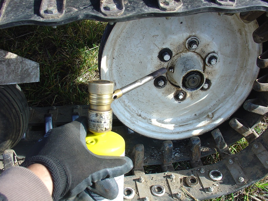

The first day i had to put out the rim from the hub.
I used a several techniques and after some work with my own tools and gadget, the rim was out.

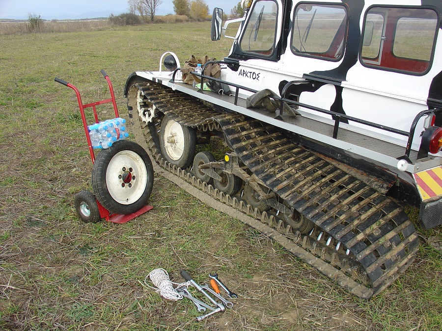

All the morning in the second day i was trying to change the tire with a new one and the afternoon of the same day, i try to put the tire on the hub.
That was not so easy, actually it is impossible to do this by my self.
(I make a test, if something happen when i am alone, and i have to do by my own help, and it cost me only my pride).
From the first time i didnt want to take out the 4 bolts who connects the sides of the rubber trac and then to use the track jack.
My thoughts were, how to change the tire without to used the normal tools.
I have to say that i felt very comfortable because the main garage it was 1 km.
to be continued ......

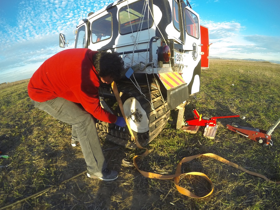

The morning of the third day, me and the boss we fix the problem. The problem was how to put the rim with the tire (without the air inside) and without to take out the 4 bolts of the rubber trac, ON the hub. At the end I use the air compressor for the right pressure. After that in the next 20 min the Snow trac arrived in the garage. ( I have the solution, tell me your problem).
I Have to say that it was a great opportunity for me to realize, how the things are working, and what i have to do the next time if something happened with my big tires that are not foam fill yet.

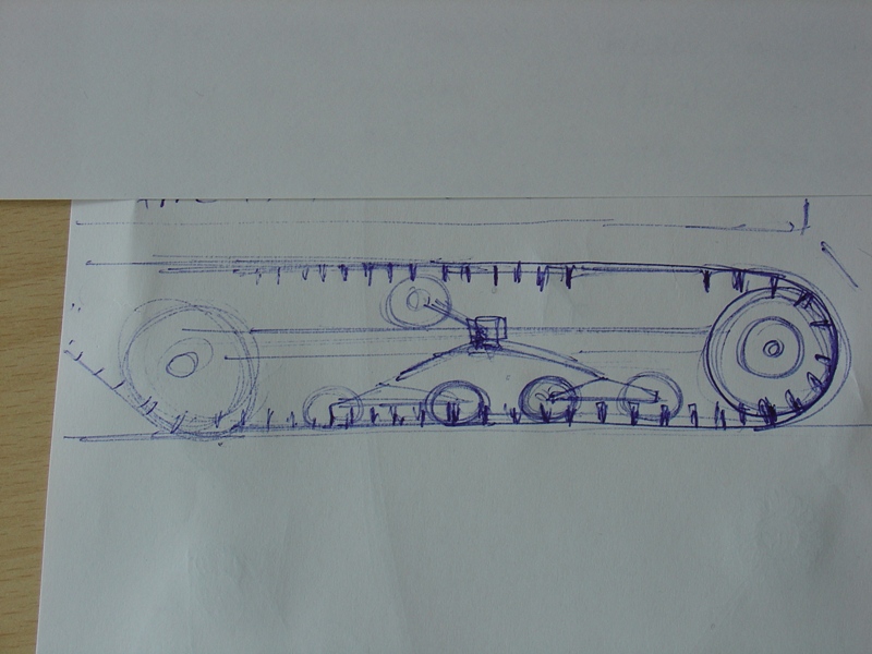

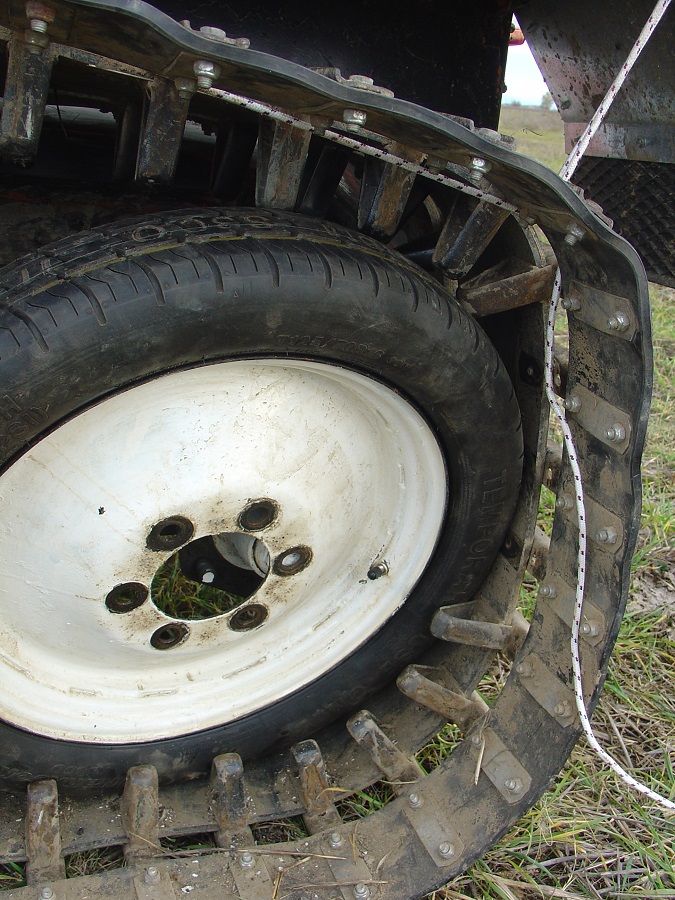

As you Know the hub is a michanism that is not so stable.
It has certain movemenets. (Three Kind of MOVEMENTS).
The second day i was trying alone to set the rim with the new tire (without the any air inside) on the edge of the hud.
I had to remove 9 external guides to set the tire in front of the hub.
After that I had serious problems how to set the rim in the 6 edge guides, under the pressure of the rubber trac.
The michanism of the hub it always moved (Circular movements in deferent derection). I used some moves levels, with no sucess. This is something that a person cant do it by him self. An extra help is neccessery.
The next (third) day with a second person, a friend of mine, this problem solved in only 10 minutes. We used three kind of move levels, - also wedges, and the rim fixed on the hub withour any damage. There wasn't any other damage, only on the surface of the hub, i scratch the white color (the second day with the levels and the Acetylene flame ) as you can see from the pictures.

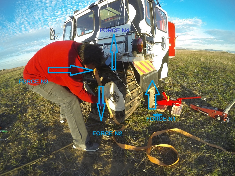

The picture N2
The Force N1. The hydraulic Jack, lifts the left side of the ST4 on the air
Force N2 = It's opposite to the Force n1 and puss the track to the ground, because the gravity. The rubber trac in this point is heavy and with this movement we can tension the trac around the rear tire.
Force N3 = Is the orizontial force, to tension the rubber track in a line between the sprocket and the rear tire.
Force N4 = Just to hold the weight of the rubber trac in this point.
Jim
As for the way to change a flat tire, i think i will do it again with a second person with me. But i dont know if this is the right way if you have 2 ft of snow because we must use the Force n1. In this case we need a hard ground (a piece of wood or something else).
Nikos

I don't have any nice pictures, but the way I did it:
jack up and support the rear of the trac.
Slack the rear wheel,
Slack the Drive sprocket
Use the starter to rotate the track backwards placing the most of the slack on top.
Install a 4inch by 4 inch post in the soil behind the trac and braced to the rear. Use small ratchet straps to pull the track back, and up away from the rear tire. it took about 6 straps to pull it away enough to get clearance.
I was able to then dismount and mount the rear wheel fairly easily.

The 2nd Day it was very hard for me to fix the problem.
Many times i thought to break the track.
The 3rd Day after we set the rear tire, at the end, i roll the track about 1 meter and then i set the 9 removed guides. (It was difficult to set them, when the pressure of the tire on that circular area is very high).
