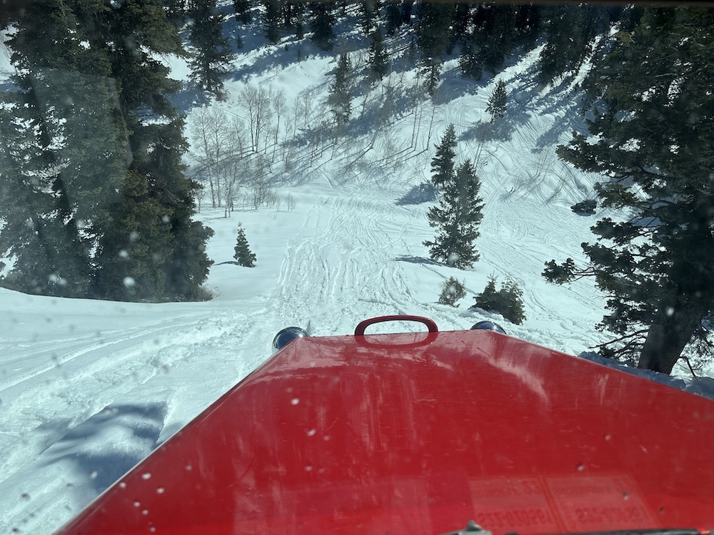

When we arrived at the "tester hill”, I just pointed Thundercat up the hill, stepped on the loud pedal, and let it climb… all the way to the top. No question… it made it look easy. Last week with CHUGSzilla on the hill, Scott had said when he was ready to start down the hill he thought “Wow, that’s a long way down”. I had the same feeling, and stopped to take a pic.

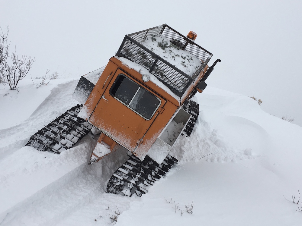

Also when we stopped for lunch I noticed the right backup light on CHUGSzilla had departed. Great… that will be fun to try and find. (See why I call it "CHUGSzilla the PITA”?) We continued on to what I’ll call the "mine site”. Thats where this pic was taken back in 2016. (Yes, that would be Scott driving.)
Scott decided to try again in Thundercat, and here’s the result.
