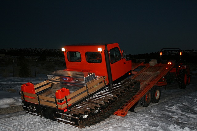

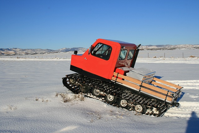

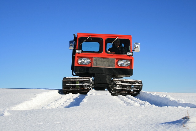

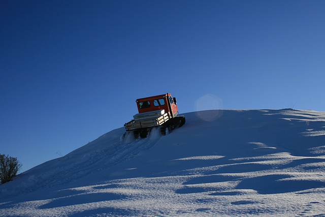

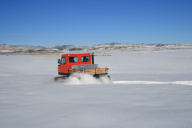

Took the Super Imp out for its maiden "test" voyage today in the desert. There was about 15-18 inches of snow. I wanted to stay somewhere where if it broke down or had troubles I could go get it with the truck. Everything ran great, and it was fun to travel around in. Received alot of looks from passerbys as they do not see sno cats in use over here. A couple of the photos are climbing a fairly steep hill and it seemed to go right up it. It is going to be a great cat.

Thanks! So far so good. The real test will be when we take it out in the deep snow. Maybe next weekend.:winterrul

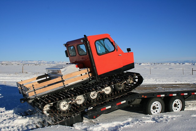

I like your pictures. Is that trailer a bumper hitch or fifth wheel? I might have to build a trailer to take my snowcat to where there's snow. Like Ice Queen, I'm jealous of your snow. Do you have any special surface on the ramps for the tracks to bite into going up?
Hi Snowbird The trailer is a 25 foot Gooseneck. The only reason I use this trailer is because I have not got time yet to repack wheel bearings on the Snow-Cat trailer yet. The ramps and beaver tail are made of angle iron and seem to work very effectively for traction loading all of the cats in my "Fleet". Here is a picture of truck/trailer. Can hardly wait to try this Imp in much deeper snow.

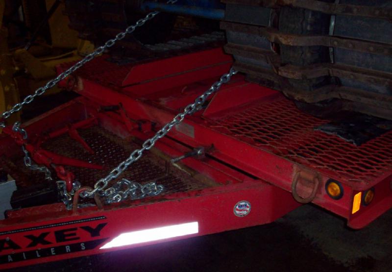

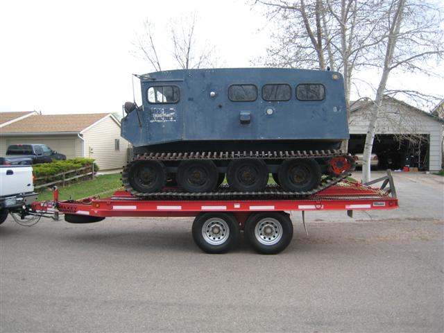

Maxey has rubber on deck to prevent slippage but it needs a redo to prevent the metal carriage bolt heads from adding slippage... full width rubber with wide-spaced bolts but the center channel helps straighten out if things get crazy. Maxey undergoing surgery to beef up the tilt deck to handle a 12K winch. Time for Maxey to 'sack up!' :doh:

As an aside, the Maxey is a dedicated snowcat trailer and designed as a bumper pull where most of the 5th wheel/deckovers are general purpose and ready to haul really heavy weight so I think there's variability depending on purpose. Maxey sells to PB dealers and usually are a default in a sale to the new owner of a $350K PB as a bumper pull. Some folks will bolt down 4"x4" onto the flat of a deckover to simulate the channel which works quite well and is removeable. I really enjoy a dedicated tilt-deck for the snowcat...pull a lever and drive right on and then you get to go for a ride on the way down to a level position...and this was the nature of Thiokol trailers as well. The Maxey is a bumper pull and I have it on a 1-ton dually (a bit overkill but what the hell)... I didn't want to install a ball in the bed and it does quite nicely as a bumper pull. If I were hauling more than one cat or a beef-cake cat like a 3700 or a big Tucker (600's are about 6K lbs), then I'd go with a deckover goose as the Maxey can't even handle the weight given the 12K limit. If you ALSO want to haul other equipment like Bobcats (or a Mr. Bobcat sitting in a Kristi), front loader, etc... then a deckover goose is definitely the way to go. The stability of a deckover is superior to a bumper pull as is, obviously, the loading on the truck suspension. Deckover goose's are also generally less expensive because Maxey figures that Mercedes/BMW/Range Rover/Audi people like Boggie are buying and/or big ski resorts where they are lugging around their $350K investment so $10K is chump change. ;) I got mine slightly used and saved up cereal box tops and sold a kidney.... also depends on how much luv you have for the tilt-deck vs. ramps. The photo shows how nicely a 6 fits on without a lot of excess length, etc...

Yup, I thought about that quite a bit... and thought about that X pattern and the 45 degrees... considering it but I like to use chain more. D-rings are moved in for that X-pattern. I was also thinking about a clamping system that simply locks the cat onto the trailer with swing arms but then thought it was too much modification. First things first...get the thing beefed up and then the winch on there then get the 601 sitting beside it up and running.

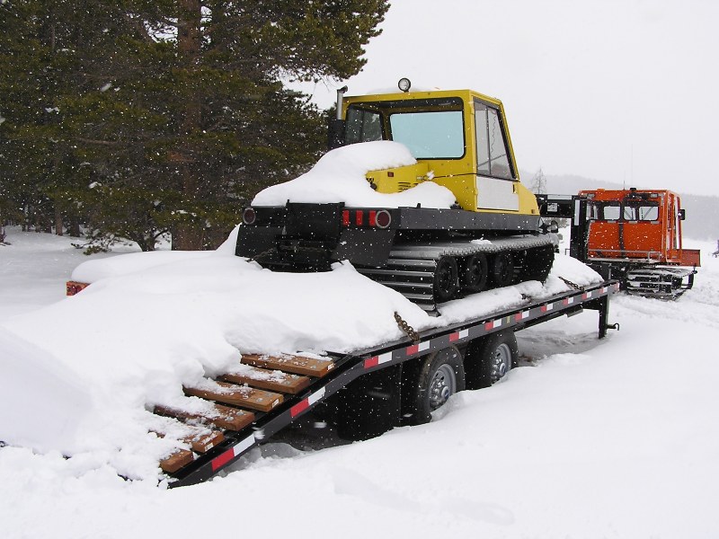

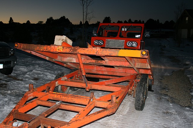

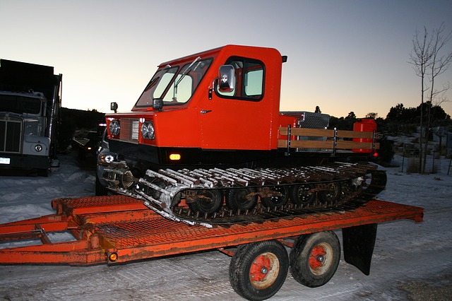

Here are some photos of the trailer I have been working on lately, I think Snobird was interested in building something simular to this. Deck on trailer is 14ft. by 8ft. will work very well for an Imp transporter!! Just finished with new bearings and races, seals and dust caps. Also worked over wiring on lights, new grommets and all new lights. Replaced mud flaps and bought new tires for all 4. Will take it up this weekend for first long tow.

Thanks for the pictures.:thankyou2 It definitely looks like something I could build. It appears you've used mobile home axles. It's been a long time since I've checked them out, but as I recall they had electric brakes, but it appears you've used hydraulic (I think I see a line in your frame). I like your having a hydraulic cylinder to slow down the tilt bed. I'd wondered how big a "thump" you'd make as you drove over top dead center. I also like the channel you built into the center to guide your tracks. I don't know if they're too slippery, but expanded metal coated with plastic (for hog flooring) could help protect your grousers?

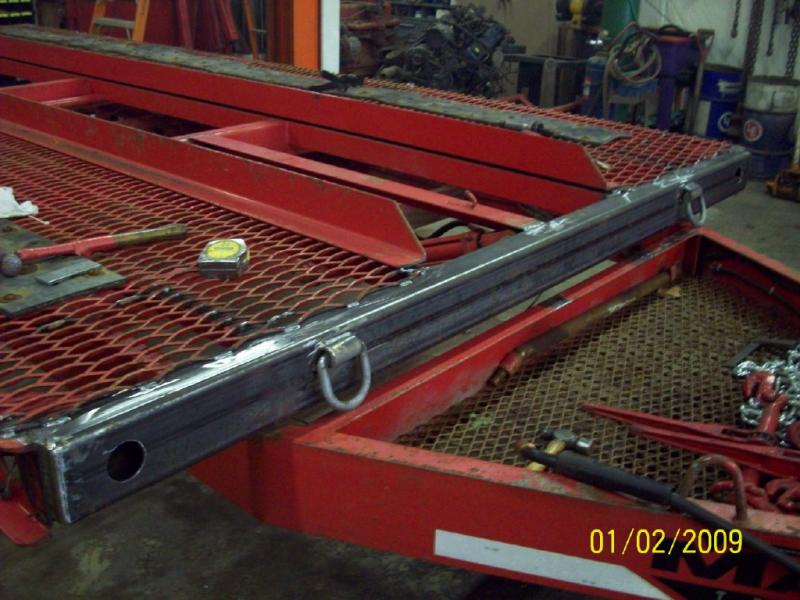

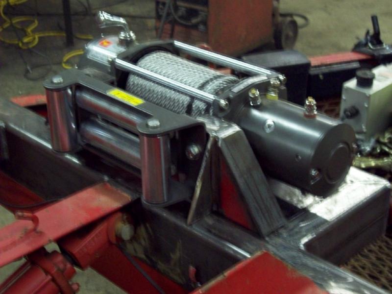

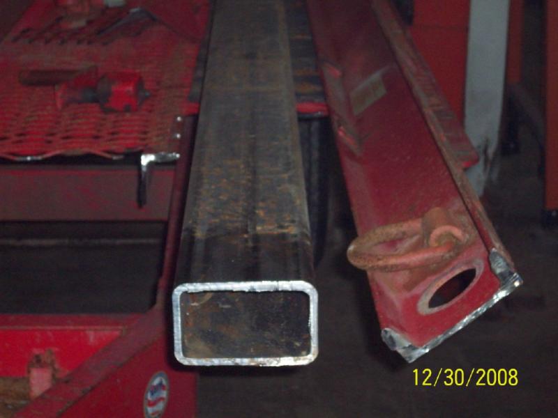

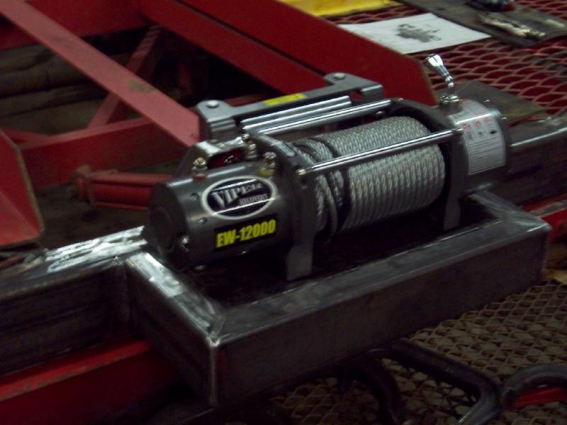

Getting there... 12K winch up front now on the tilt portion of the deck (the trickyness to installing on the tilt is of course bulking up the frame to handle the torque on something that's just supposed to bear the weight of the cat during load with limited lateral force / torque on the front). Hence, Iron-man build up on the front... no torquing this thing off when winching a 601 up at full tilt. So, when loading, the front portion of the tilt is up in the air with winch up there at nose-bleed altitude. :brows:
A 601 shown for good measure to see pre-surgery. Post-ops to follow when complete. New double lock clamping mechanism going in to replace relatively lame Maxey-created hand-cranked bolt version (lame-o!). You can see the hand-crank version in the 601-shot.
Welds included to keep Boggie happy in his critiques. Come on... Bring it! :biggrin: Tape measure and a different hammer added as props. :yum:
