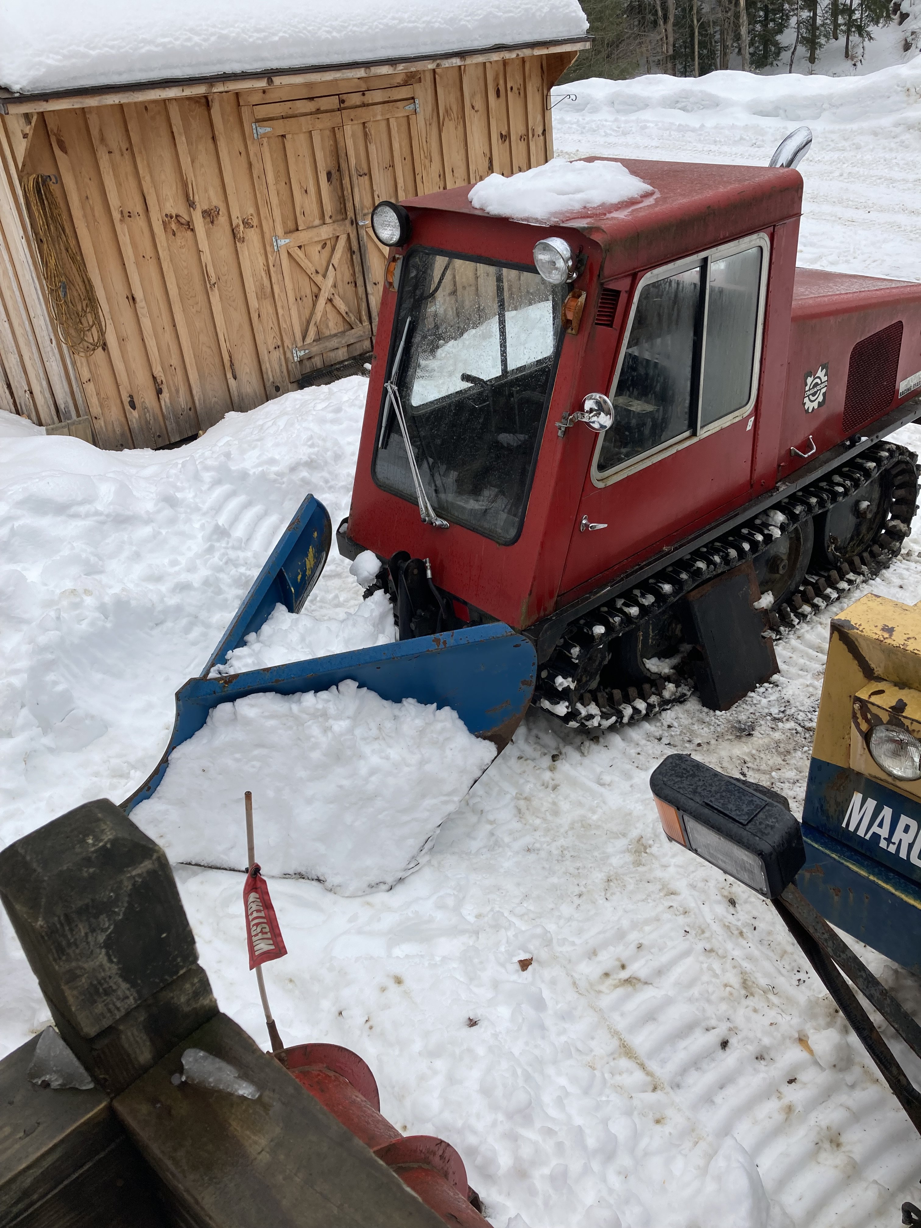

This is what I have

I'll take a look do you know of anyone that mounted a western or meyer plow on one of these the v plow is nice for breaking trail or if you used it on a sidewalk

All of the SW48's here that I have seen are angle blades , I once saw a bunch of V plow equipped units for sale in new york state.

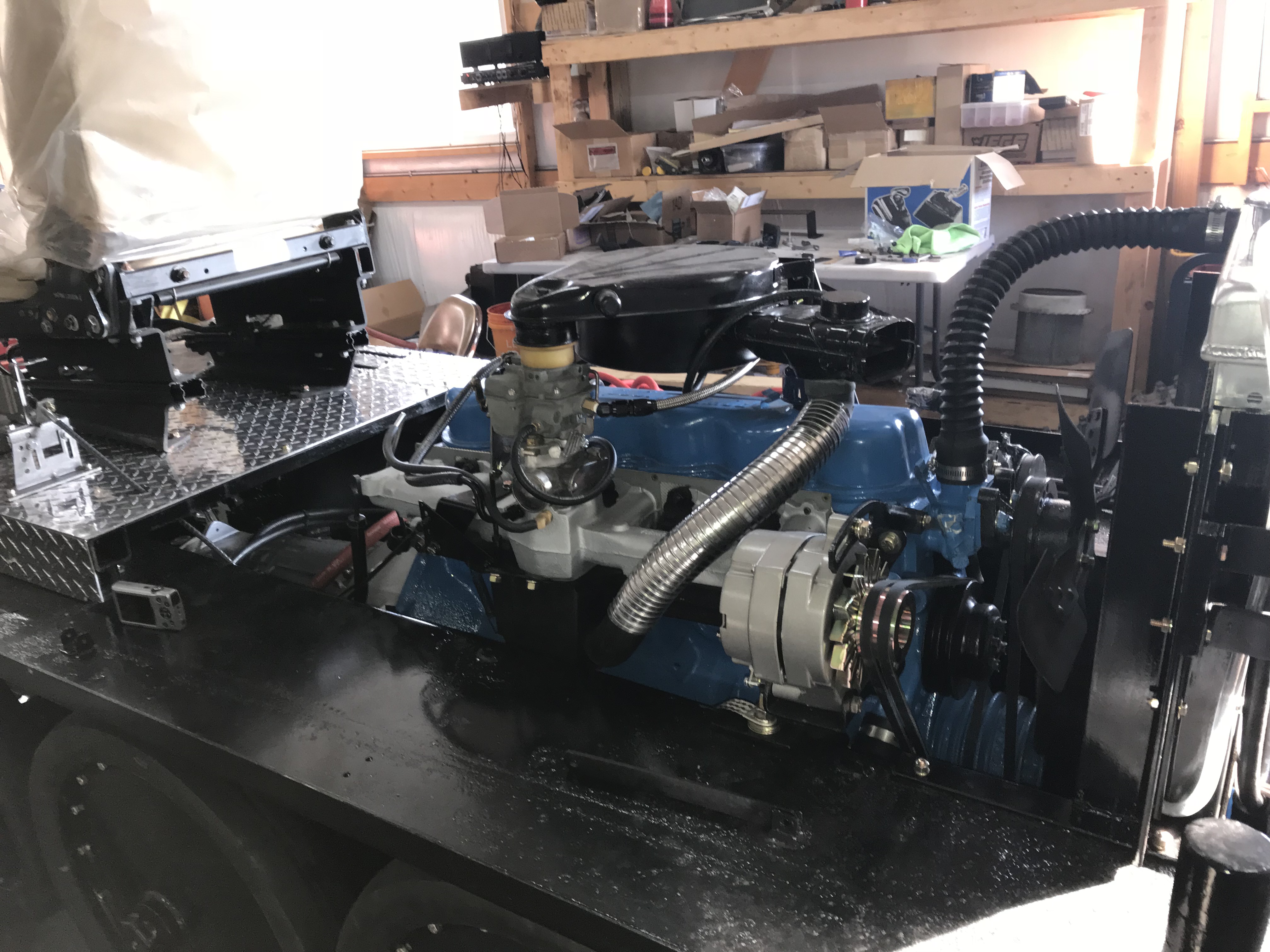

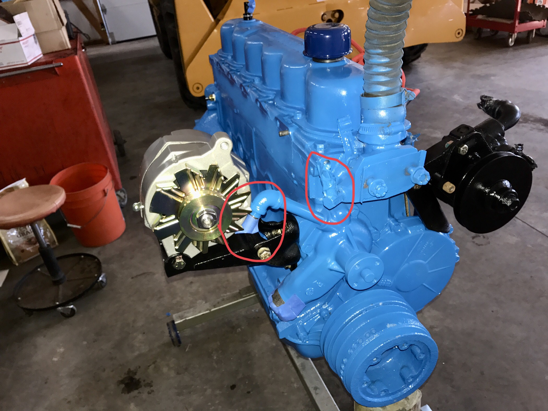

Here’s a couple pics of the Ford 300 in the SW48: heater hose locations and the carb (it’s a Holley 1940 single barrel). If your carb is freezing up, check that their is no phenolic riser or anything keeping engine heat from it. If you‘re at a high altitude, maybe the airplane guys in here have a suggestion for carb heat/shields.
Bob

thanks for the pictures Bob What i have is 2 sw48s 1973 or 74 its red 1979 or 80 its yellow The yellow one has the ford 300 4.9 engine it has no problems with frost lots of other problems I'll get into those at another time The red one has a ford 250 4.1 engine with a 4 speed the red one is the one with the problem after doing some research I found out that in the sixties some ford models used carb spacers that the heater hose ran through No one has been able to tell me why this was done I found some on ebay the order is in I realize that I will have to modify it a little So what I need to know is I have heater hose coming off water pump and one coming off the back of the head are these correct and witch way is the flow Bob I checked out your other post on he steering gears and related parts it will be very useful when I tear into the yellow one Any help would be appreciated
The flow should go from the pump (the pipe sticking out to the left) to the heater, then from the heater to the connection by the head (next to the thermostat).

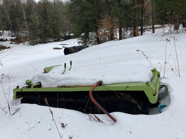

Thanks Bob for that information My next question is the yellow sw48 has a axle leak on the left front size I've seen the posts on disassembling put my question is I have this green one
I have used the sold tires with the rims on the yellow one Can you tell me what model it is and will the drive line parts axles ,sprockets gearing tracks interchange

Hi Tom
The yellow SW48 looks about the same age as mine, late 70’s. The green machine…..that might be a J5 (our member J5 might be able to verify)…….not sure on interchangeability, but I’d bet they are very close if not the same.
