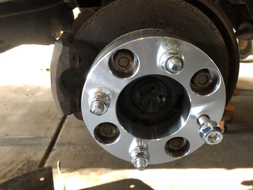

So today I traded my old Thiokol 603 for the Camso tracks for the Suzuki and some other parts for the Tucker snow cat. Now the fun begins cobbling them on the Suzuki. In measuring the bolt circles on both the Suzuki and the tracks. the Suzuki is 4X115mm and the tracks are double drilled 4X110 and 4X137. There are adapters readably available both ways. First I want to do some research on which pattern is more common for aluminum wheels. When those are ordered (tomorrow) I will start working on the lift. After doing research I have settled on 4" by fabricating 4" risers for the struts then 2" between the engine/drivetrain for a total 4" lift research indicates you do not want more than 2" spacers on the struts without spacing the Engine /drivetrain due to increased angle of the front CV axels to the wheels. that should get the tracks to fit and 25" UTV tires as well. I have to finish my Christmas shopping tomorrow but next week all of the manufacturing plants are closed and I can put some time in it. Looks to be about 24-30 hours fabricating and installing. Most of it ( engine/drivetrain ) will be 2" square tube with holes in 6 places then fabricating the strut spacers. Also some modification to the steering arm and front A frame stabilizers plus what I haven't seen yet. I will try my best detailing what I am doing with pictures so it will be easier for the next guy. Marty

After measuring a couple more times I determined the bolt circle on the Suzuki is 114.3 mm ( 4.5" ) not 115 mm. After researching wheels and tires I ordered the wheel adapters to fit the 110mm pattern as there are more choices and the prices are better to. The 137mm pattern there are few choices in a 12" rim mostly 14" and 15" with 30" tires. I will end up with a 25"- 26" tire. I found a mini truck forum on Facebook that sells progressive rate springs up to 475# that give you a decent ride but really control dipping and body roll and are reported to give a 2" lift in the front just due to the stiffness. I don't have Facebook so a friend mailed him for me. He got back to me sometime last night. I replied with my needs and now waiting for his. I hope to have this thing on tracks within a week or 2. Marty

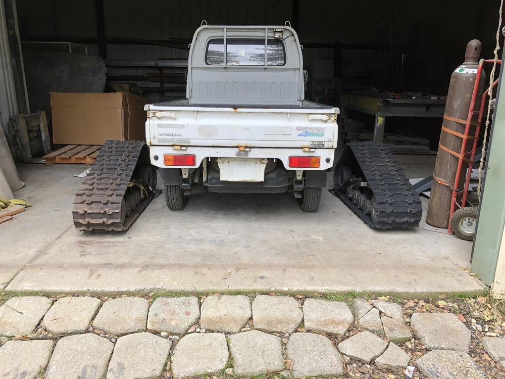

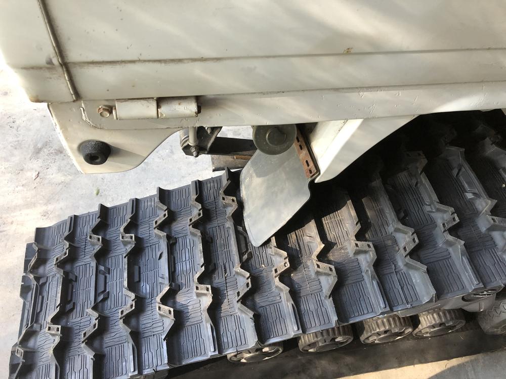

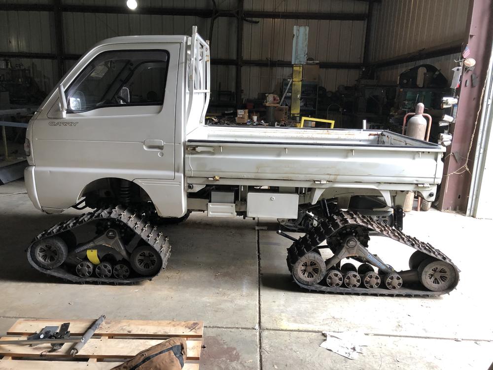

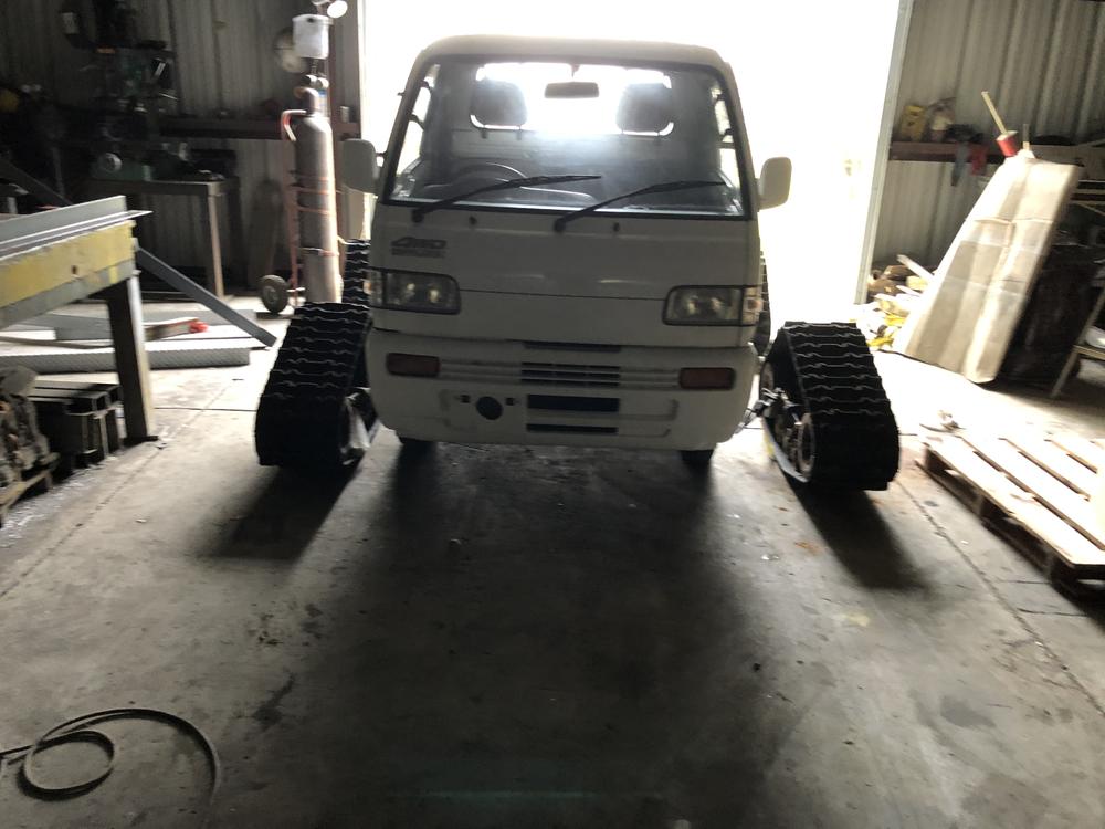

So yesterday the wheel adapters showed up so today I
removed all mud flaps
installed the wheel adapters
trimmed the front wheel wells and doors
bolted on the tracks
got some ideas for mounting the rotation limiters, the front ones attach to the lower A arm. I plan to use the 2- 12mm bolts in the picture that hold the stabilizer bar and add a couple more for my new fabricated brackets I will work on tomorrow. The rear bars attach to the frame. I can't do the rear because the lift kit isn't here yet and when installed the dimensions will change. the front won't change so I can do those now.

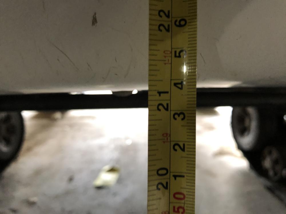

just with the tracks and no lift kit the ground clearance is 18" and will go up another 3-1/2" with the lift kit. That will be 21-1/2" almost as much as the lifted Dodge. After the anti rotation bars tomorrow when the lift kit shows I am a day away from finishing plus some finish work. Marty

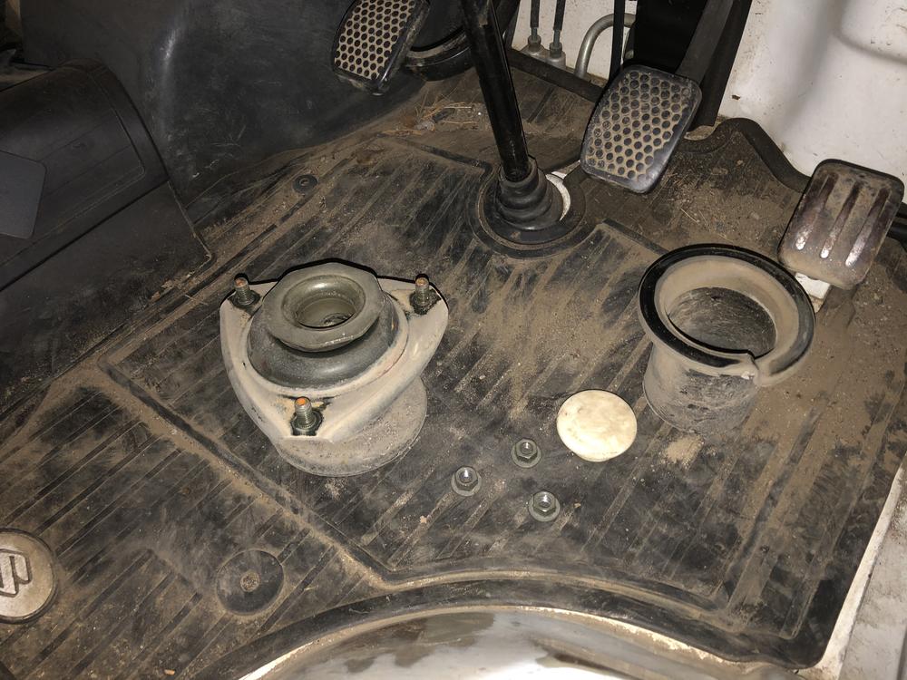

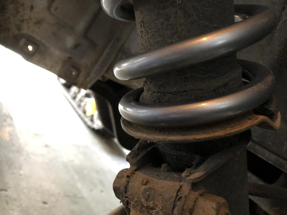

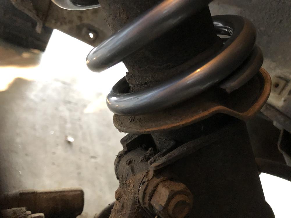

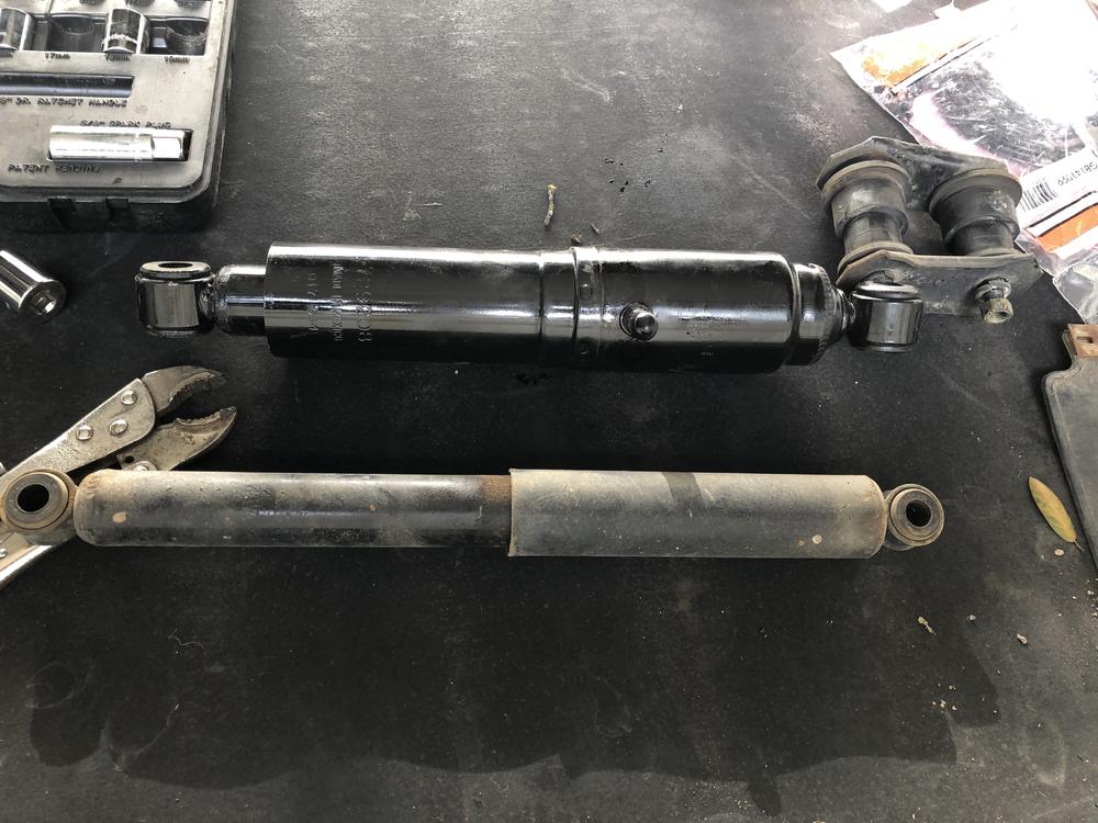

Today I started off by cutting the material for the rotation limiters then the lift kit showed up so I switched gears. The front lift is not overly complicated but the spring is a challenge. First it was very tight on the spring seat and had to be worked down with vice grips. Everything is tight I had to use a bunch of vice grips with the teeth ground off and a couple of small C-clamps to get the spring compressed enough to get the parts and nut back on. everything is so small and tight you can't use a normal spring compressor, if I was going to do a few it would be worth it to make one. The 275#-475# spring is very aggressive and difficult to work with in that small space but I got it in the end. Got one side completely done nd the other 90% tomorrow I will finish it and do the rear lift then get back on the anti rotation brackets.

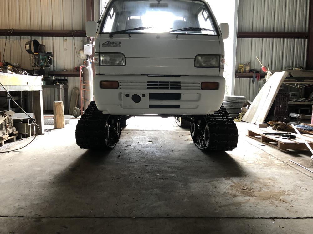

Today I started off by finishing the front lift. The adjustable castor camber 2" strut spacer is definitely needed. I used every bit of the slot to get the tracks flat on the ground. When the lower A-arm goes down it really gets the camber out of wack. You can see the adjustment in the picture. Next I moved to the rear lift. I supported the frame with dunnage and used a floor jack under the rear end. The only thing that made it a little difficult is the new polyurethane bushings. I had to cut the shackle bolts on the left side to get the old ones off due to exhaust pipe interference. The new air shocks have more stroke for the lift. I routed the air lines to a utility box on the side of the truck. It ended up about 3-1/4" higher with the lift kit 2" with the strut spacers and the other 1-1/4" from the stronger spring. The only thing left now is the anti rotation brackets front and rear then adjust the tie rods so the front tracks are parallel. Change oil and head to the mountain. I have to work in the field for the next couple days so I can't get back on it until Wednesday. Marty

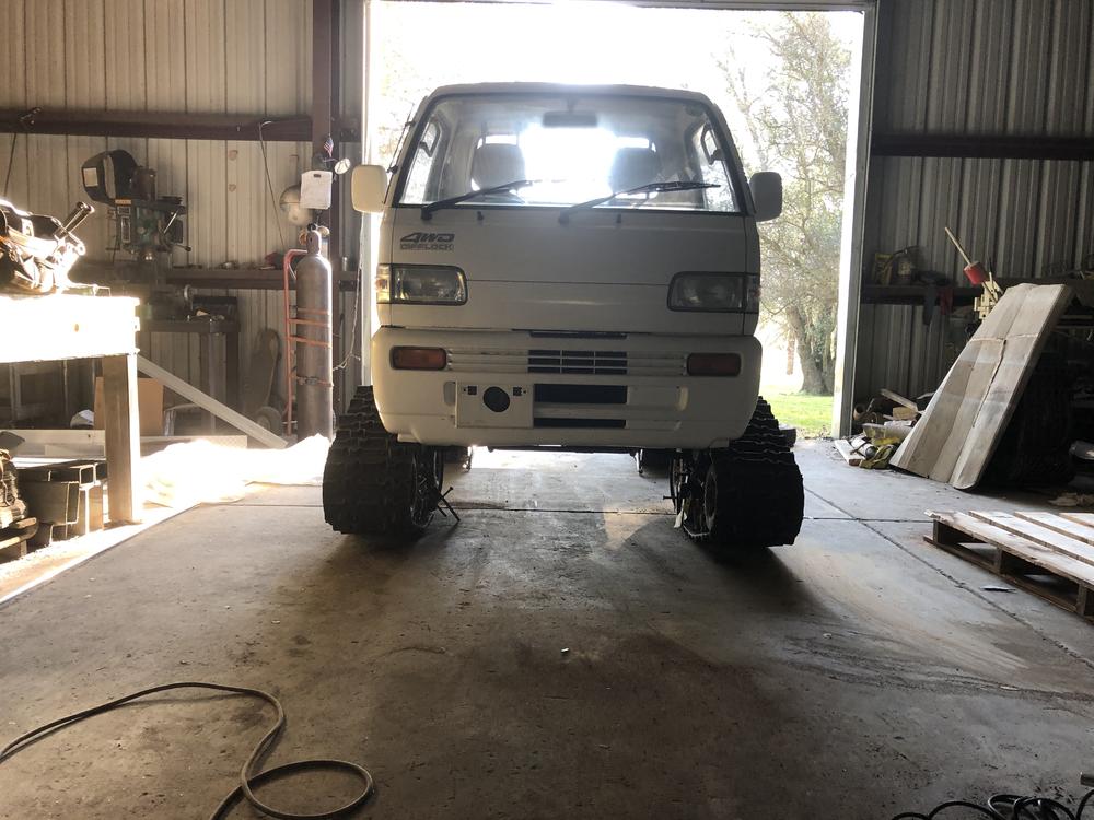

Ok, today I was able to finish the rotation limiter brackets front and rear. I set the tracks parallel in the front. There is always something, as I was adjusting the tie rods to get the tracks parallel the one on the passenger side had one tie rod end that would not budge. I even took it off put it in a vice with heat and penetrating oil, still wouldn't budge and I didn't want to brake it so I ran the one in that would move far enough to get it on the driver side tie rod. I got it but now the steering wheel is not centered:( Anyway the fabrication was time consuming about 12 hours, some of that was time spent figuring it out ( the front bracket rotation arm pivot needs to be centered under the ball joint and I wanted to attach it at the strongest point on the A-arm which is where the front stabilizer attaches to the A-arm). But I didn't want to modify the truck and when you take them off you can't tell. I did back it out of the shop and pull back in just to check it out. Still have to set track tension change oil and test it around the property then clean it up and put on trailer aimed at the mountain. Marty
Today I double checked bolts for tightness like lug nuts. I backed out of the shop watching as I went, when the front tracks broke over the driveway angle the rotation limiter bolt came very close to contacting the front track wheel so I pulled back in and cut of about 1-1/4" it looks much better now. Next I drove it around a little looking for problems. Everything looks good so I washed it and will clean the inside later today. You can see in the video it travels at 1/2 walking speed in 4-low in first gear at idle. It seems to have plenty of power. I will continue to test and post as I go. I would like to take it to the Mountain soon for some real world testing. I have about 32 hours in the installation, the worst part was the front springs. Marty
