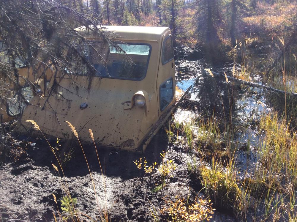

I sunk my Bombardier JS 72 in a kuskeg bog. The water was right up to the sear level inside the cab.
I am a new owner and have no expirence with these machines but have access to good mechanics and shop.
It ran ok once we got an excavator in to pull it out, th n bogged down with debris clogging the fuel system. It has a 1972 S10 GMC 6 cylinder motor. The fuel system is good now but there are many issues with it freezing. It is -10 here in the Klondike today.
The transmission is frozen solid, so I believe the is water in it through the vent tube in the cab.
The very least I need is a maintenance manual. Does anyone have one that I can receive electronically?
We have managed to get it into a heated building, but what is next.
All help or comments greatly appreciated

Send me a private message with a email I will send you a manual. Just grease the track components and as long the differential is sealed well and and no water is in the oil you should be good. I go to the boards every time I go out:yum: In the pick I cut some black spruce as a base and drove out even though it weas pushing water into the cab:w00t2:
