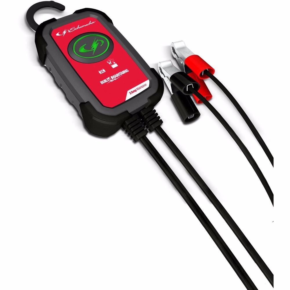

I bought a Battery Tender for the Crossfire to use during winter storage. After, being hooked up for about 12 hours, the bad battery LED came on. A quick check of the paperwork that came with the tender indicated that the battery could be sulfated, which means it is not taking a full charge and putting out the proper voltage. Damn, only a year old battery and expensive as hell.
Tried it again and lo and behold the big Green blinking LED came on this time after a short time of charging indicating the battery was up to snuff and the tender had switched to maintain mode. :clap: Oh, happy day.
My guess, is that the battery was just starting to sulfate and the charger reversed the process on the plates. Anyone ever have any experience with this or versed in Lead Acid Battery technology?

Putting a small light bulb across the terminals while charging was going to be my next step, but apparently this tender, in charge mode, is not very high so it did the job on its own. All is well now and the battery goes right to maintain with no issues. Sitting around a long time with partial charge is not the best thing for lead acid batteries. I'm glad I dodged the bullet.

My boats have great battery chargers. Small, compact, smart enough to heavy charge, trickle charge, and level off the batteries. Completely ignition protected, and electrically protected.
Not cheap, but I would suggest them to be better than thing pictured above.
I can picture an internal short in that thing shown above, and it exploding into a ball of flames as a result of the available fault current in a 12vdc battery.

I'm not into spending big bucks right now for high end charging systems. I hear what you are saying and I installed a spare arc fault outlet along with a GFI for the 120V. The unit is sitting in a 5 gallon metal pail so fire prevention paranoia overcame me momentarily. I am OK now. :yum:
