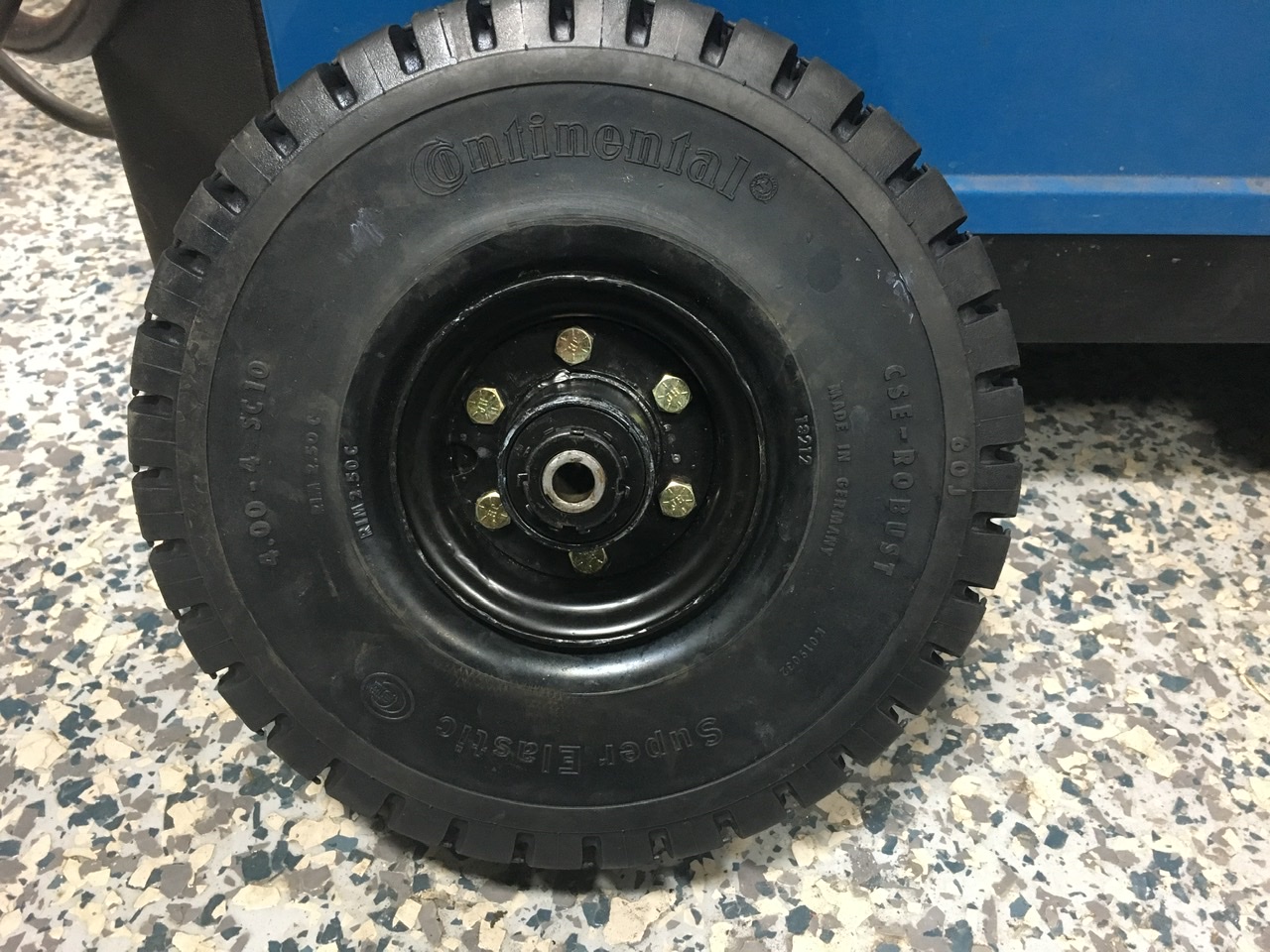

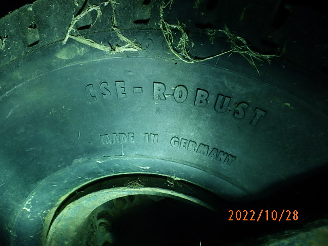

Most of mine are brand name Secura. they are 6 ply. do well. but more of a rounded profile than original. The issue with cart tires is some are only 2 ply, and >I< wouldn't trust them. http://www.klovsjo.com/snowtrac/ Christer had a source for some OEM ones but don't know the status.
Can you give me a brand/model and or source for the forklift tires. I tried several sources and no had no luck!
Thanks

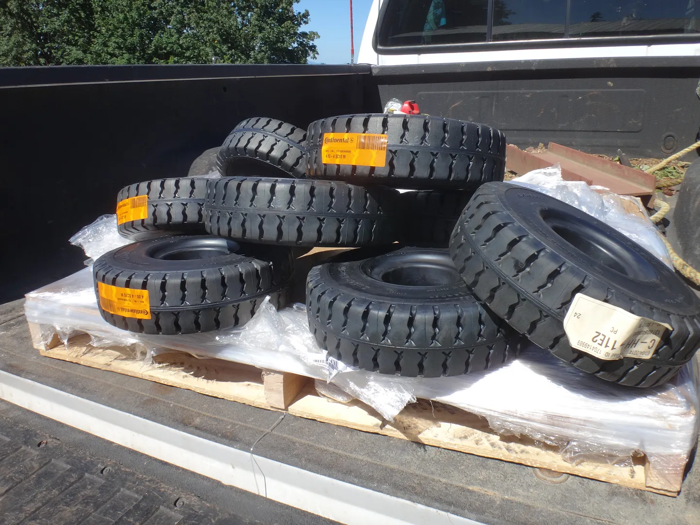

i posted several pictures search should find better pictures but they are continental forklift tires they are solid.
No luck to this point finding Trelleborg T522 or T991 bogie tires and Continental says probably 90 days plus to get their SC10 forklift tires imported at ??? price.
