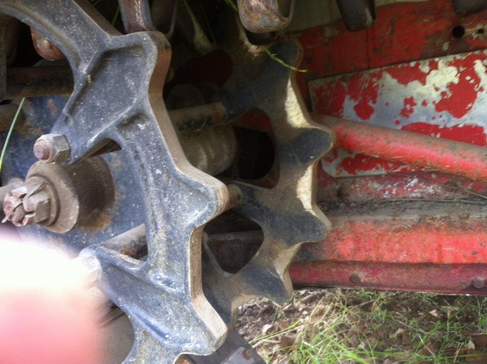

I had a chance to look at the st4, sprockets are beat, need replacement, I wonder if they where brazed up and then cut to the original profile how that would hold up, also the front small idler wheels look like they can travel up high enough to touch the drive spockets as both side had groves cut into them is that a common problem?

silicon bronze is what I used when fitting my new sprockets. it sticks good. I am sure you could use it to build up the teeth. use a wire feed welder.

it will be a lot of work but you can build them up and regrind them with a wire feed and nickel bronz wire as a plus side they will were a lot better that way.

My St4 has new drivers casted from the north pole foundry at the alaska foundry. They are very nice and worth the money. You could probaably get them from Snow Trac web site in Sweden as well as other parts. Good luck and hope it works out for you.
