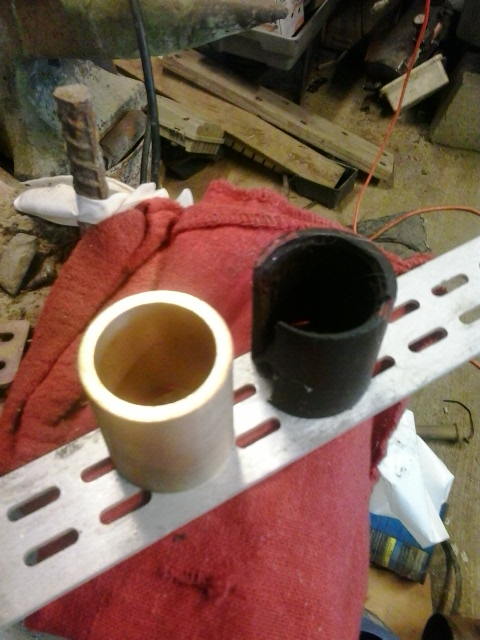

The other thing that can cause this is the rear wheel axle support bushing. I will try to find photo's so you see the part I'm talking about.

Thanks.Yes please show me a pic of that part.
the housing, and a bad picture of the bearing and it's replacement. As it wears, it allows the back tire to mis-track. During turns it can get really bad.
The original was phenolic bearings which when worn allows the assembly to tilt. I replaced with bronze bearings.
