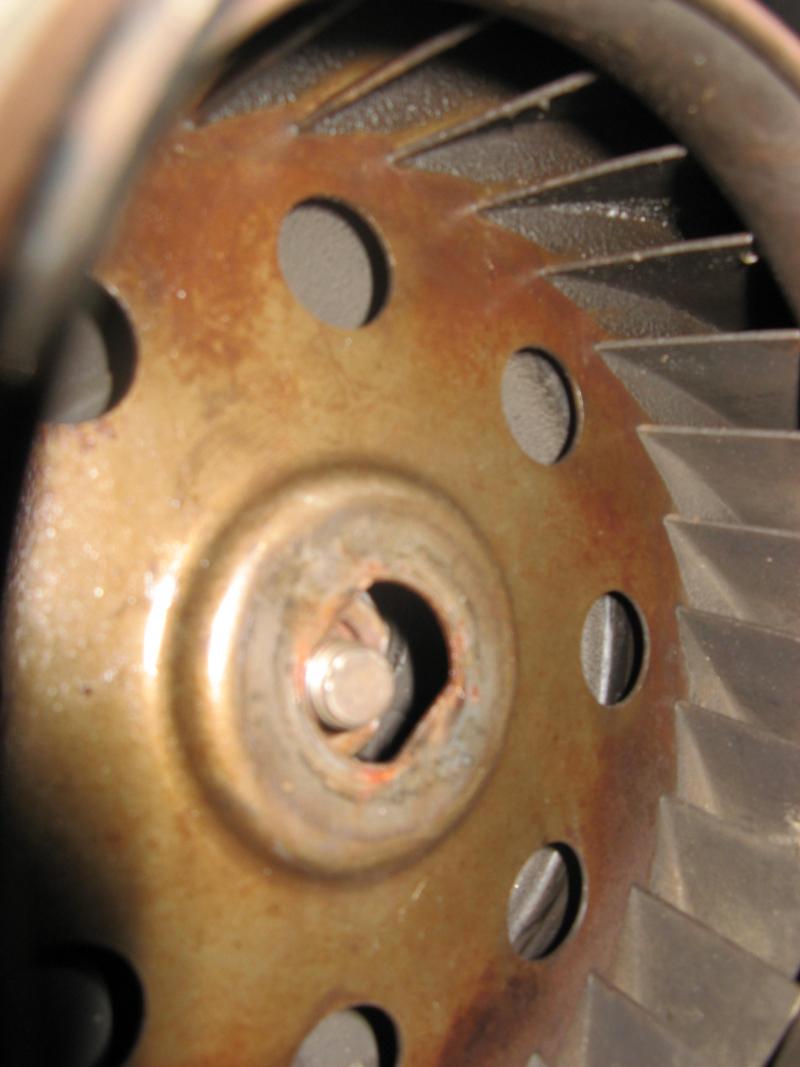

So here u can see that i've removed the air intake, and i've unbolted the fan from the back of the generator. But still it wont budge.

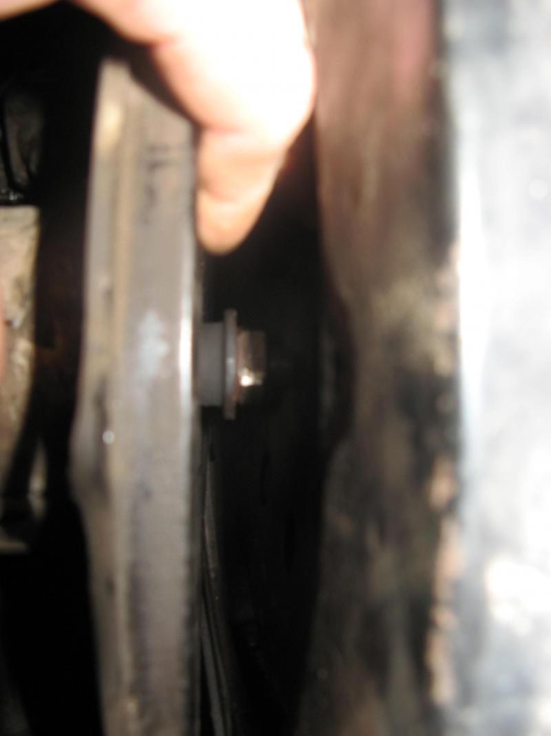

So than i started to take the plate directly behind the generator off (not sure if that's the right thing to do or not). But now the last bolt to get at is (facing the pic), on the bottom left. And there is too much stuff in the way to get at, and its not even a bolt like the other 3, where as this one is rounded off. And the only way to get at it, i believe is to take off the carburetor etc. and im not sure if this is what i have to do. So i've been sittin on it the last couple of days in confusion, contemplating my next step:hammer:.

you have the smoller 1100 or 1200 motor i will ck with a bud localy who has converted several of these to night when he goes to work and ask what he did there are mods he dib externaly on my parts rig when he installed the 12 v generator i assume you are having a time with trying to get the fan off the shaft so you can get the generato out
also when i said removing the intake i ment the intake manifold and carburator i believe that is the only way you will get the necessary clearance to remove the gen.

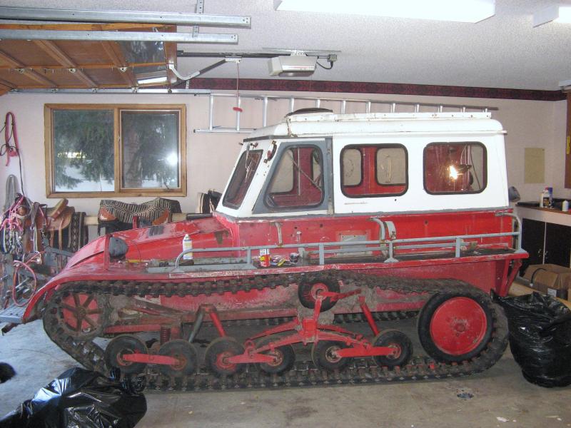

Thanks for the pictures. Do you know it's lineage? What company owned it? I see that color combo periodically. Red body white roof. Did they come like that from the factory?
Greetings Alberton: I believe the 2 tone color was a Canadian Phone company color. From the Factory they are generally all red, inside and out. I like the Canadian Glass defrosters. You hardley ever see those in the "Lower 48". The two wholes cut in the seat are probably to carry a set of gas bottles for a Oxy/Acetylene torch. Rather a unique set-up! That's the original Air cleaner. Only very early ST4's had those. They are a VW Bus Air cleaner that has been shortened. They were actually very good air cleaners as they were "Oil-Bath" type. The recomend torque for the fan to generator 36 MM nut is around 300 Ft. Lbs., but I would junk that generator. It's a small diameter 6 volt and they only put out 180 Watts, which will not give you much extra to run lights and other electrical equipment. The engine is definately a 1192 CC. You'll find on the block, right below the generator pedistal a number stamped into the case. It should start with 116, the prefix for a VW Industrial. These were not especially good engines and definately not good candidates for rebuilding. It was designed to produce 35 HP. Change it out to a more current 1600 VW engine, which will generate 53 HP. also go with a newer alternator. there's a 50 Amp one available that will generate 600 watts. Much better. Good luck with it!

Re: Generator Removal:
Pull the 2 side screws that hold the fan housing. They are down near the plug wires. Next remove the Carb (2) 13 MM nuts, and plug the manifold so that nothing will drop down into the engine. Now the strap that holds the generator to the pedistal (13 or 14 MM), next the (4) 10MM bolts that hold the fan to the fan housing. disconnect the wiring, and throttle cable. Your machine does not have the original Carb. Your original carb had a Manual choke. The one on your engine now has an electric or "automatic" choke. You do not have to remove the intake manifold. In fact it's not a good idea as anytime you do remove it the 2 "Crush" washers made of hollow soft copper, have to be replaced. With everything loose , lift the fan housing up untill the fan can be removed from the housing. The Fan housing sits over the oil cooling tower so don't knock it around too much or you'll end up with a leaky oil cooler.To test it you can stick 12 volts on the armature. If it spins around like a motor then you didn't need to take it out, the problem was in the regulator. Alot of the time all they need is brushes and to clean the commutator. VW voltage regulators don't adjust very well, or at all on most models, have to go for a new one. 6 volt generators are smaller diameter than 12 volt and sit on a different pedistal. There is an exception: for one year only, 1965, VW produced small diameter 12 volt generators for VW Buses. Porsche also used them for many years. Because it's considered a "Porsche Part" they are a real rip-off, price wise. Unfortunately many years of VW industrials came with the small diameter 12 volt generator and they tended to end up on Snow Trac's.
