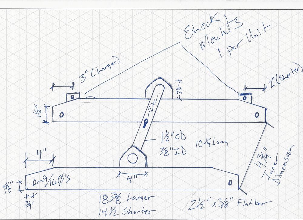

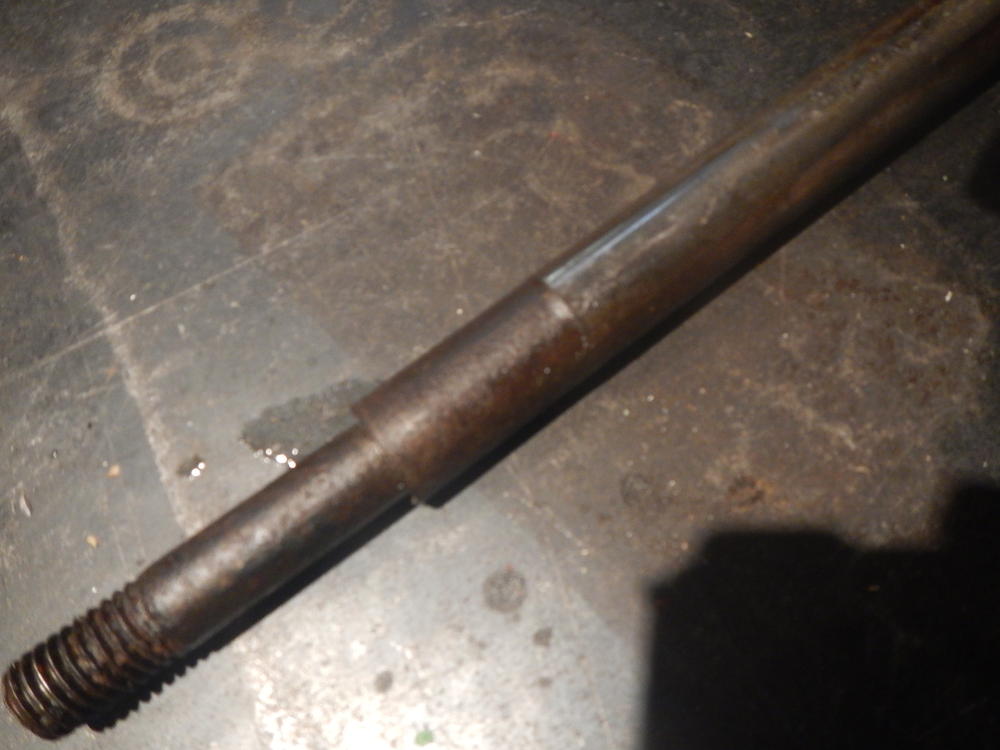

I am working on repairing my st7139bogie frame .added some 1by 1 ¼ angle to stiffen the sides. I will close te ends so not to pick up any trash. The phnololic bearing were shot so I turned out some replacements out of bronze bearing stock. The sleeves are 7/8 5/8 DOM tubing the shackle bolts I threaded 5/8 cold rolled steel. I want to repack the wheel bearing also. With coming and going mite have it ready for next year!

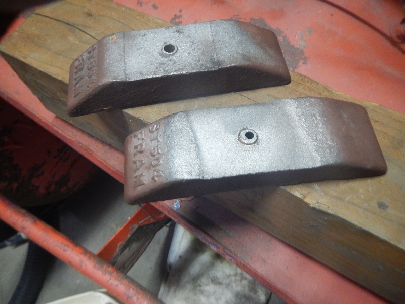

I welded up the spring hanger as was worn as they do
built it up with weld and dragged out my old Ammco shaper.
I not much of a Shaper hand but was fun flatting it out
there something about a Shaper. sometimes I just square up a block just to watch it work. And as an old timer told me. you can make anything on a shaper except money!
I drilled out the centering pin new center bolts on the spring and it should be as good or better than new
