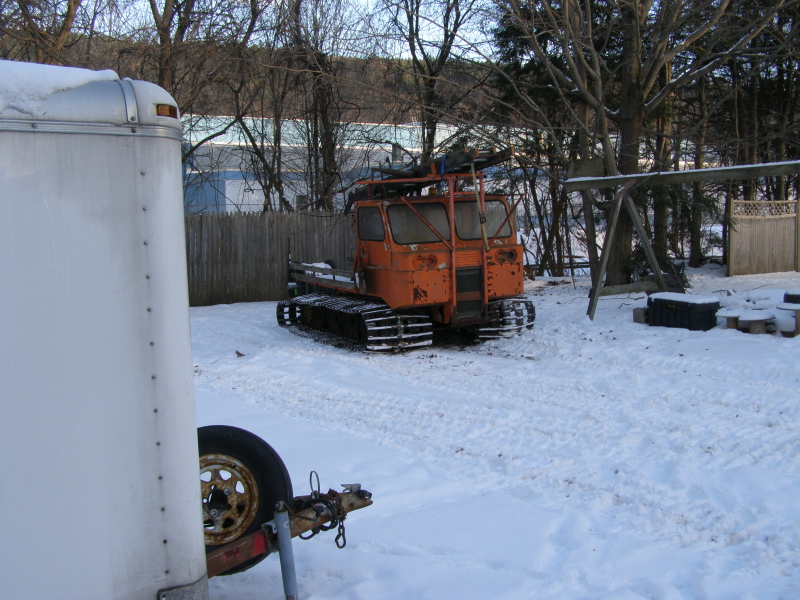

Hello all!
I recently aquired a '68 Spryte from a ski area boneyard in the northeast. Her headlights have been stolen and someone mentioned that they thought the lights were the same as some truck headlights. Does anyone know a part number (not a Thiokol number) for these?
Also, she's a runner but her sneakers are shot. I am looking for a complete set of 26" tracks but don't really want to spend $20,000.
Thanks,
Dan

There's the bezels.I believe the lights themselves are standard HI/LO three prong 7 inch round sealed beam headlights.They can be purchased at an auto parts store.Prices is around $7 to $15 depending on brand and store.
if those are the small round head lights than the the low beam will be a high low small bulb but your high beam bulb would be a 2 prong bulb which if you add a relay to the high beam you can substitute it with a par 46 aircraft landing light or a par 46 spotlight bulb.
