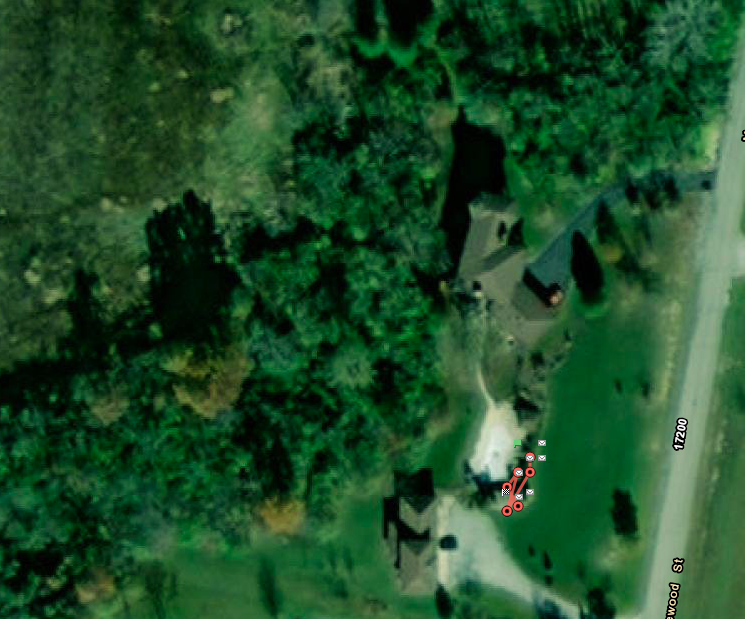

The map below is the unit tracking me while I was transmitting from my pool deck tonight.
Since I typically ride alone this tracking will give my wife some peace of mind while i am off exploring the wilds of Indiana/Illinois, she can live the map open on an old iPad we have and the map will get a "breadcrumb" added every 10 minutes.
It will also give some peace of mind to our daughter and other family members when my wife and I ride on our long distance trips or do our backpacking trips. We have a Route 66 ride in planning stages and plan to hike across Wales, UK early next summer. The SOS button will work 24/7/365 regardless of cell service or location.

It’s not supposed to work but it frequently does. Sitting on a table on a 2 story covered porch. 4’ from the edge of the covered porch. With a 4’ roof overhang above the porch. Light woods to the west and to the north. Obscured view of the sky. It still worked.
2 photos one from the west, one from the east. Showing the SPOT sitting on the table. Instructions clearly state it needs an unobstructed view of the sky. It is pretty clear from the photos that there is no sky above the unit. The house blocks the sky to the south. It has only scant sky visible to the north and the west.
I’ve had 1 failure. I hit the check in button while parked next to a 2 story brick building. I was surprised by that failure and figured if I would have waited there 10 or 15 minutes and tried again the satellite would have moved enough in the sky to pick up the signal but I didn't fell like continuing the test.

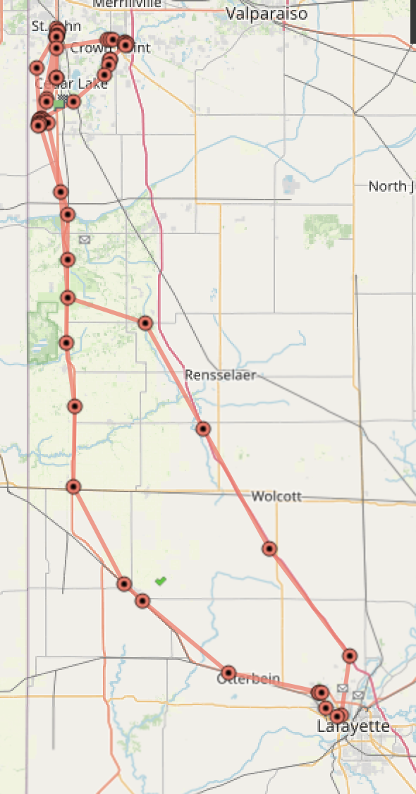

Just for the fun of it, I took my SPOT X in the car when I drove up to Michigan State University on Saturday. Forgot to turn it on when I left the house at 4:30am. In fact at that time I was just happy to remember my hot coffee. Flipped it on while driving just to test the breadcrumb tracking through a windshield because I don't think I've ever done that before. And I've never tested the SPOT X at 70mph on the interstates. My tracking is set to drop a breadcrumb every 10 minutes. Most of my "highway" riding on a motorcycle is on rural 2 lanes, speed limits 45-55 and occasionally I'd get a stretch of 60 on a 4 lane rural highway. In the rural areas it's not uncommon to have patching and occasionally no cell signal.
Traveling at roughly 70mph along the interstate highways, I never lost cellular signal on my phone, but I never expected to lose cell along the interstate. The SPOT X was just there for testing, didn't figure it would actually come in handy.
Here is are my breadcrumbs from the trip. Seems to have worked perfectly. There is one very long stretch, that is from the a prior location to the "start" point at this trip, and the start point was when I turned it on after I had already crossed into Michigan. Weather conditions were cloudy 100% of the time, some patches of HEAVY snow (1+"/hour), some patches of flurries.

Basically I'm getting ready for motorcycle riding season when I ride alone, and often in rural areas. So using the SPOT X frequently, just to check my gear. I'll also be checking my other gear like my air pumps, TPMS, etc.
For the past week I've had a minor issue, the SPOT X, windshield mounted in the truck, would put up a screen saying that I need to cycle the power OFF and back ON because it could not send a message. Thought maybe the unit was starting to fail. This issue has happened to me 3 or 4 times in my travels. In each case it happened AFTER a message was sent out by the SPOT X. It appears that the SPOT X is not sending the message, but when I send messages I send them to a recipient AND to myself. So I get the ping on my phone when I receive it. I checked my wife's phone and the inbound times of the messages, all were correct (within a few minutes) so the unit is working, but I'm getting a strange message.
So it did manage to send out the various messages, "check in" and still kept track of the breadcrumbs properly.
If you look close you can see a GREEN CHECKMARK on the map, I was stopped for a few minutes at Fowler, IN and sent out a "check in" message. This also explains why there are 2 pin drops in that area that seem too close to each other, because I didn't shut off the breadcrumb tracking while I was running into the gas station for a soda.
You can also see a couple small icons that look like ENVELOPES on the north side of Lafayette, I sent out a couple messages from the Freddie's Steakburger, where I grabbed a quick meal after the fencing tournament. One saying I was stopping for food. Another saying I was getting back on the road.
JUST FOR REFERENCE, I took an interstate down to Purdue, you will notice the breadcrumbs are spread farther apart on the eastern route I drove. Speed limit is 70mph, but traffic was flowing closer to 85mph (not admitting to keeping up with illegal traffic speeds) while the dots are closer together on the more direct, but rural highways as the speed limits are lower and there are 2 towns and 2 stoplights on that route between Lafayette and the northern edge of the route I travel.
