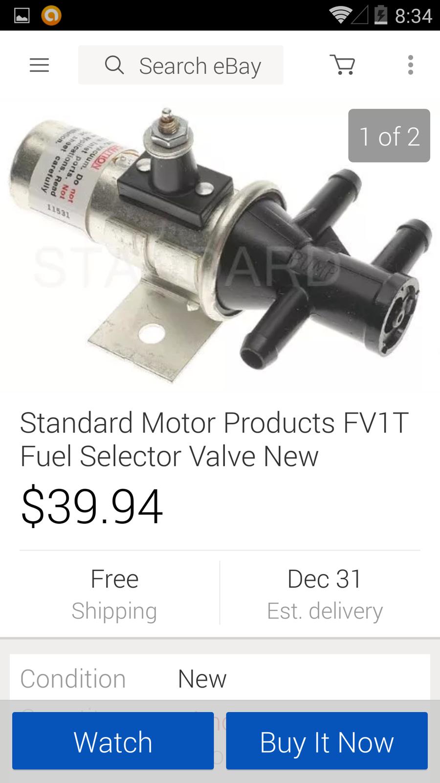

This is what is inline on a 1986 lmc 1200. Line runs in the normaly closed ports, apply 12v to it and valve opens. Auuto fuel shutoff. Just plug unused port.
