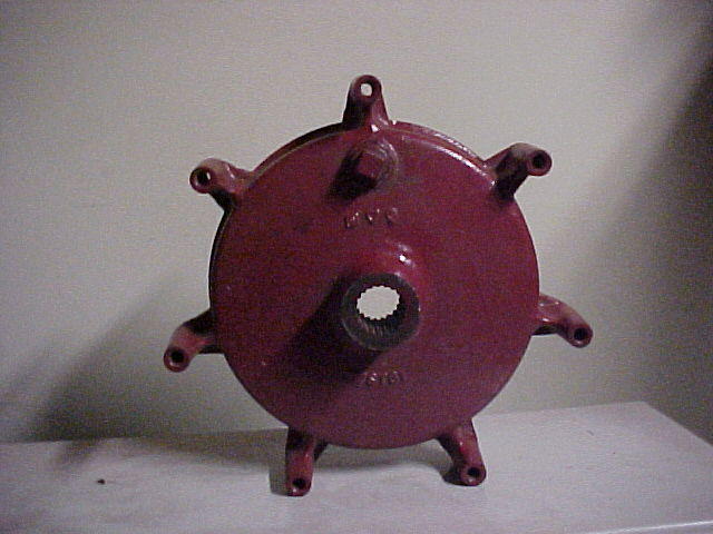

Hello all. I'm in need of a brake drum for a 1968 Trackmaster. It has the fine splines in the non-removable hub. If you have one you can part with in your parts stash please let me know. Thanks, Dan.
This is not mine but is what they look like.

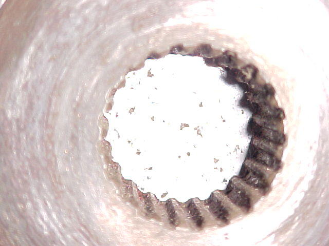

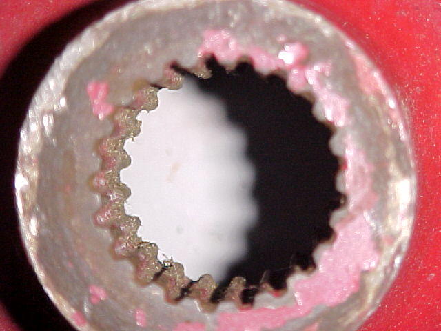

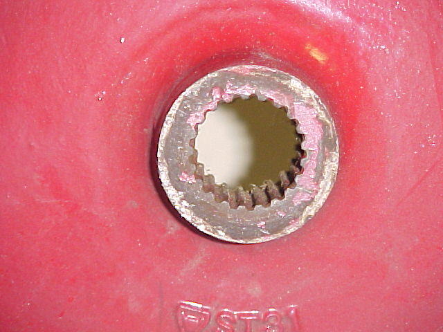

Dan what is the part # on the drum? I have a drum that looks like that the # on it is st31 let me know. Larry.
Dan here are some pic, the splines look good to me.see what you think. Larry

I just bought my first st4 and am doing a complete rebuild.
Larry any possibility that you have another one in that good of shape. Mine is sloppy and the axle is as worn as the drum. The other side is excellent. also looking for track drive sprockets. not sure if there is any life in them they are worn to a point. hopefully when I figuire out how to put up some pictures you folks can comment on them.

Thanks for the info Lyndon. Being new here I'm not sure yet on how to post pictures. I would like to get an opinion on the my splines condition. Will some degree of looseness still last for a while. I take it from what you say that there is no immediate solution and tight fitting axles and drums are hard to find or can't find at all.
