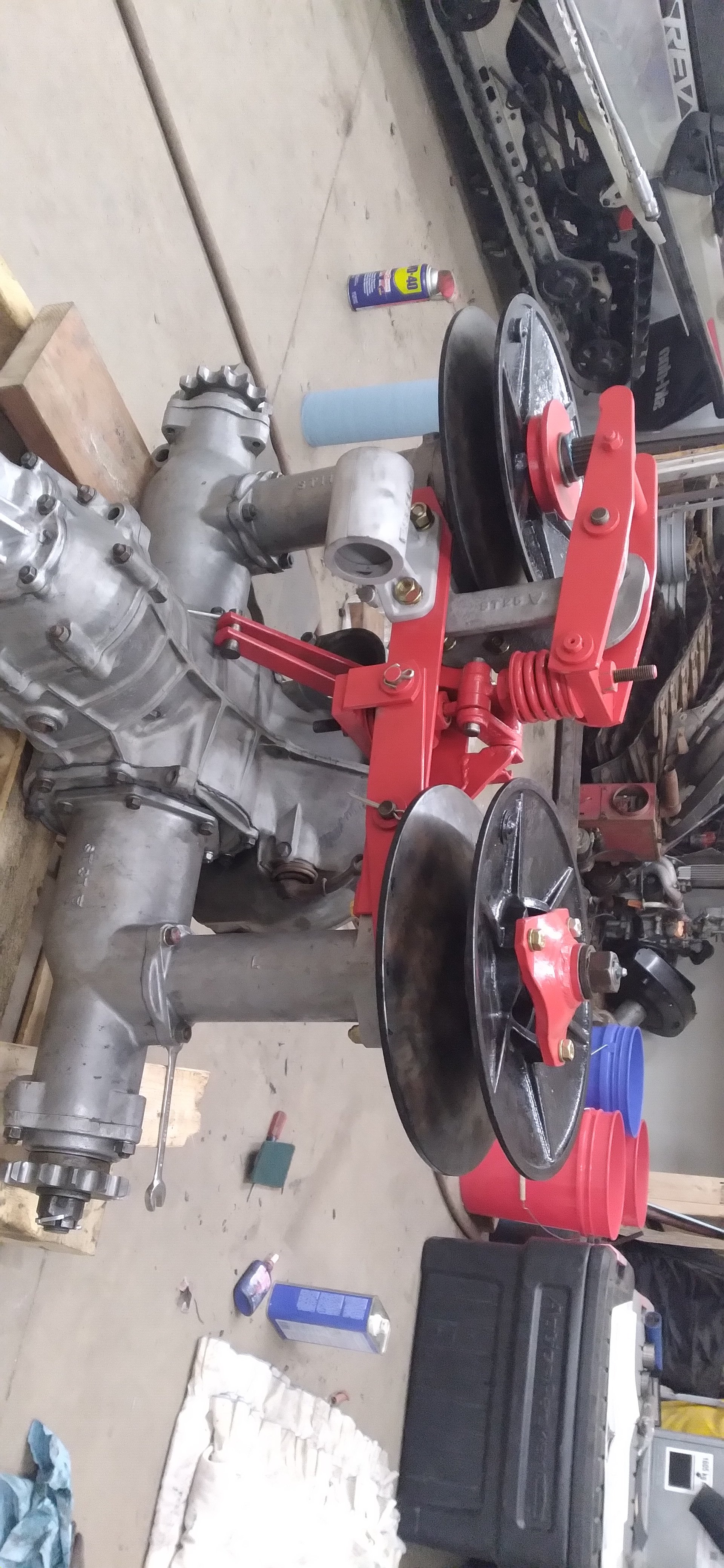

Having some issues with my transaxle/variator. While everything was apart I put all new gaskets on transaxle and new bearings in variator. After I put the towers on i noticed that the drivers side axle was locked up and wouldn't turn. I took that tower off and everything seemed fine. Put it back on with nuts hand tight and it was locked up again. Tore it apart and looks inside the trans and everything looks good there. Everything in tower spins nice. Could I of over torqued the big nut on axle possible pulling it out too much? Any thoughts before I go back together with it again.

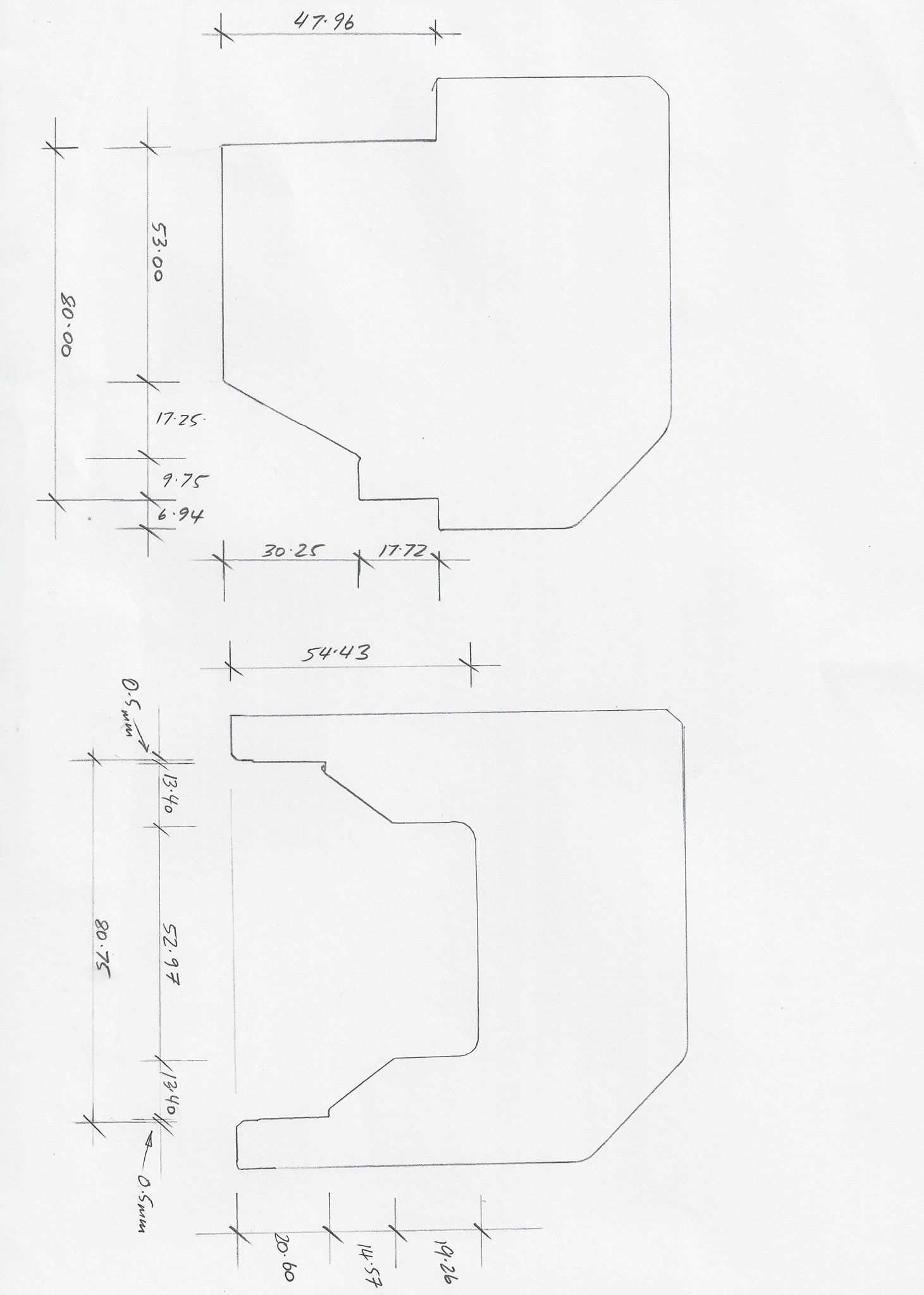

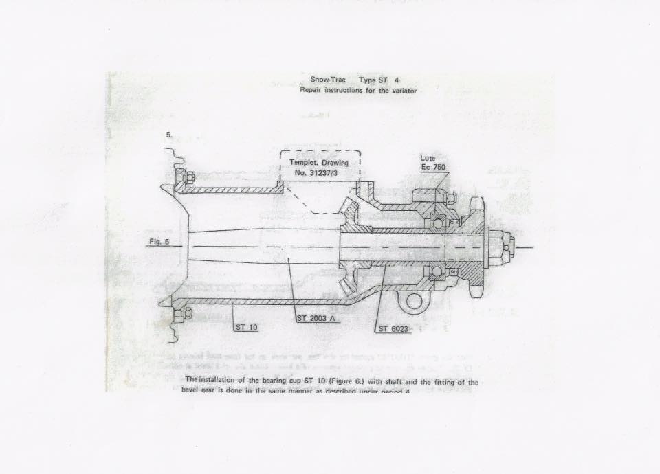

The drivers side if pulled out would decouple from the variator, So I doubt that is it. I don't remember where I found the drawings of the setup templates. I think they are on the computer in the shop. I will look tomorrow if someone else doesn't find them first. The mesh on the gears is set by the thickness of the gaskets where it attaches to the transmission. I assume the transmission spins freely and that the two fulcrum plates are seated correctly. The other thing you could try is some prussian blue on the gears and reassemble and see how much mesh they have.
Seems like everything was working fine until I put drivers side tower on. I'm gonna have to get another gasket so it'll be 3 or 4 days. I'm ready for some assembly.
I kept them separated but anything is possible. Threading new axle shafts now then have to get all my tires made up because they only foam fill on Fridays. I'm gonna go back and look at some pics to see if that might have happened.
I've looked and looked, and can't find the template anywhere. this is from a FB post in the AKTIV Snow-Trac group. which is private so it won't let me just share.

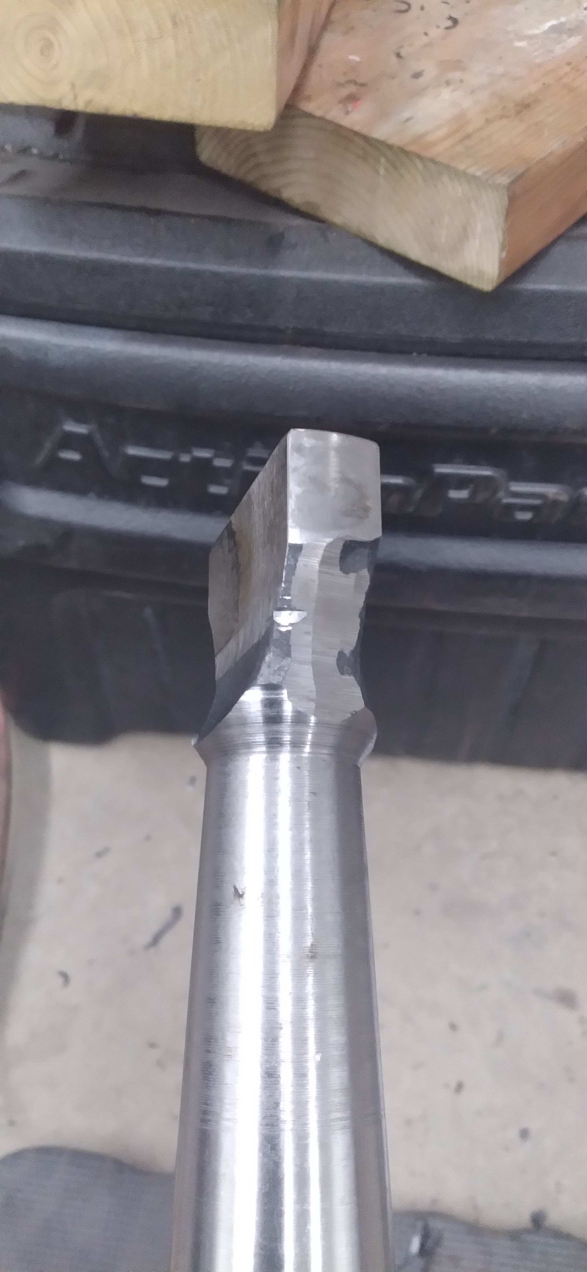

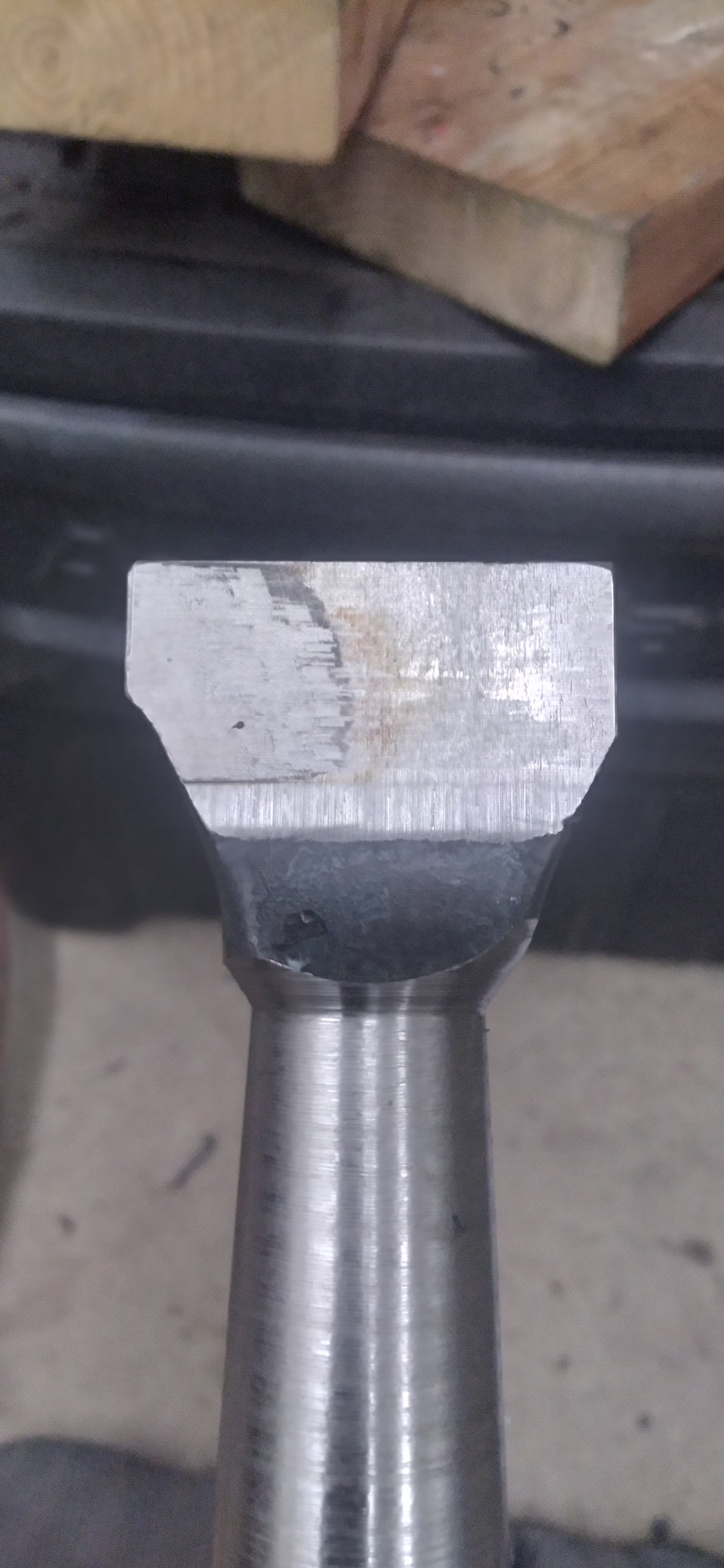

Think I might have found my problem. It almost looks like someone made a axle for this. 1 side doesn't look like the other and is hitting the ring thats held in by the clip. So I need to find a axle or I guess I could grind away. Any suggestions.
Weird that it worked before and doesnt now?
Parts are around.
I takes me years to find parts, but when i do, i usually wind up with another snow trac.
I don't know if it did work before. The engine and variator was out when I got it.. Back story is a guy was leaving state and gave me a good deal on 3 machines. This machine was stuck in a swamp and broke several teeth of the big sprocket and ripped the track off. If was in goodshape so I didn't want to use it for a parts machine. There were enough spare parts to put this one together so here I am. Going to blue the gears today and see where its at. Just noticed last night that some of the manuals show a gasket and some don't on the bottom of variator tower. This one just had silicone there.
Its back together and working. After bluing the gears it took 4 of the thin empi shims and a 20 thousandths gasket on the tower. Re-blued and everything's meshing good now. Just waiting on my belt to show up
