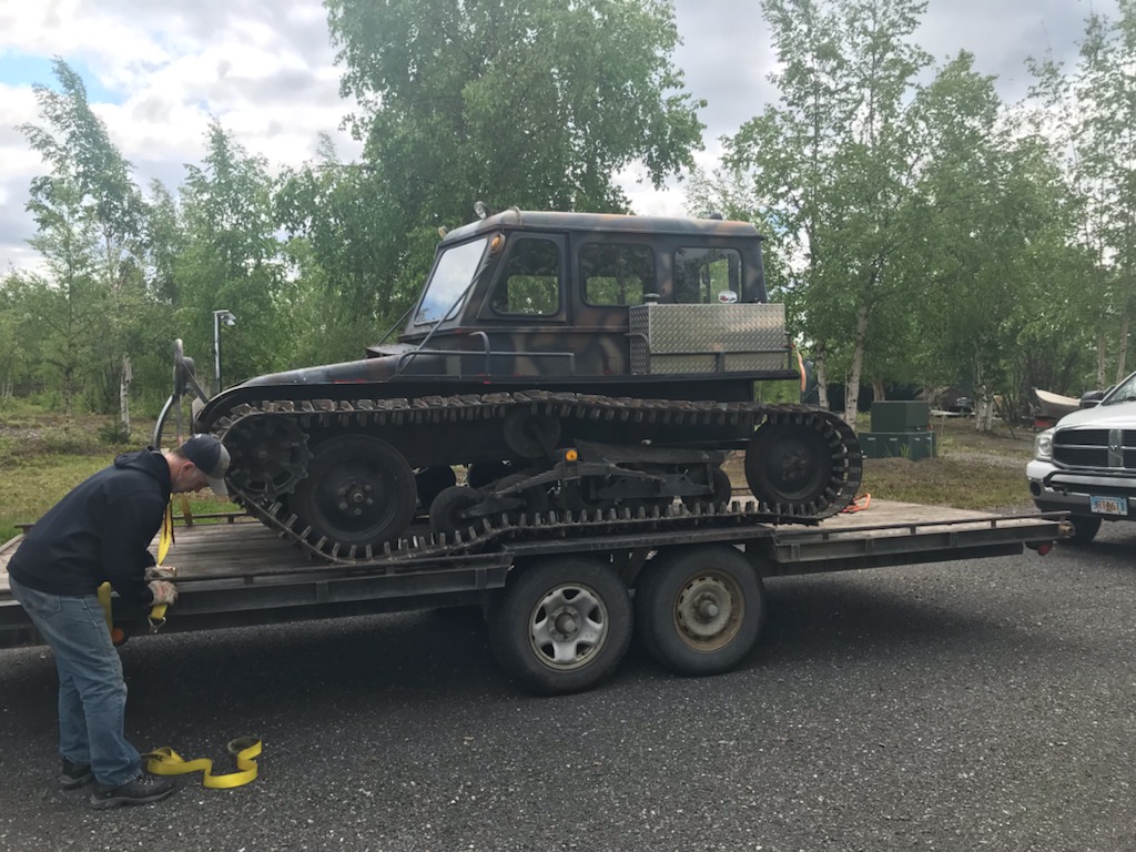

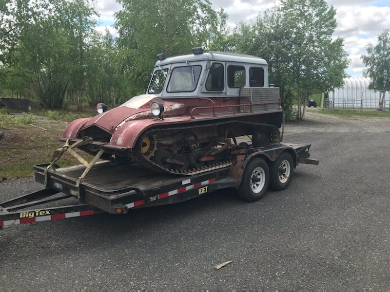

Hello everyone I'm a new snowtrac owner. A few days ago I bought 3 of them. Lol. 2 st4's and a snowmaster. I was curious about belting. Would the 2 ply 220 belting be sufficient. I was also curious about what everyone was using for throttle cables on their machines. The snowmasters broke as we were driving it on the trailer. thanks

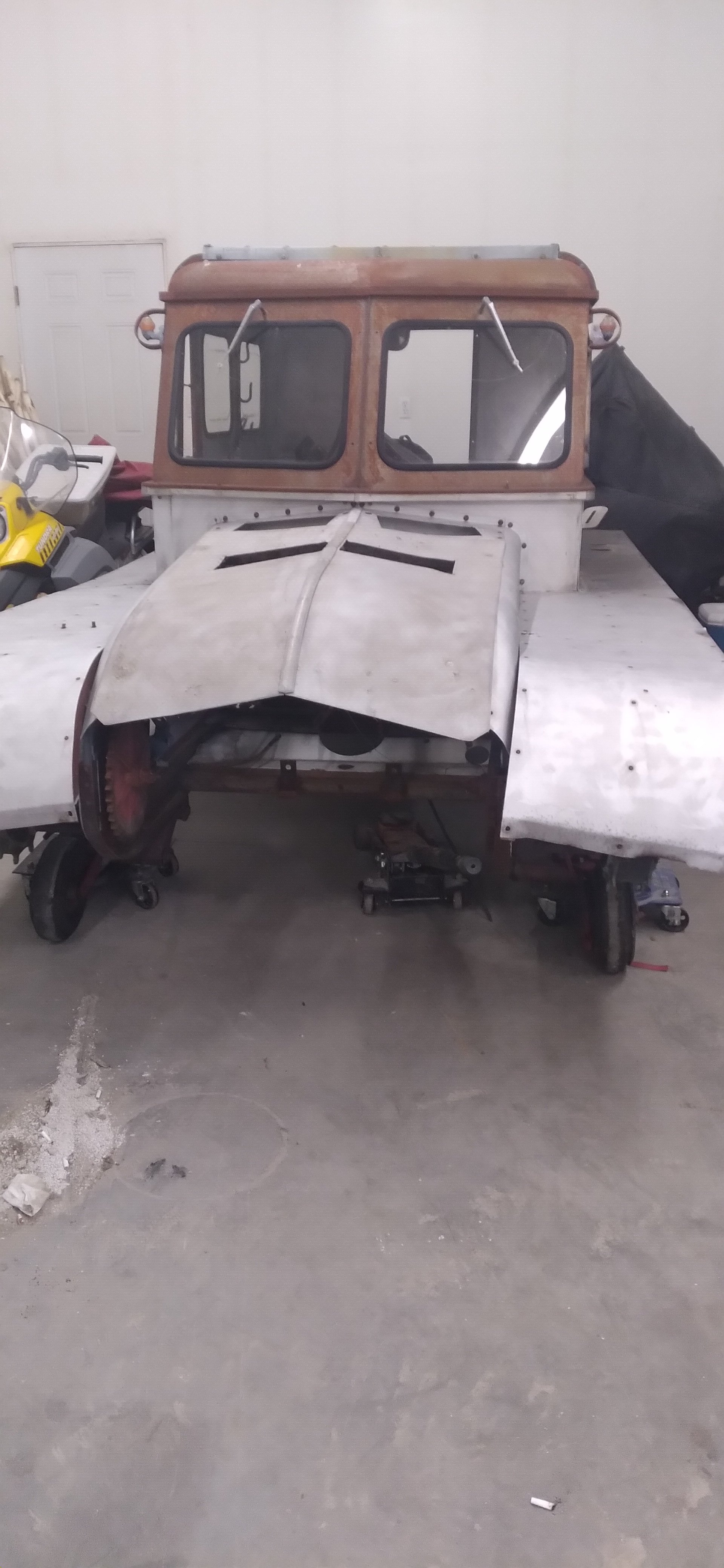

Thanks for the link. Awesome read and pics. I also work in the prudhoe bay oilfield now for 18 years. I need to finish up a couple other projects before starting on these machines but #344 is apart and soda blasted already. #205 is running and driving. Can't wait to start on these things.
