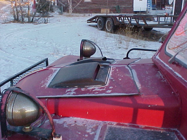

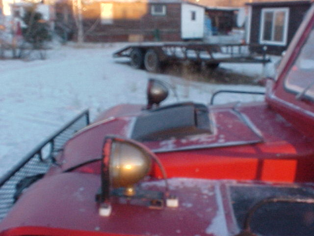

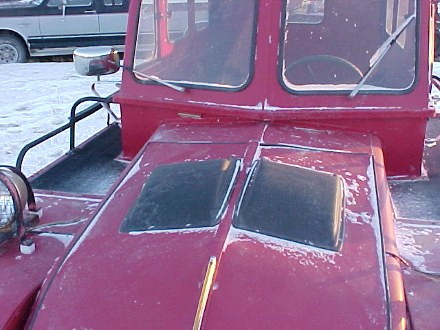

This is what I did on one of my snowtracs,but a snap on/off cover would work for the louvers that is by the windsheld.

Yes there is a rubber seal that fits between the hood and the air intake flang of the motor,the back louvers you could just cover over.I got the scoops from jc whitney.

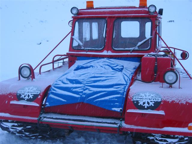

Here is my solition to keep snow and water out of the air intake louvers and variator. It is a custom fitted hood cover that I made out of coated nylon pack cloth. So far it has worked very good on the FBI Rig.

Looks great! A brassiere of sorts. Why on earth the swede's didn't come up with a better design for the hood is beyond me. They exposed all of their most vulnerable engineering to the elements.
