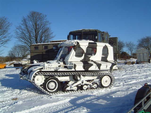

I got an email from ICE QUEEN in Wales. They actually have enough snow to run her Snow Tracs!!! :clap:
This might be the first time in the past 2 or 3 years?
I took the liberty of posting her photos for all to see :brows: I'll be going out to play a little later today, we've got 12" of snow due by the end of the day here.

It seems everyone over there is getting snow this week. Hope it lasts long enough to let her get some good runs in. Must be frustrating to have one and rarely get snow.
back a while back i was contemplating a big wheel conversion on my st-4 with a 2 band track i was looking to do something like ice queens snow trac she has the 2 band track with the big wheel any body know how this works i havn't had any more problems with the front bogies since they were gut apart abd rebuilt that front bogie does have limited travel i'm still thinking about trying it

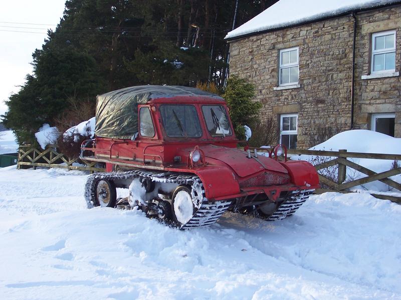

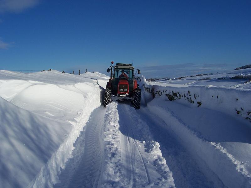

I am in north east england and we have approx 2 feet everywhere and alot of deep drifts!! shame my snow trac is in the shed waiting for parts! should get them today though.

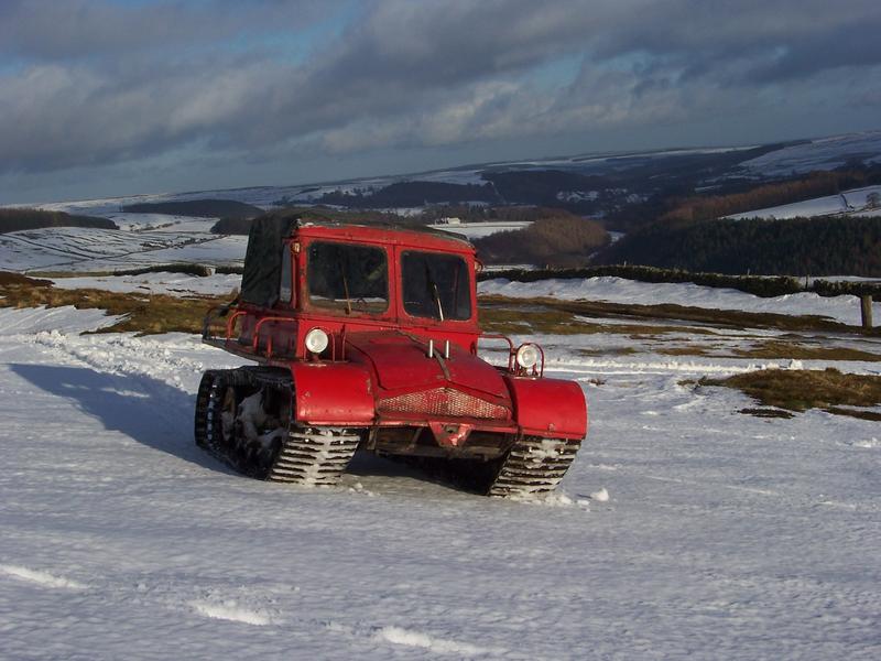

Got my new parts today to get my snow trac running so had a quick blast out, will be going on a propper run tomorrow.

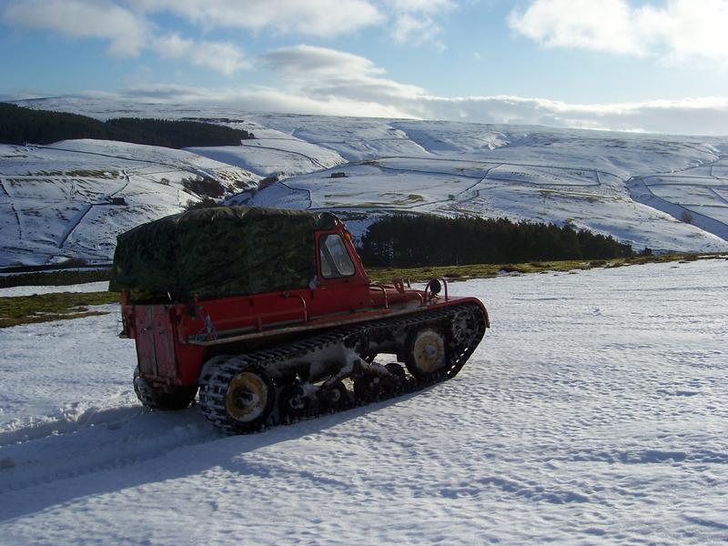

The snow is starting to melt

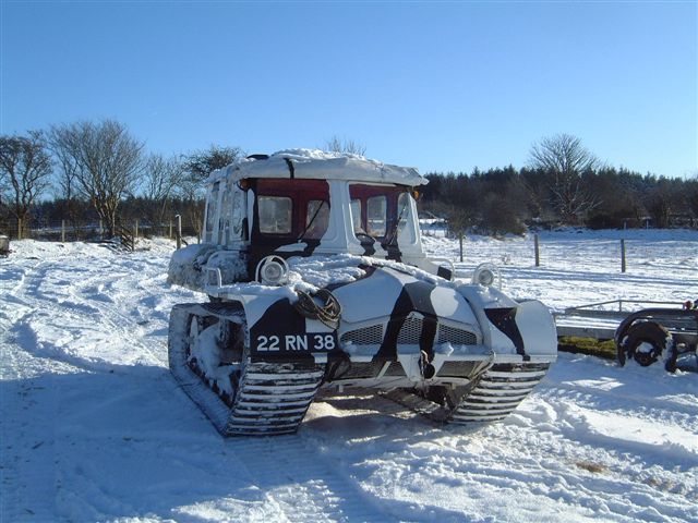

Lovely pictures John, I see yours is an ex-military snowtrac, have you any idea of its military number -- RN --?
Thanks! yes ex-military, not sure of the number though, cant find a chassis plate on it? Wasn't sure if it's located somwhere else other than on the rear of the snowtrac.
On the left hand wing, as you look from in front of the snowtrac, try carefully rubbing the paint off as that is where the RN number was painted. The plate was located on the left hand side of the dashboard - if the plate is missing, which it probably is, you should still see some tell tale holes.
