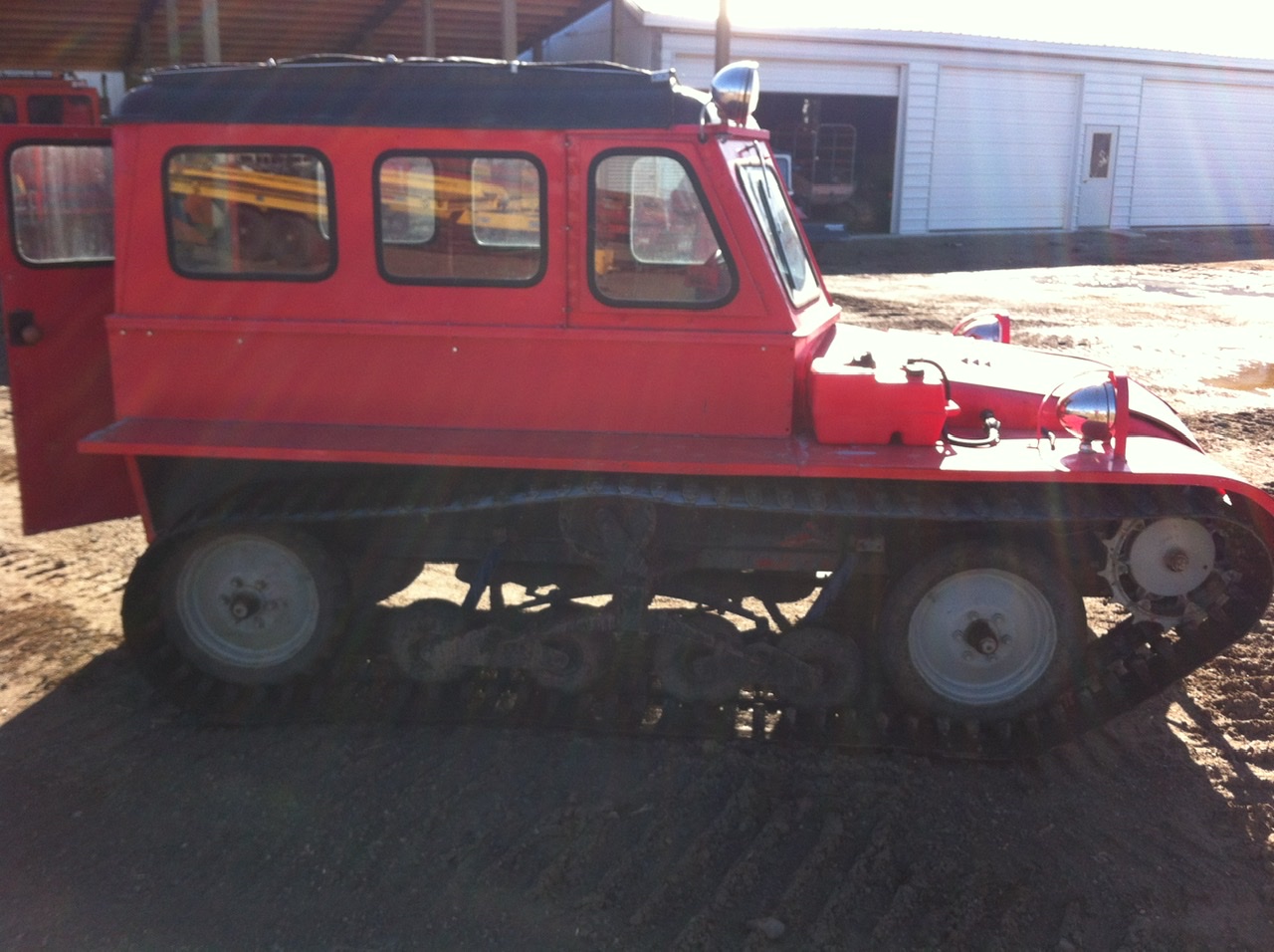

UNLESS you have a frankencat with two band, bigwheel. Then you need the scraper, but good luck mounting it. I've seen a couple one conversion and one of the MacLarty assembled ones.
Nope, our 1958 two track ,big wheel Frankencat moved to Montana

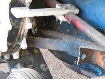

Found this thread last year after having a close call with ice buildup, so thx to 300 H&H and JmVT for the info. Needed to do SOMETHING.
Machine looks to have had something installed on left side only (the orange bracket), maybe it was for a scraper long gone. I don't trust my welding enough to place steel angle iron anywhere near the cogs, so used leftover plastic from sprocket project .
Also tried the playing card in bicycle spokes idea to scrape track underside before snow got to idler or sprocket.
