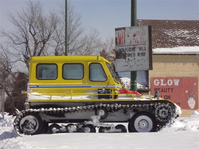

Here is a photo of a master. the motor was quite stout and I think who ever built it did a wonderful job. I am glad i had the opportunity to experience a master and found its capabilities beyond my needs here in the midwest.
Mike
PS was your super imp a wide track.. I have a wide track baby imp and find it to be capable just not as nimble or light footed.. ( our snow tends to posses some moisture)

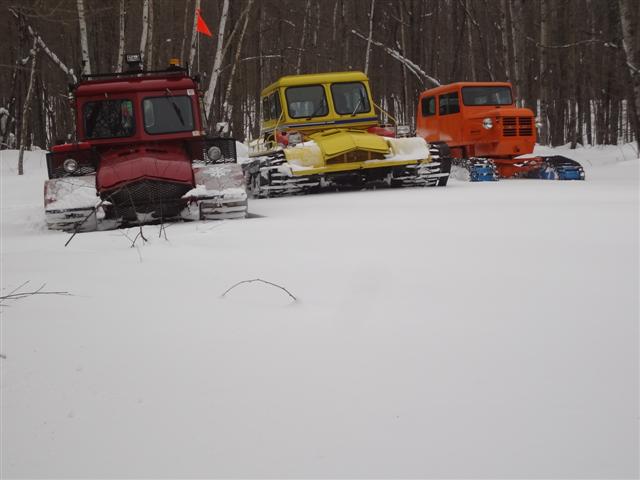

if I got the right photo, that snow bank is in excess of 6', I sunk in inches.
