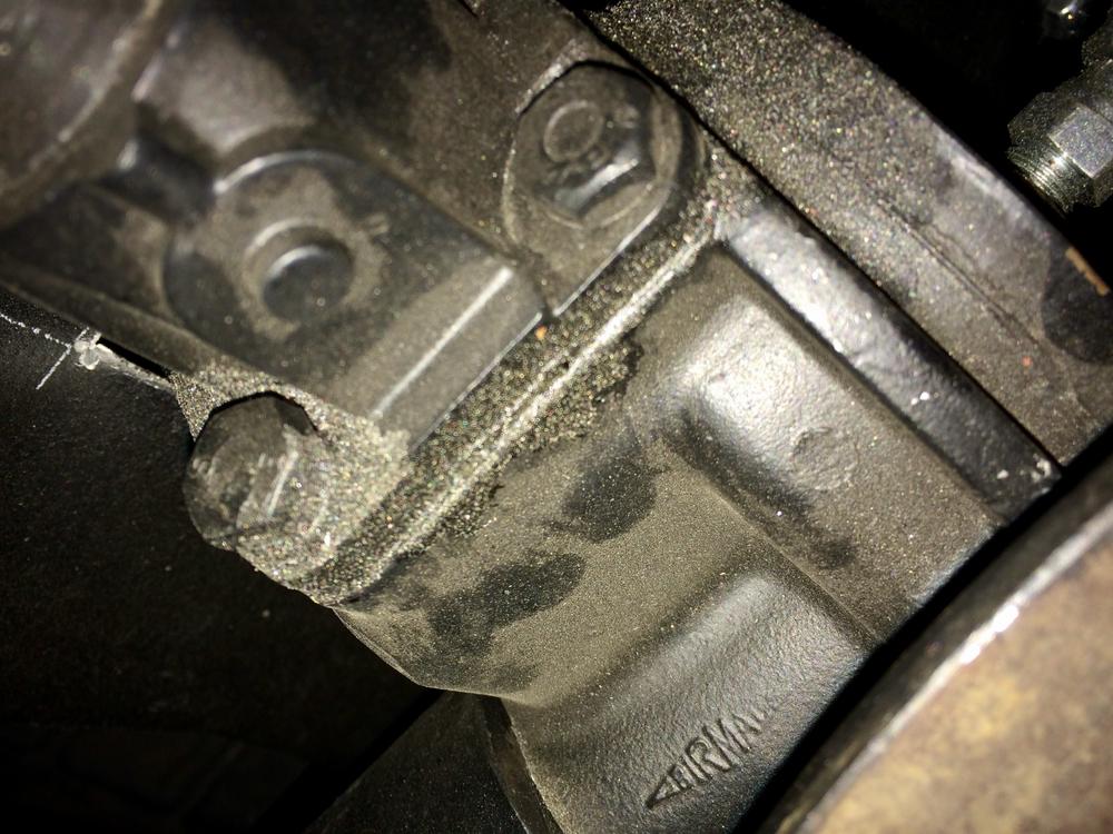

Anyone know what Snow-Tracs used in 1967? Mine doesn't look like any Volkswagen version and it has a casting mark that reads "BIRMAL". A little research finds that this may have stood for "Birmingham Alabama", or "Birmingham Aluminum", which made cast parts.
I need to rebuild mine, or find a replacement..?

my understanding was that it was a bug box, I have never compared one I do know the pre 69 models had kubel wagon steering wheels, and the later model bug wheels wont fit the shaft of the older snowtracs. this makes me think pre 65 for steering boxes . traditionally the vw parts on a snow trac were surplus from the previous year vw models.
this is a problem part... by 1966 the catalogue lists it as ST7329 and that is clearly a different part than the 1961 version which has a tag from the " Fulminawerk K.-G. Franz Muller Mannheim " and a note to use 90 Wt shell gear oil
your right i'm showing a larger steering box in yours with an st number. it must be changed to work with yours.
