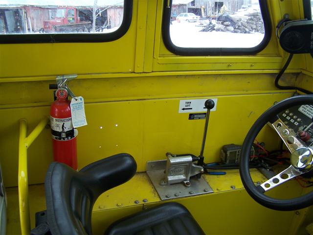

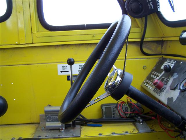

It is Springs and Shock absorbers. I snapped four photos One of the Steering Wheel relative to the dash and window ( you can see the lift kit for the roof)
then a photo from the front quarter of the seat.
Photo of the seat position relative to the window.
Photo of the Base. The Base is secured to the floor (Which is rubber covered alum) with a sandwiched style base.
There is a very comfortable amount of space about the pedals and steering wheel in this machine, I only have the Green machine to compare it to, feels as if I need to slide into position in the Green machine, Where as the Yellow machine the seat can be approched from multiple trajectorys.
Hope this helps,
FWIWorth I am refraining from busting out the sawzall on the Green machine as the interior is set up for camping with a removable seat back and drop down pads to facilitate a Full deck.
Mike

Hey does that steering brake actually work? I used to have one on my sandrail. I was thinking about possibility of putting on my snowcat.
I am still learning the machine so take this for the asking price....
I would put it in if you had it. at a minimum it could get you some control should you blow a belt or round off a Sprocket spline.... (It is a stretch but you get the idea)
As far as how well it works.
This is going to be hard to explain but here goes... If you are not turning or trying to turn, it just loads the machine and makes it twist a bit. (I assume it adds load to the belt as the belt trys to remain even torque)
If you are turning it does the same as above except the effect is felt more. firmer the snow, more you feel it. when in fluffy loose dry snow and the outside-of-the-turn track is spinning the Brake does nothing noticable.
Useless note here....
The machine has a hydraulinc line lock for e-brake and the cutting Brake must be ahead of it. (Plumbing wise) as the brake locks both tracks
Hope that helps, Kirk may have played with it he may have some input, back on track with the seat that seat is very nice. I am strugling to find a tag. the adjustments are in Kilo-grams....
