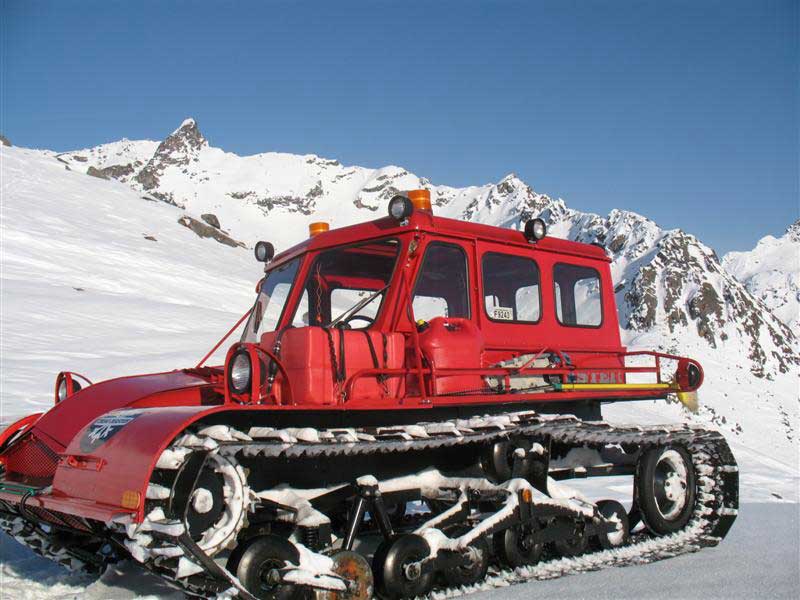

I assume a ST 4 is the smaller unit with less boggie wheels?
What are the differences in the two models or were there other models I am not aware of ?
first pic is a ST 4.... right? VW
second pic ........?

The 2nd pic is a wide track, well traveled Snow Master with very low hours, only a few miles and in extremely good condition. It has been in Oregon, Washington, Wyoming and now Alasaka................:thumb:
Search FBI rig in the FF search and see a history of this unique snow cat. The seats are filled with money according to Boggie............ or were....:yum: It now belongs to FF member Teledawg in Alaska..........:thumb:
The Snow Tracs and Snow Masters are the same size length wise. The diffrence are the track widths. I believe the Snow Tracs have 18" wide tracks while the Smow Masters and Trac Masters have 32" wide tracks. The diffrence in number of tires or bogies is mainly the year. The older versions have extra smaller tires in place of the larger front tire. There are some minor diffrences on specailty units but those are not the norm.
The Trac Masters and Snow Master did have a bit longer tracks but the bodies were the same. The Track and Snow Masters had an extra small bogie as seen in the above pictures of the FBI rig. The diffrence between the Track Master and Snow Master is that the two front smaller tires were replaced with one larger diameter tire It typically the same size as the larger rear tire. Did this help?

There were 2 basic models. The Snow Trac (mine is your first photo) and the Snow Master (Lyndon's FBI rid in your second photo). Arguably those are two of the most famous machines known to exist. A TV restoration was done by BBC's SALVAGE SQUAD show on mine, and the FBI rig participated in the famous DB COOPER manhunt.
Of those 2 basic models there were a few differences as they evolved.
With regards to SNOW TRACs, mine is commonly called a "big wheel" Snow Trac, it features a large boggie wheel in the front and in the rear. This is the standard configuration for all the later years of production. Early production years featured "small wheels" in the front with only 1 big wheel, in the rear. There were also some slight changes to the tracks, earlier models were 2 belt, later models were 3 belt. Grousers also changed over time. The interior configuration remained pretty much the same, as many parts are surplus VW parts, there were minor changes, substitutions over the years, but the basic shell was pretty much unchanged as well as the basic interior. One noted difference was the drivers seat, early models differed from later models.
What is generically called the SNOW MASTER now, was originally called the TRAC MASTER. As noted above the tracks are both wider and longer than the Snow Trac. The TRAC MASTER designation change to SNOW MASTER seems to be more for the sake of whim than anything else, not much really was different between the two. The Snow Master was more of a workhorse than the narrow track Snow Trac, it also featured optional hydraulics so the operator could control grooming equipment for ski slope maintenance.
All models of Snow Trac, Trac Master and Snow Master were available with the standard cabin that seats 7 people. Short cabin variations were also available that seated 2 inside and 4 outside/cargo outside. Other versions, typified by some of the military variants had a canvas back/top with the traditional windscreen. All of these used the same basic mechanicals except the military versions. The military used 24volt electric systems instead of 12 volt. Military models also had 'helicopter hooks' so they could be transported easily by crane or helicopter.
Antarctic versions were also made for ANARE. Some of those were equipped with a Porsche industrial engine. Some also had a reverse slope windscreen cabin that I've only seen on ANARE special models. These special cabins were apparently custom built in Australia before being transported to Antarctica.
