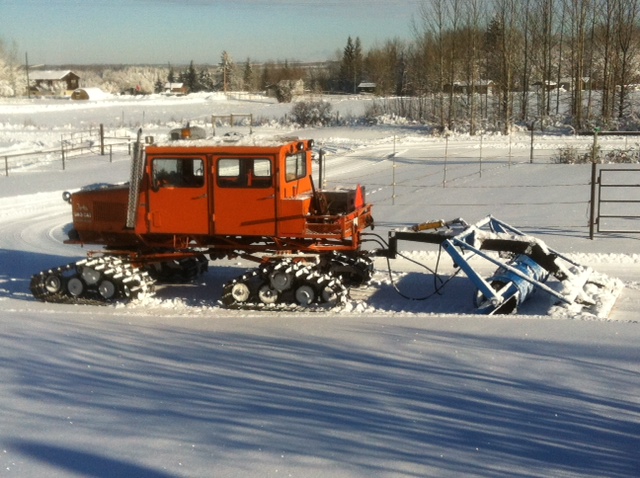

I built mine from a piece of an old loader frame, a piece of pipe & an old packer bar. I can lift the packer bar by pushing the roller down with hydralics

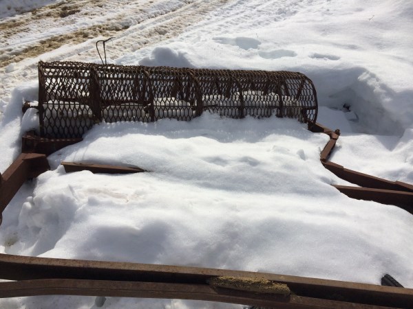

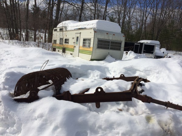

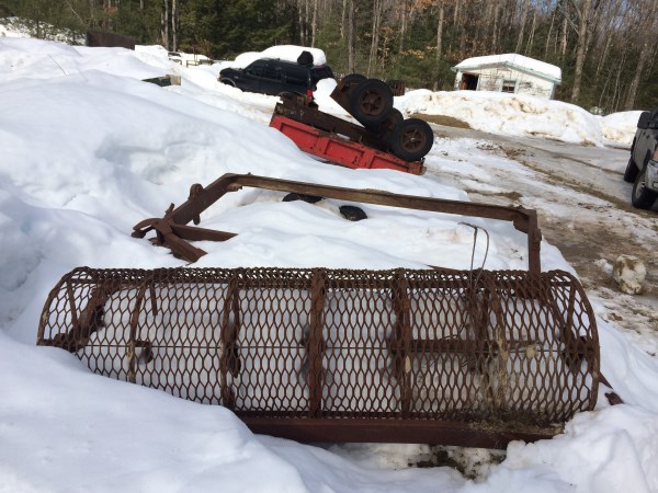

Had the pleasure of meeting a local Forum Member and we worked out a deal on the roller. I like how it is vintage and period correct for my tucker.

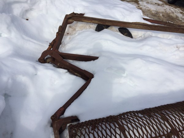

As you can see it had another roller on it at some point and the design unhinged on one side so the rear roller was offset? Not sure how this worked?
Will be a good base. Will either modify to use the single roller or maybe add some cutters to the front? Thinking about just using this one as roller and modifying the pan drag I already have.
Next step is to get it home at some point.

It's an old Valley Engineering Powder Maker. It offsets so the drums scuff up "powder". Sort of a pre-tiller machine.
They roll nicely, but they don't work for packing wet snow, at least. The drum fills with snow/ice and can be a pain. At least that's been my experience.
My culvert roller has worked WAY better at building a base, IMHO.
edit: ps it may have had a hydraulically raised barge-board scraper ahead of the roller to level off bumps. Mine did.
I'd love to find one of those - we get a lot of freeze/thaw/freeze here and my trail some times winds up looking and feeling like a skating rink - it wouldn't work as a packer but it would sure improve an icy trail
Maybe adding a culvert roller to hook in where the bearing mounts are, to pack the snow down and let the screen roller finish it up with a powder scuff? Or would the rear roller still load up?
Lots of questions. Last night went out to groom up and it was concrete ice. Need to rig up something. It will at the minimum be a good base to modify or will look nice just sitting in my back yard!
I can only speak from my own limited experiences. I'm no pro at grooming. I'm a skier. Downhill. Five years ago, I started running a rope tow on my farm and learning by trial and error what works or doesn't.
It seems like the screen roller loads up in wet snow, no matter what. They work nicely on hard-pack or icy surfaces, but I don't even bother to run it in packable snow.
For packable snow, I just use the culvert roller, with or without a chain-link drag.
It seems to me that you really need to have both types, at least for what I'm doing.
