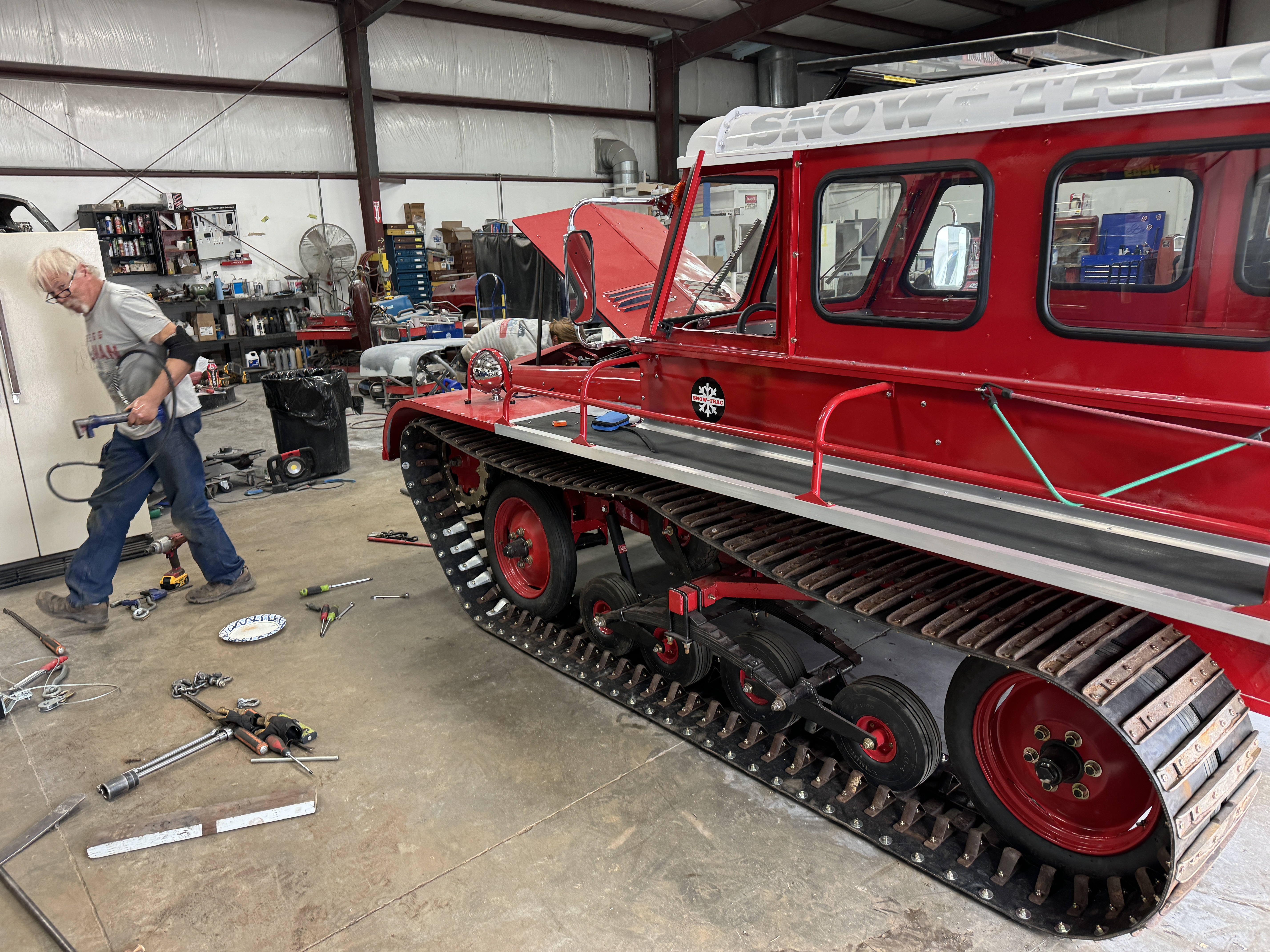

I bought 8 of these: SKU: TK70918693 4.00-4/2.50 Rib Trelleborg Black Kargo Rubber Kargo Solid Pneumatic (2.50 Standard Rim) from Cascadia Tire in Burnaby B.C. They were very helpful.
Because they are 2.5" wide, I had to buy eight new wheels from Carefree Tire in California: 4" x 2.50", 3 Piece Rim - WHITE Color FOR SOLID TIRES W2162-41212
