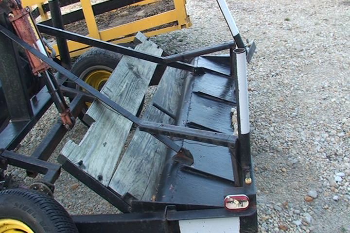

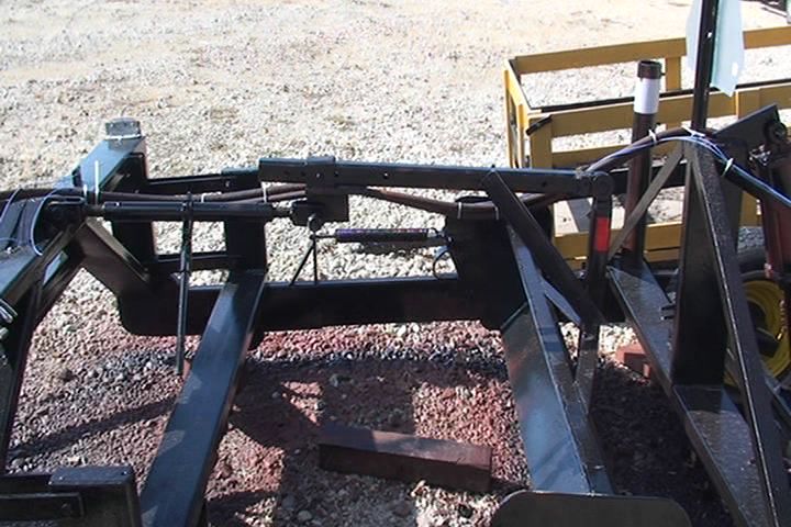

"Soon" for pictures has turned into later, but here they are: There is a "before" as you can probably tell. The drag had a bend in the side rails I attempted to straighten, it needed new material for the rear leveling portion (used two thicknesses of 3/4 inch plywood), the hydraulic cylinder controlling the tension on the blade had been bent and the hydraulic system I added to my SkiDozer only had two outlets, so I modified that linkage using an adjustable slide plus a ratchet-operated extender.
The drag is painted and I've replaced all the lights including flashing ambers to the rear and clearance red and amber on the sides. In addition, it came with lots of white reflective tape.
We got some snow flurries here in southern Minnesota yesterday, so I guess I got the "bug" for getting the machines ready for grooming some trails.
