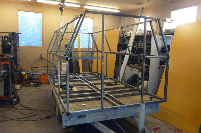

Here a photo of my project.
I made a frame for my sleigh.
The floor is 3.6 meters by 1.8 and the hight is 1.8
The sides are to be made from aluminium and plexiglass.
Inside the people sit back to back on some bench.
I will put a big webasto heater so nicely warm inside.
I hope to fit 8 to 10 passengers and then all of us hope we still move.
I think we do.
against me; The technical papers where you can read that a snow trac is allowed to pull 500 kg.
My machine is not a trac master or a snow master. and of course the over heating........
But, I drive only hard trac, no deep snow and no real uphills.
I go slowwwww, the people want to see something.
My snow trac has a 1600cc engine.
Christer morlind does the same thing and he pulls a sleigh with old couchseats and 12 people (or more)....uphill.
I saw on a picture from a guy from austria here on the forum a sleigh about the same size as mine. (at least i think it was a sleigh)
well we see...
i will keep you informed.
anyway we still have no snow.

Keep the weight down as much as possible. Remember in the lower gears pulling, the high torque loads this generates. Drive spockets will need have an eye kept on them. 12 people at 150lb is 1,800 lb plus the weight of the sleigh. 2,500lbs would make me a little reluctant to pull with mine, even on the level. Add the 2,400 for the snow trac and you see what I mean? Not sayin it won't work, just some thought should be applied as you do...5K is alot of weight to be out in deep snow with....Or in metric measure the sleigh is 1,500 kg. way more than the tow rating.
Remeber Christer has lots of parts!
Best regards, Kirk
i would have no problem pulling it with a snow trac a brake steer rig may have problems with that kind of weight if the tow vehicle isn't large enough
Have fun

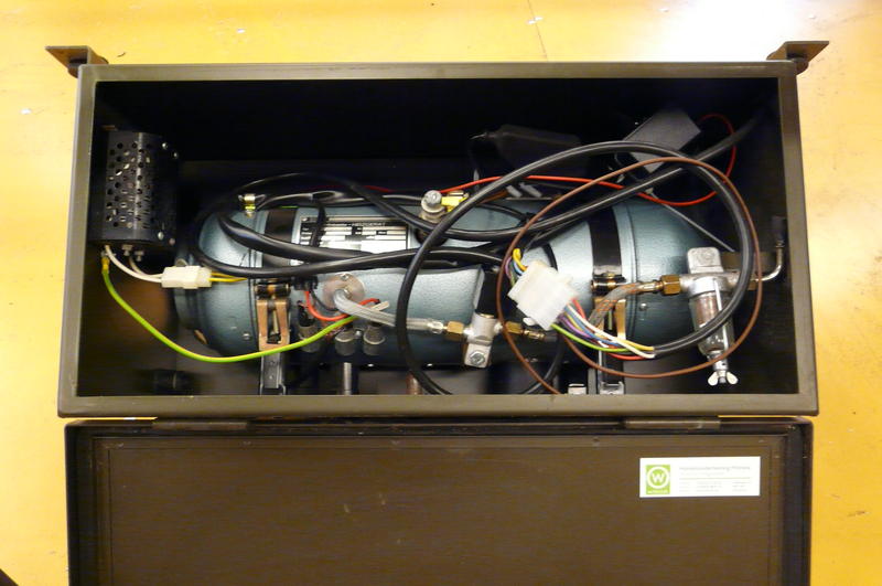

here is the webasto i'm gonna put to warm the sleigh.
it needs 24 v so i need to change from 12 to 24.
it is old dutch army, but this one is like new.
i tested it and in a few seconds there comes 100 celsius air.
so my passangers are gonna be warm !
i will put the sleigh on the scale when it is ready, so i know what i'm pulling.
