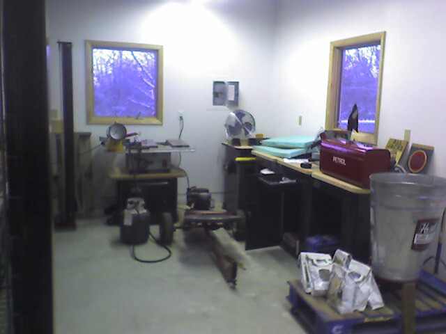

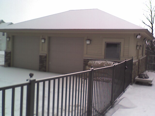

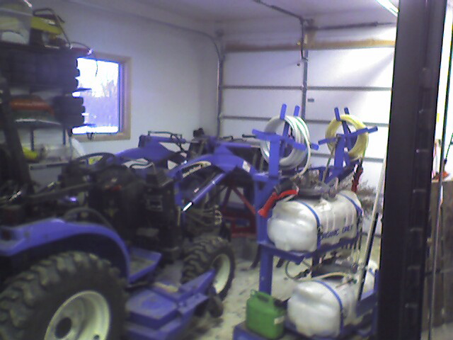

Mine is 24 by 32. It was specifically built to look like a standard garage so it blends in with the property. Funny thing was I priced out a "Morton" building and the prices for that was within 1% of the price of a stick built, brick and cedar garage with insulation & drywall. I suspect as building sizes go up there might be a price advantage to the steel buildings???
Should have been much bigger. I thought I as building a big shop, ended up cramped. I have 3 garage doors, but 2 are arranged so I can drive straight through the shop from front to back, and 2 are side by side on the front wall. The garage doors are 8' tall x 9' wide, which is plenty of room to get cars or tractors in, but not big enough for campers (which I don't own).
The "working" area with workbenches is 24' by 10' adjacent to the bays. The center bay as a 4 post car lift and the ceiling above that lift is elevated so I double stack cars. I find that the floor area of the working area is often filled with tractor implements. If I had made the shop 28' by 32' there would have been enough room at the end of the bays to easily store the additional implements. I may end up building an equipment "run in shed" for some of the lesser used implements? Not this year, as the crutches already have me behind on projects! One of my goals for this summer is clean out our attached garage to make more space there and then move some stuff from the workshop to the attached garage. That will probably require moving some things to the trash pile, other things may be put into the attic?
But even if I had built a 40 x 60 shop, I'd probably be complaining that I didn't have enough room. I think we all tend to fill the space we have.
There are 5 windows in that let in a lot of light, and if working in the evening they let in a nice breeze even if the garage doors are down. The windows have screens to keep the biting bugs out while I work inside. The shop is also air conditioned. There is an attic storage area above part of the garage, it can be easily accessed by loading things onto the car lift and raising it up.
I think all these photos have been posted before. The shop sits "outside" of our dog fence so the dogs can come to the shop and still be behind the fence but I can drive into and out of the garage without having to go through any gates. There is a concrete pad in front of the 2 garage doors, but there is no driveway to get to the garage so I drive on the grass to get to it. I'm not sure if I will ever pave a driveway, the only time I need it is if I need to move a car after a heavy-soaking rain. But really there is not much traffic in/out of the garage so its not a big deal.

Nice work shop. I have seen pictures from inside but not like all these here. Looks like a pretty good design. When I finally build my garage I will go deeper and wider for sure. I am thinking either 28x32 or 32x36. I need really tall doors to clear any snowcats on trailer or riding piggy back on my truck. LYNDON has a very well thought out garage that even had a pretty cool over head hoist system. I know I will have a over head hoist and a seperate area where I can paint. I will build this section just like a modern day paint booth. I have a person looking into this for me. I also want to build an outside area dedicated for pressure washing. sealed concrete pad with a big metal grate to catch the grease and oil and general crap. This will also be used to wash off all the dirt bikes and various off road vehicles that tend to get cacked in mud not to mention my snowcats.
