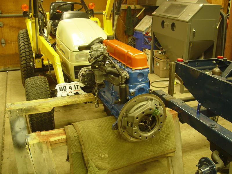

I have a Scat Blast White Lightning that's a siphen feed cabinet. It's just big enough to do pick-up rims and such, but nothing bigger. The advantage of the siphen cabinet is the lack of dust in the air (no respirator) and it re-circulates the media. The majority of the pressure systems that I've seen are just the opposite and used primarily outdoors on larger pieces of equipment.

The siphon feed is a cabinet that you seen in my shop, I can't remember who makes it but I'm sure it's much like DDS and Mtn-Track has. The most important thing you should consider in a cabinet is that it has welded seems as opposed to bolted together seams because they will leak sand. Like Don says you WILL NEED a light and a Vac. system, if no Vac system it gets really hard to see through the dust and the dust WILL end up in your shop. Your compressor "should" be ok with the smallest tip you can get, a blast cabinet will use MUCH more air than a paint gun, so don't use that as a comparison. I use a 5 hp with 80 gal BUT I have seen 5 hp compressors with a motor the size of a cantolope (the fruit) and my 5 hp is the size of a Watermelon and has three capacitors and requires a magnetic starter, so I guess I don't know how they rate hp. in a electric motor when one can be so much bigger than the other and both be the same hp.

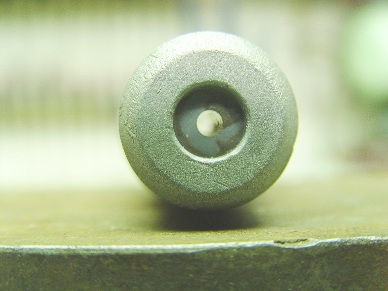

BlackFoot brings up a good point, I also use carbide nozzles they probably last 10 times as long as ceramics. As ceramic wares out, your tip opening gets bigger & bigger there-for, your compressor can't build up enough pressure fast enough. I think I use a 5/32 tip opening.

The ceramic nozzles do tend to wear rather quickly and really lose there efficiency and put a real test to the compressor. I run my 80 gal 5hp compressor at 150 psi and draw the sand blasting cabinet at 95 psi. As the nozzles wears the compressors runs and runs and runs just like the bunny. I have found it very difficult to find nozzles let it be a carbide nozzle for my blasting gun. The siphon type cabinet works great but spend on the unit to get a good light, ventilation/filtration, and good door access...My two cents thanks to schooling from Weatherby!!!
