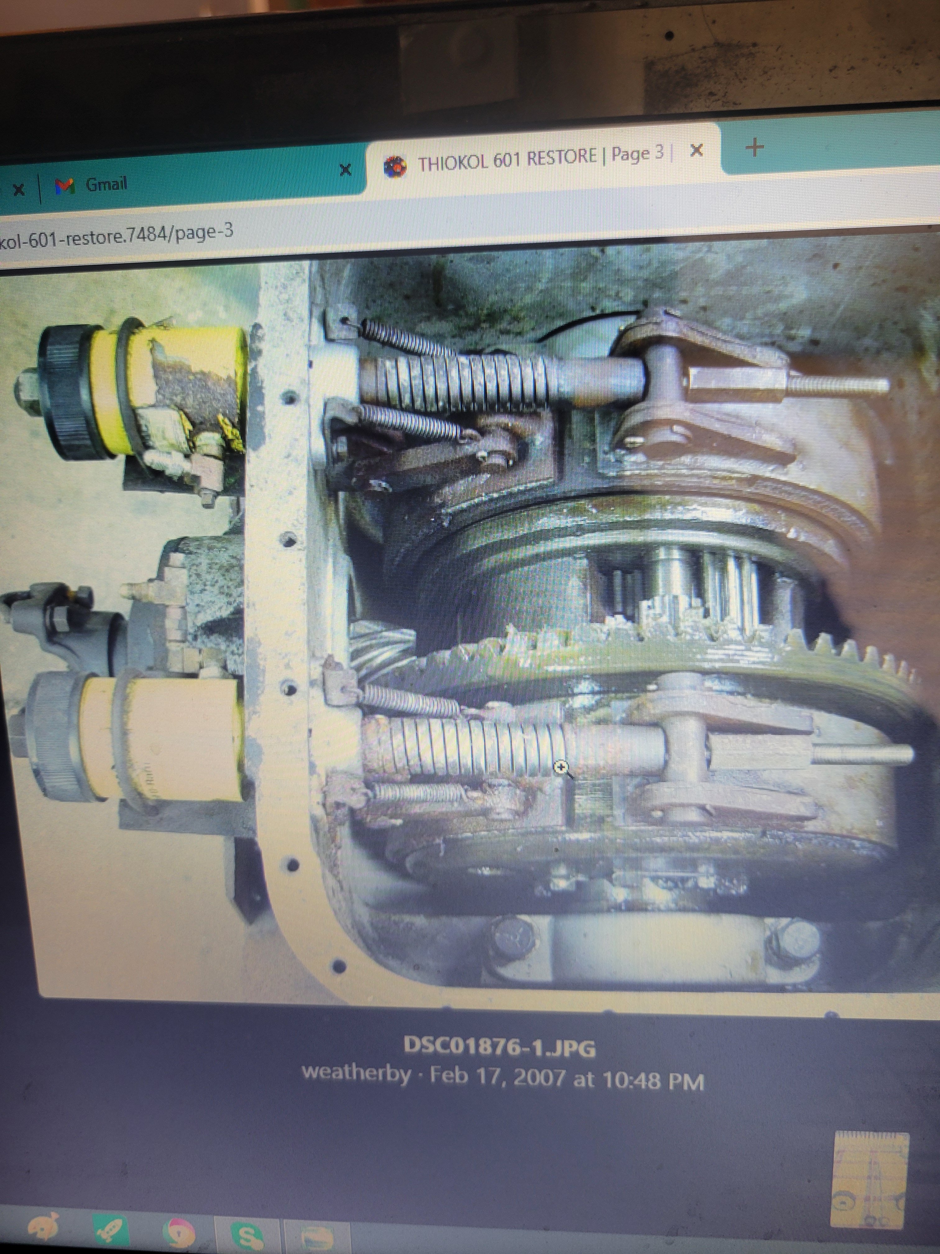

I blew the brake line that goes to the left slave cylinder on my Thiokol 601. I have a new line made up just waiting for warmer weather to do the work. After I replace this how do I adjust the brake bands on the OC15 differential? There are big nuts on the ends of the slaves. The steering wasn't bad before the line went, but I think it could be better.
Pull the OC-15 top cover and you'll see where the rod goes through the band connection and has an adjusting nut.
