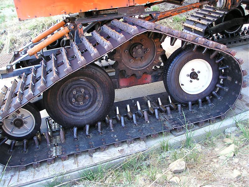

OK, so why would I have three flat tires on the same tire in one season? The tire was bought new last season and is in good shape. It has a tube. It was flat in November as I was getting my Tucker ready for the season. Got it fixed. Then it went flat in December. Curses, took it off and took it to where I bought the tire and expressed my disappointment. They assured me that it was some junk left in the tire, and that they cleaned it out and put in a new tube. It is flat again in late January. Now I am seriously p.o.'d.
Could I be the problem? Could I be overinflating it and causing the valve failure? (that seems to be the source of the present leak). Any suggestions welcome! Photo of the non-stock track system attached.k
