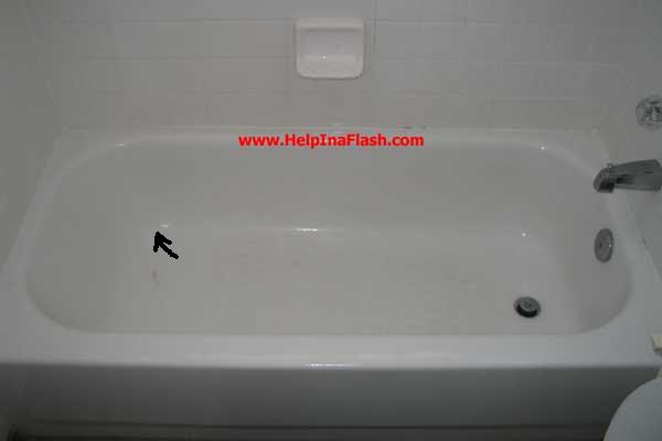

I found a pic of a tub to illustrate.
It's sort of right where the bottom of the tub begins to slope up.
I suspect when I crashed, it cracked then. :doh:
That would be a hard place to do the patch if you aren't into glass work then, and it should be done on the outside to give it strength so it won't crack again, then a filler should be used inside with a gel coat of the same color.
I would either get a new tub, or get an insert for it.
Pretty cheap tub, or you really hit hard... which would be a good Ouchie...
Most of the repairs we have suggested are going to be mute since that is where the bottom is "Suspended" from the sides. So fixing it from the "Outside" (water side) is going to be mostly a waste of time.
