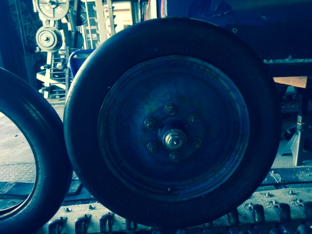

there must be at least 6 coats of paint on this track-master. Would be nice to hear all the stories. Napa had the bearings, thanks for the #'s. I got two tires from Alpine Tire in Idaho. Great service once I got in contact with the salesman. I have taken the tires to two different tire shops and they keep popping the tubes. I got 6 ply 4.5 x 16 and they are telling me the tires are too stiff for them to get the tube without puncturing the tube. Question: Any drawbacks to just foam filling the rear tires at this point. I have already foam filled the other ones. Bearings are all replaced, everything is a go at this point, just need tires. Thanks again for all the great advice.
a couple drawbacks are is extra weight and they have to be cut to remove.
are you happy with the size? are the others alpine?
jim
not sure where Peterson got the other tires. They said they couldn't find the rear tires. Tires look a little bigger and definitley weigh more. I am not concerned about the added weight. At this point just want to get this project done and take my wife and kids for a ride before all the snow melts.

Those look pretty good.
I have the big wheel version and both tires are foam filled, fronts and rears and they seem indestructible. I don' t know any better but wonder how much the extra weight really matters?

good to hear. Now just need to locate someone who foam fills tires in the SLC area. These rims look like they have been used and abused over the years. Is there a straight across conversion for a new rim or would I have to replace the hub as well?
Thanks
-K
On my older st4 the flange on the hub that has the bolt pattern is just pressed on. Maybe so you can change bolt patterns??
you have the 6 bolt wheels and hubs with flanged nuts .I wouldn't change a thing if you want them to look better sand blast them and paint them.

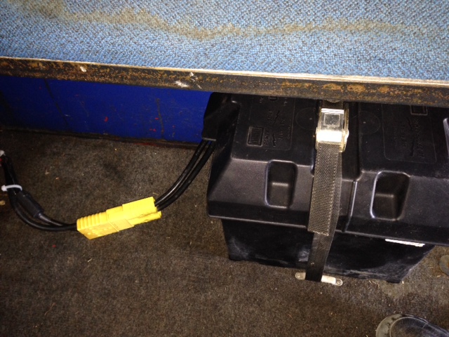

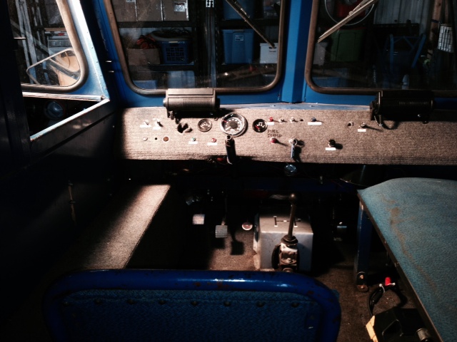

Almost done with the interior. Just need to finish the cable management. I put in the quick disconnect for the battery. All devices are working at this point with the exception of the tachometer. Cleaned up the flange on the steering wheel. I pick up some aluminum plate and patch the holes in the dash this week.
