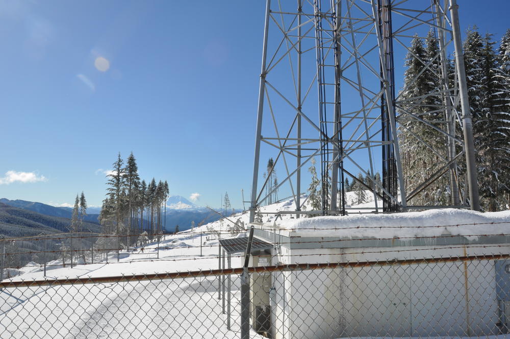

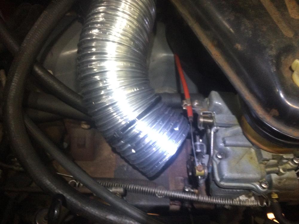

Today I ran a radio tech up to one of our repeater sites near North Bend to make a minor repair. We only needed to go about 5 miles but there is 3-4 feet of fresh powder up there. It was quite warm but the weather was stunning. Yesterday I added a small bilge blower in an attempt to keep the carb cool and prevent the vapor locking. It helped but when I left it running to cut a downed tree it still stumbled and stalled twice after we were done cutting. But it was warm out and I had been driving up a steep hill with the throttle wide open for some time.

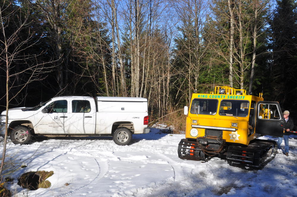

Not was, still is. We use it primarily for search and rescue. Or runs to the mountain top radio sites. Last winter I made four trips for radio repairs.
It came to us via the 1033 program. The Navy had it and surplussed it. We got it for free. It's a 1988 LMC1200. Had about 280 hours on it. About 350 now. It's in pretty nice shape for a 30 year old cat.

I have put my hand on the carb and it's hot to the touch. So I'm thinking vapor lock. But I like your theory.
I think a small piece of sheet steel mounted between the carb and manifold as a heat shield would help. My guess is fuel is boiling in the carb, as the radiant heat is heating the base and body of your carb.. Gasoline now days I fell boils at a lower point that the fuel of years ago. Maybe E10 is at fault here? I think it boils at a lower temp, due to the alcohol. Seems like I have seen this heat shield on a Thiokol at some point in the past few years.. Maybe here on the forum, I just don't remember, but I thought it was a factory deal. I have seen this set up on a 300 Ford in an industrial application, an enclosed trailer type air compressor.
I hope you find a cure for this gremlin in your machine.

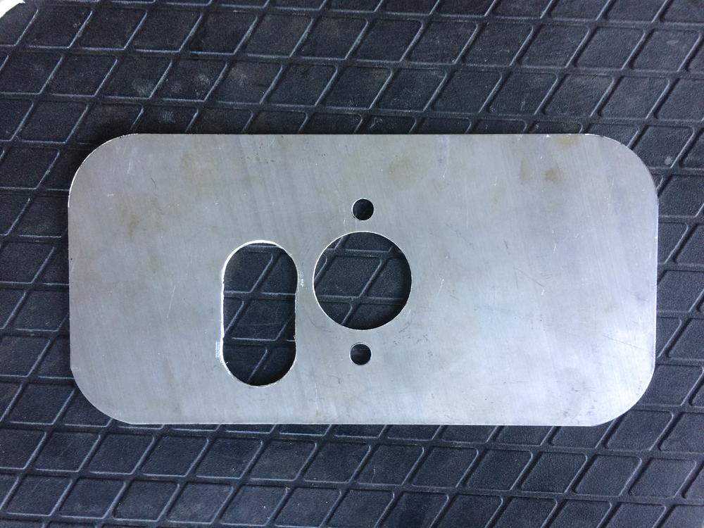

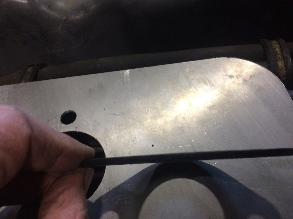

Today I brought in some tools from home and crafted a heat shield. I had some 6x12 plates of aluminum to work with. I used a hole saw, drill bits, hack saw and a file. The new base gasket is much thicker too. I had to get longer studs. I think it looks pretty good. Engine runs fine. I am hoping to try it out on Friday. We still have a lot of snow on the 70 road for a trip up to the meadows.
