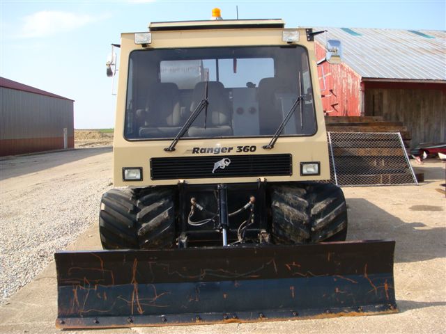

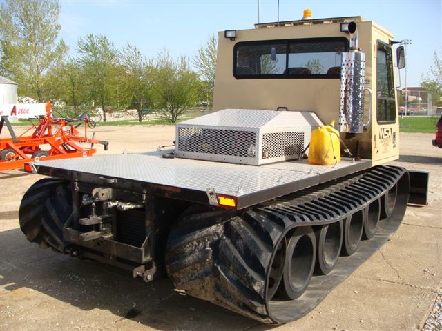

The Ram Ranger is a Diesel powered snow cat that looks very much like a Ski Dozer. Ram, it's maker is no longer in business. Fully hydrostatic with electric/hydrolic controls on one stick. Appears to be as new. It has one piece camoplast rubber tracks. Still trying to figure out a way to get the pics here from my e mail......

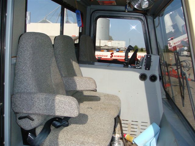

Thanks for posting the pictures muleman. Don, we have no blue print of this "prototype" rig. The company that made it also was primarly making rubber tracks, and they built this to use their own tracks. Some where along the way they went belly up. My gut feeling is that we run not walk away from this..... The steering wheel just adds to my worries about the hydrolic system and what might have to be done. Two sticks and it's relatively simple, two seperate circuts, one for each track. Add a wheel for steering and the water getts muddy...
Besides if we wre successfull in pulling this off, damage a track and we're done. No replacement anything for this rig. Every breakdown will require fabbing up new parts, or getting them from the manufacturer:hammer:

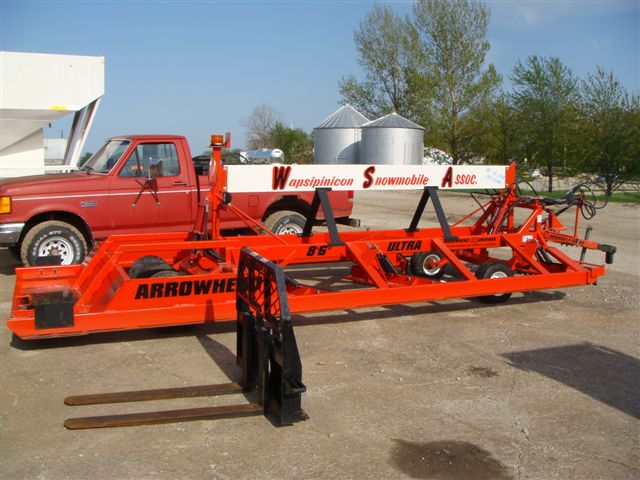

By the way the drag is behind the tractor in one or two of the pictures. It is a BIG drag, and we wonder if this might also be a part of the problem. Perhaps it has the engine horse power, but the hydro system is sized to small for the HP and the load. This would quickly lead to over heating. It was also stated turning performance was poor, perhaps this is also a poorly chosen drag causing this as well. If muleman reads this perhaps he might post a pic of the drag.
Nice looking rig.....but....
Regards, Kirk
:doh:Ooooo....those arrowhead drags. We have an 8 ft arrowhead and it pulls hard and leaves a crappy trail behind. Our 10fter drag hauls much easier and leaves a much nicer trail behind. I find that we had way more hydraulic problems when we were using the arrowhead. It's got allot of extra weight toward the front of the drag with the front wheel assemblies and is harder on the hydraulic pumps I find.

It has 150 HP Cummins dieseel and about $20,000 was spent on it back a decade ago, and still issues. Basically sat since then. The groomer pictured is not for this machine as it turns out, and the correct one is smaller.

I agree two sticks that are mechanically linked to the pumps is a simpler system but all the steering wheel or "electric" sticks are doing is sending electrical signals to the pumps, usually through a micro processor, and when working correctly are a little more comfortable to drive IMO.

It's hard for the oil cooler to get air, because the tilting cab comes down right smack in front of it...:whistling:The temp loss across the cooler is 0! It's like it is, not even the system. With no load oil temps come up to 180+ pretty fast. Our first thought is to add another large oil cooler to the deck in back of the cab, with an electric fan for air flow. We'd just leave the old one in place, for now untill we get the oil cooled down with an auxillary cooler.
The rest of theis machine looks very good. Sunstran made the steering and the electronically controlled hydro pumps, and they are 40 miles away in Ames. We have got a engineer with them who is working on the bugs in this system. This just might not be that difficult, and with a little luck we will have two groomers this year on our 90+ miles of trails.
