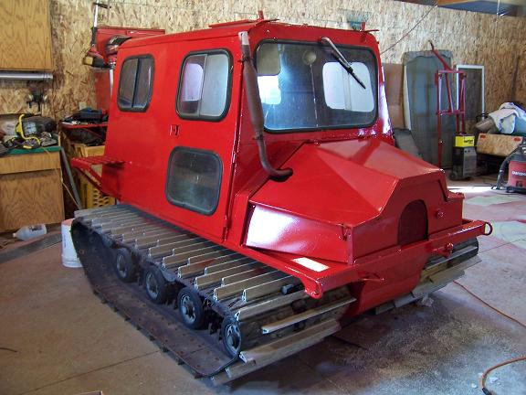

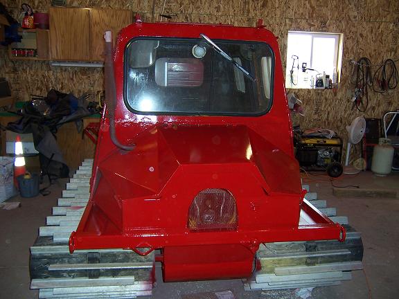

It is a mechanical steer model, it has a 40 hp gas engine in it. It has the drive sprockets on the front. I am in the process of fixing it up. Paint interior ect. I have pics have not figured how to post them to large of file it says???? The engine is up front.
Here I think i got it!!

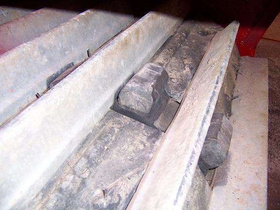

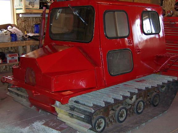

Here is a couple more. If anyone sees anything wrong with it let me know.:wave: better to fix now than have to walk out???:wave: Please excuse the mess My wife has not cleaned the shop lately. HA HA

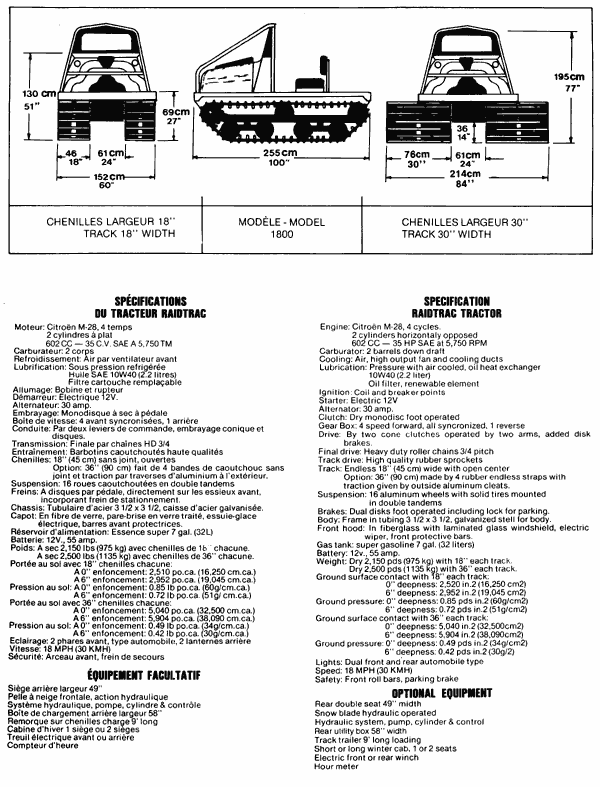

Here is the spec sheet. any concerns please voice your opinion???

I like it:cool2: though I know little about it.
It would seem a little short on power to me. and wouldn't the short length be an issue for climbing, especially a ledge or log? looks like you could stand it up on the ass-end pretty easily
:myopinion:
:snow_smi:
It sort of looks like a mini-Bombi but the Bombi has a mid-mount engine and this is a front moutn. The overall layout seems to be fairly similar to my Snow Trac. Front engine, front sprocket pulling the tracks. The overall size is fairly short, a full 2' shorter than a Snow Trac so it might stand up on its rear end if going over some large object, but I suspect the operator would back down before going over!!! But it does look tall for its length, again compared to my Snow Trac it is a few inches taller in height, 2' shorter in length, and 10" wider.
The cabin sure looks like it pretty small, not sure I'd want to shoehorn 7 people into that, but is also looks like its more modern than my Snow Trac.
I'd bet it is a lot of fun to play with, and with those wide tracks it should float on the fluffy powder snow with ease.
As for the 40hp being light on power, I would suspect that it has plenty. If it was a hydraulic steer it would need lot more power because hydraulic steering consume a huge amount of power. My Snow Trac has a VW engine in it, those are not known for excessive amounts of testosterone, but it gets up steep grades as well or better than most other brands of snowcats. The key is that the steering is not robbing power so the power can go to the tracks.
