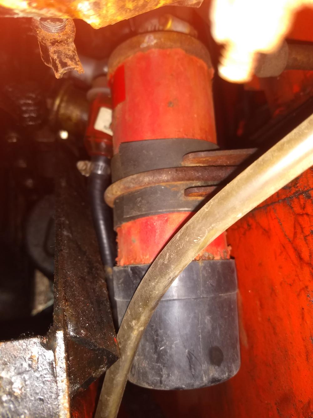

Also curious what this is:

I received the circulation heater and despite it being the same make and model it was not a drop in replacement. The new one has what appears to be an unpainted cast aluminum body with some wings for screws to hold the bottom quarter section to the top three quarters. These wings get in the way between the body and the angled motor mount. After 3 hours of trying it in various heights in the U-bolt that holds it to the body I found the sweet spot which allows you to get it in and have about 2mm of clearance on the motor mount side and the wing. I had to put it about an inch lower than the original one and there was just enough hose after some moving around of the two hoses to connect to it. A total pain in the arse but well worth it once in and the newer one looks higher quality than the old one. At 2 celcius it brings the engine block up to operating temperature in about 12 minutes.
This is what the new one looks like:
