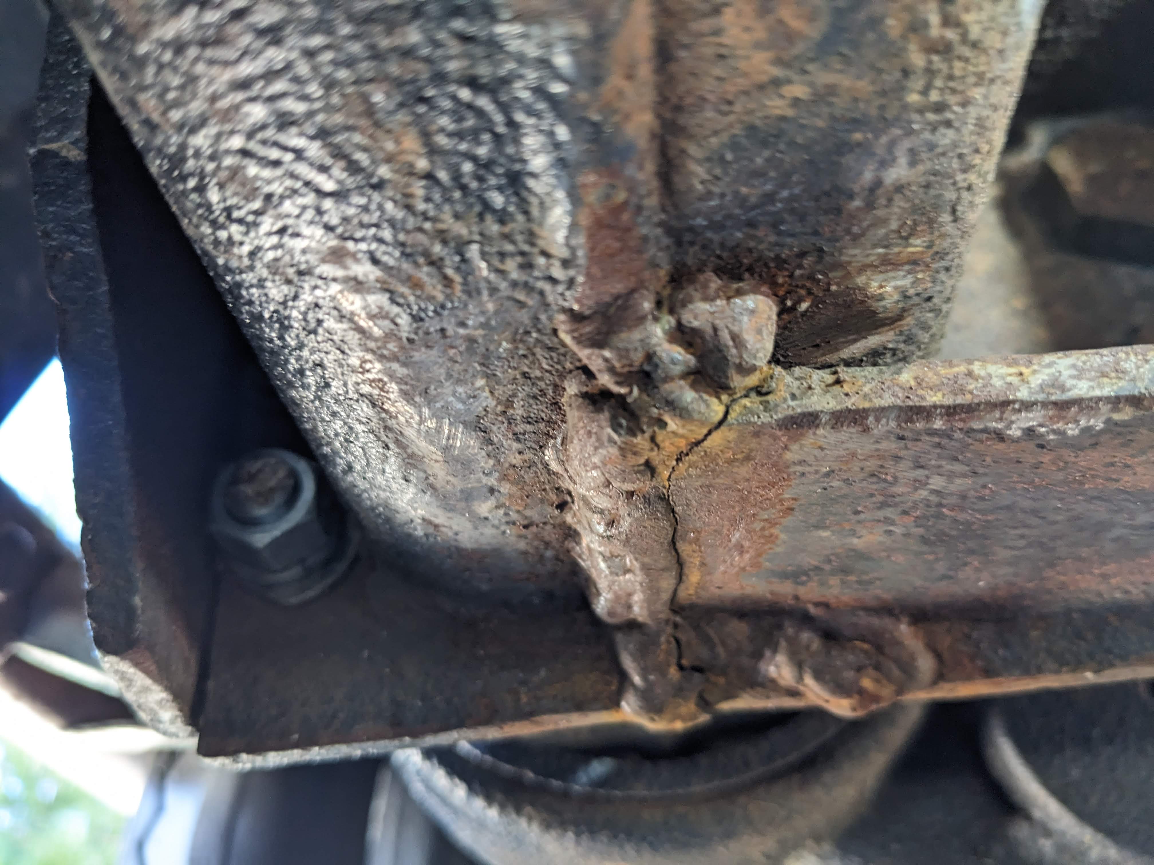

1. See the photo. What is to prevent the track tension from loosening while driving? Is there supposed to be a jam nut or a pin in the female / male connection at the end (which do not line up due to prior damage) of the jack screw. The welds were broken on the mount when I got this thing.

Yes, either a jam nut or a pin/bolt is usually present. To get a jam nut on is going to require untracking the machine which you might want to do anyway since your tracks are on backwards. Or figure out a pin or something. You have a torsion bar front axle which is nice and J-style grousers are the best for deep & steep. Variations in snowpack conditions make a lot of difference in climbing performance.
