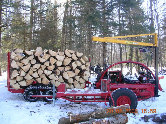

Rigged up a temporary boom on our wood splitter, until a wood clam gets finished. It worked pretty good hoisting some old dead spruce onto the table, I'm getting to old for those 42in blocks !

They must have been huge !!
I'll be looking forward to seeing the next version of the boom and clam.
What do you use to run the splitter ? Your tractor ?

Looks like it has an engine on the spliter (Looks like the top of a Briggs Vangard engine at that) with a gas tank by the boom, pretty neat setup...
The splitter is run off my J5, I'm running a 16 gallon pump on the end of the crankshaft . I didn't intend to use it for this but it works good, you can see the hydraulic lines hanging off the boom and running under the splitter.

Looks like quite the operation! Did you build it from scratch?
Fogtender
Yes the splitter was made from scratch, my neighbor and I both have outdoor furnaces and we like to load them with 42 in lengths. We cobbled it up with a lot of spare parts we had and maybe spent a 1000.00 bucks in the end.
