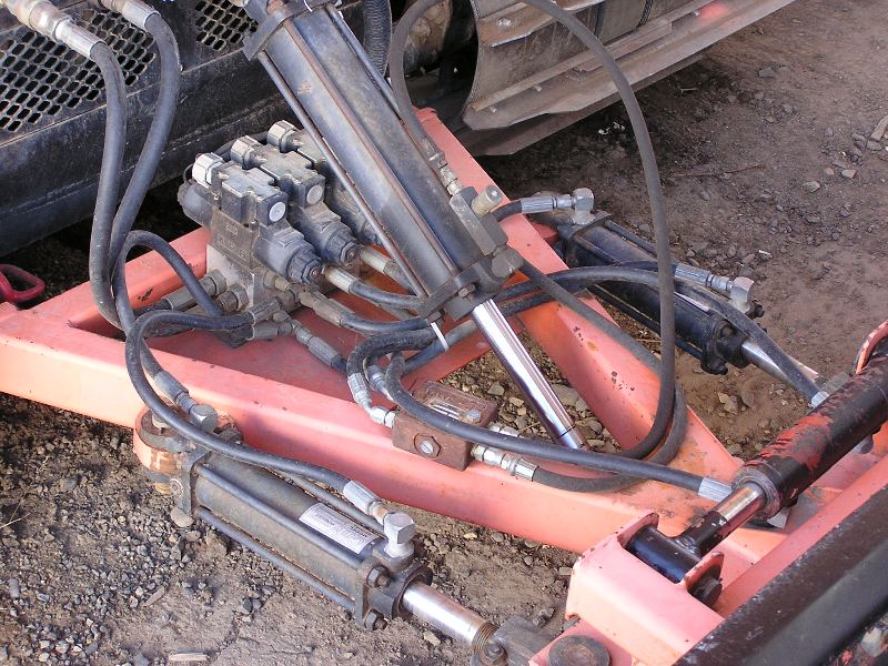

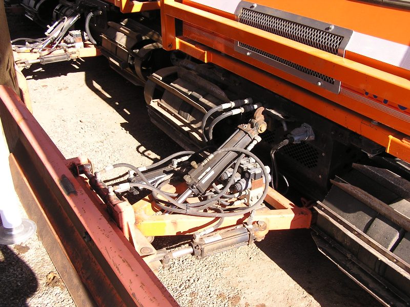

I even consider the plow on my VMC a little lighter duty than I would like to have, but by being careful it gets the job done. It is the VMC factory installed 6 way plow. It looks like it would not be to hard to convert a P/U type plow to fit on a snow cat.

Below is a video link of my VMC plowing very wet and heavy snow. It was rolling out big chunks to the LH side the size of a sofa. You will find yourself needing to move snow and an ATV blade will just not cut it. This is not the best video but it will give you basic idea of what paulhenry is talking about even though I was plowing out cabin roads in the neighborhood.
