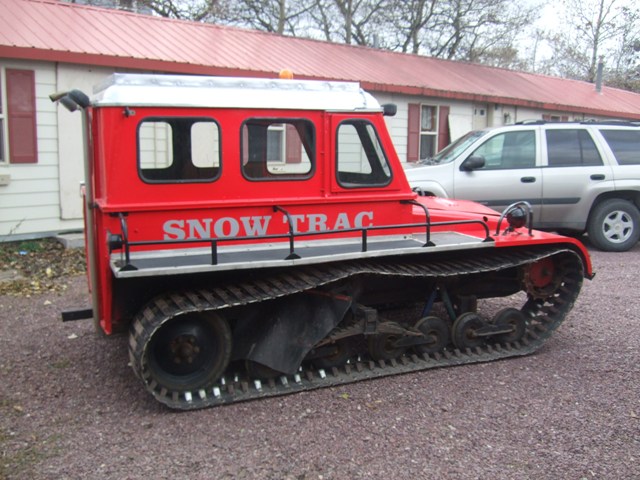

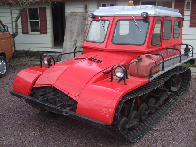

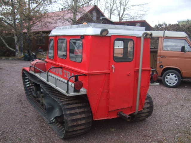

Here are a few photos of my ST4...don't know serial # as plate has been removed. Will try to find out production year soon. Any hints from pics?

This is a fairly early machine, I'd guess pre 1965. They dropped the full sliding sunroof fairly early on, and added extra windows in the rear. I believe the extra windows come in in 67 or 68. The Grousers are the "Old-Style", before they came out with the Cast A-Symettrical ones, so it's definately Pre-Transitional year(66). Around the same time they went to taller windshields and changed the tunnel/shifter mount. This machines original engine would have been the 1192 CC , 116 Industrial. What's inside the engine compartment? If the original air cleaner is on it: Modified BUS Oil bath will mean it's pre 63, Flat/Silver Non Oil Bath air cleaner will make it after late 62.
Does the brass plate below and to the left of the handel on the dash give the shift pattern? The Exhaust arraingement, and rear lights look vaguely fimiliar.

Yes, the shift pattern is on the brass plate. I'll take engine photos tommorrow and look for a production # on the motor.
I had the shift pattern plates made in roughly 96. They were for: The first annual ST4 Owners Meet, held at Stampeed Pass Washington. I had some additional ones made that were not for the meet and gave them away. Somewhere along the line I must have given the previous owner that plate. But I don't remember the Green interior?

nice looking rig tracks look a little suggest tightening them up befor they start eating away at the sprokets
They didn't have those 6 lug wheels in the rear in 63, so it has to be later than that.
I have a 1964 with 5 lugs......I also have two parts cats that were purchased new by their original owner in 1966. One is #768 and has 6 lugs and the other one is missing its plate but has 5 lugs.....the original owner sold them to me last year and assured me they purchased them together new from the dealer. I dont know if 1966 is the transitional year for the 5 to 6 lug or if the dealer sold them a "new" 1965 and a 1966??
Pre- 64 machines had 5 lug wheels that were aluminum alloy in the center and had a steel outer rim riveted on. Snow and Ice would get behind the wheel and ocassionally break the entire center of the wheel out. So they came out with an all steel wheel, in 5 lug. That wheel developed fractures and cracks at the bolt holes and was replaced with the 6 lug which had massive washers to strengthen the area around the holes. The 6 Lug hub will go right on to the 5 lug spindle. I came across a 64 that had one of each, a 6 lug on one side, and a 5 lug on the other. It had previously belonged to NorthWest Tell out of White Horse, Yukon Territory. I also met other owners that had upgraded from the 5 lug to the 6 lug. I've never seen a Trac Master that had 5 lug, so by the time they started producing them the manufacture had abandon the 5 lug. When I bought-out Northwest Tell of our their spare parts I was delighted to find both a brand new, unused spare 5 lug rims in All steel as well as the earlier Aluminum/Steel riveted one so that I had a genuine correct alloy spare for the one machine that I was keeping "All Original". I did cheat and up grade the little 1192 CC ("1200") 35 Hp industrial 116 motor, and put a "Big-Bore" kit on it upping it to 1400+CC, and upgraded the carb to a 30 PICT from the original 28 PIC. But even a pretty "In-The-Know" VW Guy, or more importantly a JUDGE at VW meets wasn't able to catch that!....." Have Snow-Cat,.. Will Travel "

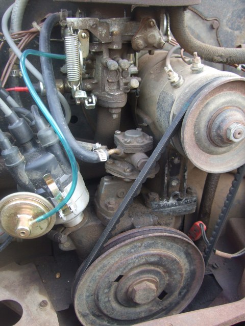

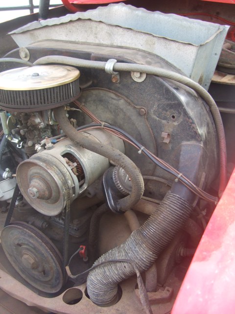

here are the engine photos....feedback greatly appeciated. Hole near exhaust manifold are present as list encourages. Look like 6vt has been converted to 12 volt and electonic rotor has replaced points. Inline fuel filter temporarily removed as fuel line was cracked. Will do compression test in a few days to see how we're sitting block wise.

Compression test confims need for major overhaul. Forums advice says the 40 hp 1200cc engine is a "poor candidate for overhaul" ie (P.O.S.).
Would like to upgrade to 1600cc engine.
Anyone have experience wih purchasing turnkey VW 1600's. There are several remanufacters/builders. GEX for example--another one, bostonbob, gets high marks on the type2 vw list.
Also they make an industrial 1600??? Is this the route to go or should I just stick to the beetle 1600 longblock??
Any thoughts or advice is greatly appreciated.

If you go with a 1600cc as a replacement, then you're probably okay with the old style upright oil cooler inside the shroud, but you'll need to specify that with the builder. This option won't require you to do any sheet metal work to modify the intake air horn. If you're thinking of a build approaching 2 liters, then you'll either want to go with the newer "doghouse" style oil cooler which will you require you to fab a new intake horn as the oil cooler sticks out to the rear of the shroud, or consider an external full-flow oil cooler.

When I got my first ST4, "Old Red", a pristene '63, the air induction horn was missing but I could make out from the service manual what it did and roughly the shape it should be. I made a cardboard model, and modified it several times until I had a workable model. I had a friend make one out of metal at an HVAC tin shop. Later, I came across a good used one and was suprised how close to the original our makeshift one was. It's on your machine now! There's a picture of the guy that made it, and his wife in another thread here in the forum.

So that's why your snow trac has the dash plaque, that Air Induction Horn, the Exhaust up the back as well as a new brake drum and a new spindle. It also has the read door off a Trac Master that I parted out.
