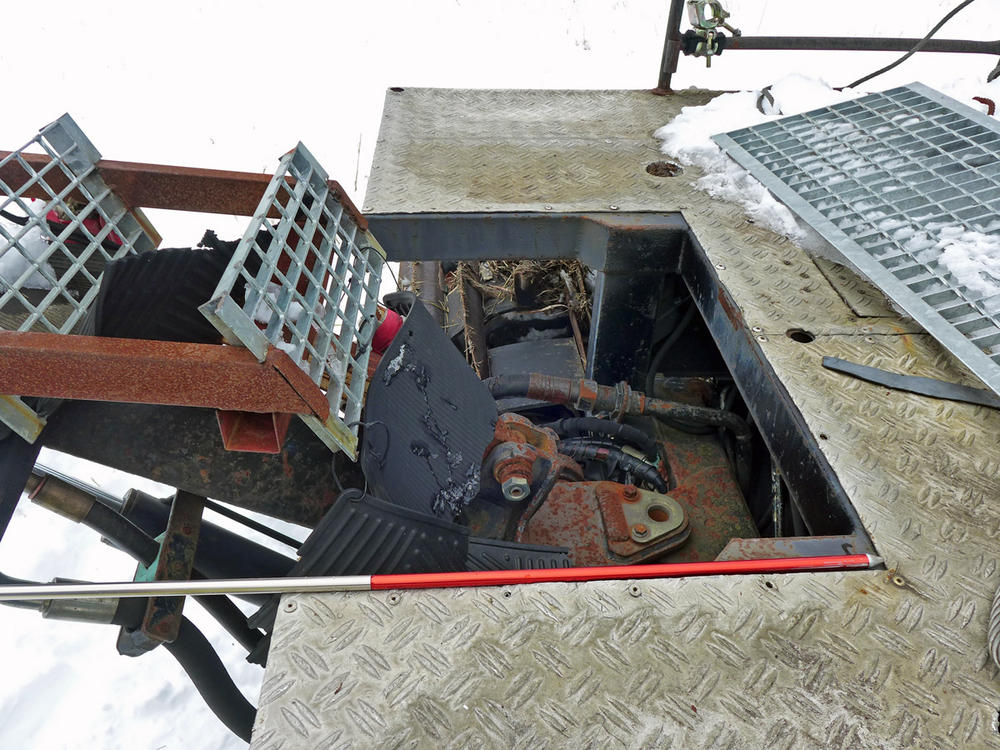

This is how it looked when I was given charge of the cat.
attachment.php
As you can see it's a bit of a mess. In a previous life, someone hacked off the upper cylinder and some of the mounts and badly welded on a set of stairs.
Over the 2 years I've been in charge of the beast, I've lost the stairs (purposely) and the tail has become a pain in the proverbial ar5e.
I have to lower it to tilt the box. The raise it so it doesn't drag in the snow. But most of all hope anyone else driving the cat doesn't play with it. Three times so far I've had to fix the passenger cabin after someone has smashed the tail through it.

I would like to remove the tail and run the ski/snowboard holder all the way across.

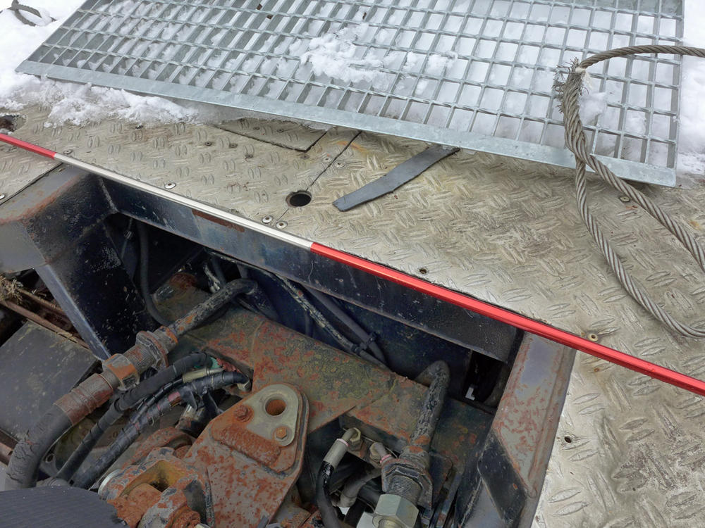

Here is the closeup of offending item

Apart form disconnecting and blanking or looping the hydraulics how do I remove the tail?
Is it as easy as removing the triangular plate with two bot's and then removing something under that?
Thanks in advance Tom

You are going to need caps for the hydraulic connections, most likely only available from Pisten Bully or possibly a European hydraulic supplier. You could also cut the hoses close to the "nuts" that attaches to the cat side and weld it closed.
Other than that it is a simple matter of unbolting the pin retainers and removing the pins. If you remove the triangle portion then you will most likely have to remove the cylinders that angle the whole thing left and right. Most one I've seen just remove the lift cylinder and lift arm.
